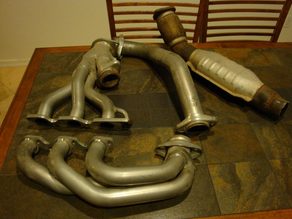

Only real new purchase lately was a set of TOG extreme headers. I was originally told they were TOG big dogs, but found out they were extremes when I got them. I'm still unsure if I'm going to keep them or not. I've already got the DPP headers polished up, header wrapped, and installed- but these are ceramic coated, have larger primaries, and much thicker flanges. If nothing else, I'll definitely clean them up to new this weekend. Still not sure what to do with EGR if I do keep them. I cut the excess flange off, and welded the tube closed on my DPPs. Not sure if I want to hassle with all that again. Came with a highflow cat that I'll need to cut off and sell since I've got a frozenboost "allflow" cat. Anyways, here they are:

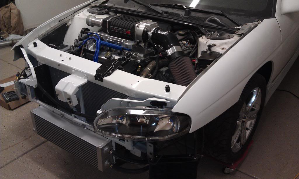

Here is one of the last pictures I took before stopping work for the summer, I was test fitting the intake tract:

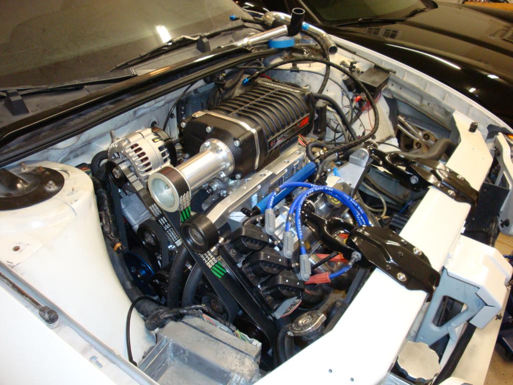

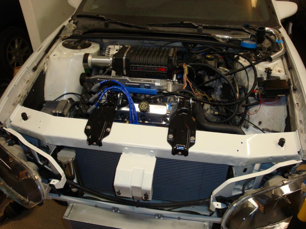

How she sits now:
The alternator is now fully mounted, both belts are installed and ready to go. The IC system is installed and filled, as is the engine cooling system. The gas tank is permanently installed, and a cover is finished for the hole in the trunk floor.
