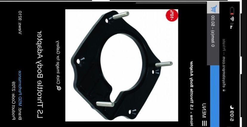

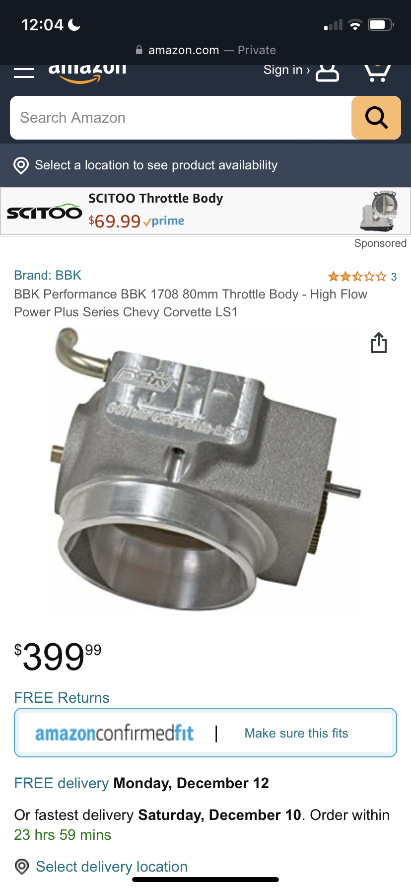

I thought these looked kinda close to where I could just cut this off but now that I look at it the hole might be really small compared to the 80mm

do you have a link to the ones I can get

LX5 TB swap kit (65mm):
https://www.wot-tech.com/lx5-throttle-body-package.html
Keep in mind that you'll likely either need to open the inlet port on the UIM or swap to a 3500 intake setup (which has its own complications) at the same time to avoid creating a step.
If engine swapping is on the table, I'd absolutely go for that instead. Youll get much better bang for the buck out of even a stock L67 swap - plus much easier modding going forward.
A good point of reference is the LX9 engine (early 3500 - pre vvt) as they are very similar to the 3400 you have. They also had a 65mm TB like you're considering upgrading to, but also have more displacement, better flowing heads, a better LIM, and supposedly much better UIM - and still only make 200 +/- crank hp. As you can imagine, just upgrading to one of those improvements isn't going to have a major impact on hp - likely only single digits at the crank.
