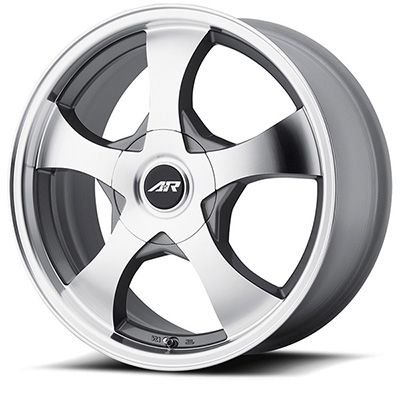

thanks for your reply and the recommendation I agree going up to 17" would be nice but since I just bought the tires unless I could sell these I wouldn't change the size. I did find some nice 5 spoke American Racing rims on Carid and direct from American Racing. I was hoping someone had a specific brand that they had currently or previously. The last time I bought rims for a Z-24 Cavalier they were so offset they made the tires rub on the wheel wells and damaged the tread. I am wondering what the stock offset is for my monte? I was also looking at the newer Malibu rims and wondering if they would fit. Anyone put newer impala or Malibu rims on a Monte?

I have always wanted these but they only offer them up to 16"
