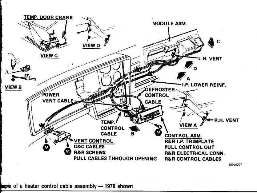

problem #2. just replaced the blower motor for the heating and air. when i turn on the fan it works just fine. air blows through the vents when it is on the 3 air conditioning settings, when i go to vent or heat, it does not blow through the vents on the dash. when i turn to defrost it blows through the vents that go to the windshield. why does it not blow through the regular vents when on vent or heat????

Problem #2 sounds like you may have a connector and/or control cable not hooked up properly at the control head. Do you hear vents moving when you shift between defrost and heat or air? My manual is not very specific but below is the graphic they gave as an example. Maybe it will give you some sort of visual as to what is in there.
