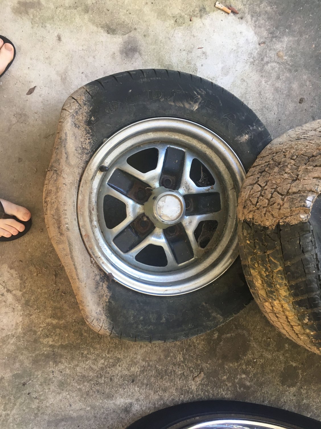

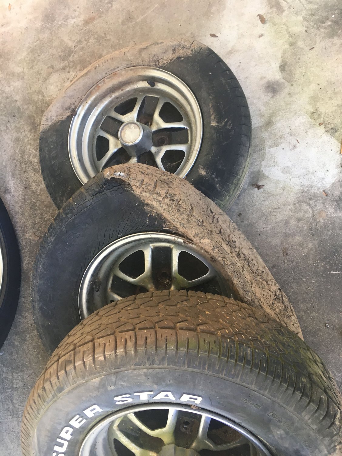

Old Jun 25, 2018 | 08:19 PM
Armymonte's Avatar
Joined: Jun 2018
Posts: 3
These are the rims when he got them before the new tire
