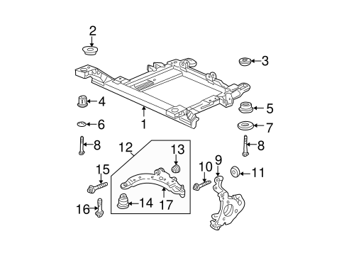

I was in a car accident where a woman ran a red light, struck my driver side and pushed my car into a curb. When the car hit the curb, the engine cradle took the brunt of the impact and was seriously deformed on the driver side front. After getting the car back from the shop I have a very prominent, pulsating hum on left hand maneuvers at any speed, and some pops in right hand and it tracks to the left.
I think that the damage to the engine cradle affected the mount for the driver front control arm and has thrown that wheel assembly for a loop. My only other suspicion is in the quality of the used parts the shop put on my car to "get it running".
So here are the questions.
Based on the description Do you believe that my suspension noise in my driver front wheel well is the result of the damaged cradle or something else?
If it is the engine cradle, I want to replace it without taking the engine and trans out. The engine weight will be supported by a crane from above and the wishbone mounts on the upper front of the engine to the body, and I'll drop the cradle from below. What do you think about that method? Easiest way to do it, or is there a better way?

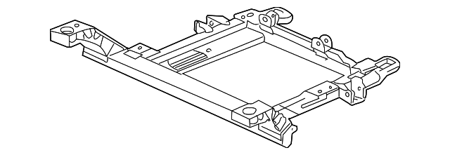

Jul 8, 2005 - Sub Frame Welds Impala | Impala SS Car Forums. ... I was told today bychevy service the problem is defective / missing sub ... Thats correct, the impala has an aluminum engine cradle. ... sub frame welds, a common problem on Monte Carlos and Impala's. ..... I have a 2004 Impala that we purchased new.
www.gmpartsnortheast.com › 2004 CHEVROLET MONTE CARLO
ENGINE CRADLE for 2004 Chevrolet Monte Carlo SS 3.8L V6 - Gas | Part #25912831. ... This part fits your 2004 Chevrolet Monte Carlo Change vehicle ...
www.conceptcarz.com › Coupes › Manufacturers › Chevrolet
The Chevrolet Monte Carlo (2004); Also known as: LS, SS, Supercharged SS, 3400, 3800. ... In addition, powder-metal connecting rods replace cast-iron rods for ... A unique extruded aluminum engine cradle helps isolate engine noise and ...
