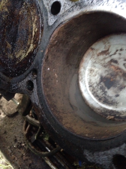

I got one of the heads off today, and obviously this car has not been run in quite some time! this is what the middle cylinder looked like.

I cleaned the cylinder wall up with some WD-40 and a cheapie scratch pad, I'm gonna try and see how some military CLP and a good scotch brite pad does, I think it will clean and shine up adequately.
