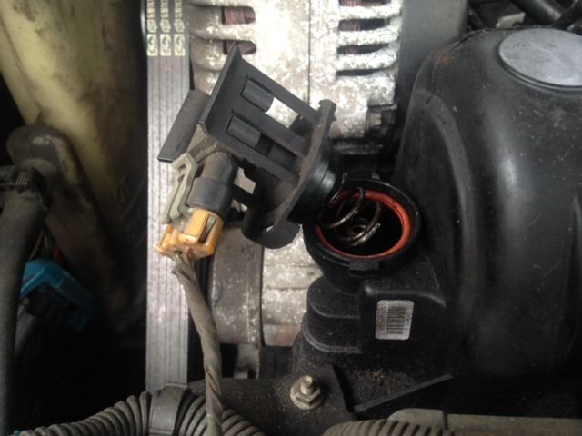

Engine compartment pics, as you can see intake in shreds and fuel line broken and burned

Here are the problems I have with engine
here is where the fuel line enters fuel rail, the line and connector shown are burned, please forgive my ignorance of nomenclature:-(
My best initial fix?
Here is a pic of my shattered intake, is there a metallic one ( aluminum or steel ) to replace this?

Looks like whoever started the car last had the misfortune of a backfire due to a faulty FPR??? That would explain the burnt line you describe..

Even though it looks that bad from the upper intake that blown off you be happy that repairing the burned wires and fuel line shouldn't be to difficult. As wht02monte stated the Fuel pressure regulator was probably the culprit. The burnt wires and vacuum lines can be found at a local parts yard and are very plentiful as the 3800 was used in so many cars. You can be up and running in a day or two. And don't worry about being a Mark Martin fan I thought he was one of the classiest drivers the racing sport ever had.

What is this black box and why would it be McGyvered into the wiring here in drivers side of intake, Tow truck driver who delivered car suggested that somebody might have tried to Nitro it?

here is pressure regulator on passenger side of intake that has a broken mount that I assume was a cause or result of previous posters suggestion of an FPS failure backfire
