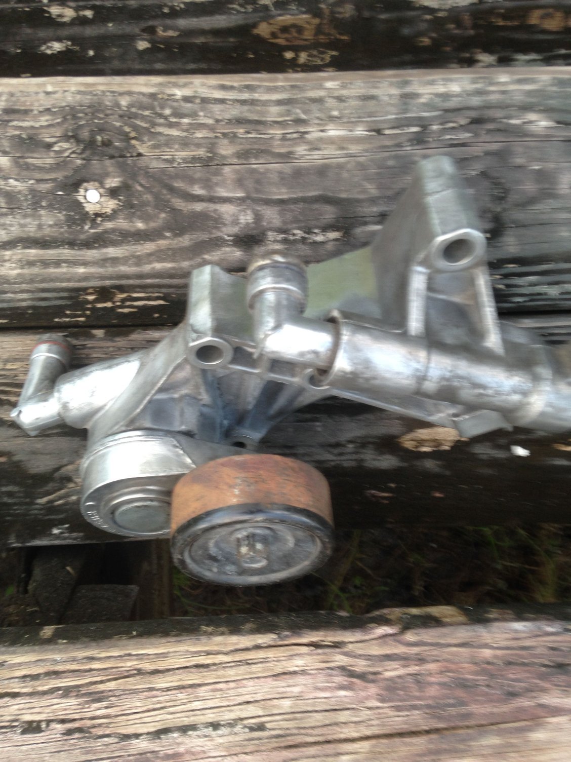

I got thinking about it, and thought "you know what that could look pretty good", so I took a couple pieces of aluminum used on the engine, a motor mount piece, and the belt tensioner, and commenced to shine them up using nylon and brass wire wheels. Two hours later, they cleaned up pretty nice but didn't have "The Shine" I was looking for, so I broke out the steel wire wheels. I previously hadn't used them because I thought they might be too harsh, well much to my delight, they worked very nicely, and got me "The Shine" I was looking for. I ran out of battery power so its not complete but I did take some preliminary pictures.
The question now is: How do I keep it looking shiny? I'm sure the gray I'm cleaning off is an anti corrosive of some sort, so I'm going to need a high temp clear coat of some type, any ideas?
Top photo : Partially brushed motor mount,
Mid photo : Partially brushed tensioner
Bottom Photo : Motor Mount, and Old Fuel regulator ( alleged initial problem ) before photo, Also my boat shoe lol, All that white is all corrosion, I didn't take a before pic of the tensioner but it looked almost as white!

Old Apr 3, 2019 | 09:09 PM
  #56
Posts: 6,479
To start, I've never tried to seal aluminum as rough as what you've got, the stuff I've done has all been mirror polished.
There are 2 ways that I know of - sealer and clear coat. For clear, they sell clear specific for direct on metal (Eastwood sells some, I'm sure they carry some at local paint shops too). I've never liked this stuff as I've always had adhesion issues. The reason I mentioned that first sentence is because yours is so much rougher, it may have enough bite to hold a clear coat, I just haven't had any luck.
The other option is a sealer. Zoop seal used to be the big one, but they're closed. Plenty of metal sealer polishes out there that do the same thing. I will say, there are 2 things about a sealer - for mirror polish surfaces, it seems to dull it up a touch from a fresh polish look. On yours, you probably wouldn't be able to tell though. The other thing is that aluminum forms an oxide skin quickly- you want to clean that off right before you seal it to lock in that finish on actual bare aluminum.

Thanks Bump, I'm not at this time looking for a "mirror polish" , I dont really have the financial means, and I want to keep the original parts and just shine them up, and keep the shine, I appreciate your suggestions! Thank You

I have a variety of wire wheels (steel and brass), dremel sanding drums and grinding bits, pads for the drill and dremel that are like scotchbrite, that I went nuts with to get a look I was happy with. Can be quite the journey! And anything for the dremel, go to these guys, it's usually DIRT cheap:
https://widgetsupply.com/
As for keeping it that way, I used high temp clear coat. Since I did not go for mirror finish, the metal was still had pours and such (and I did not know anything better) and it all worked pretty well. My valve covers were done by the previous owner, but I did the upper intake, throttle body, thermostat housing and a couple other things. The ONLY issue I have is the upper intake, a small section the clear yellowed. But over all, not a big big deal.
Keep up the work!! I am sure that once you get to where you are happy, it will look GREAT!!!
