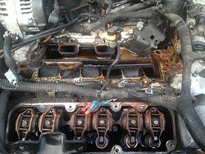

Question Update, Teardown begun
Ok was easy enough removing the fuel rail, and the busted up intake, everything kinda dirty, one injector burned so have to replace that one, most of the wiring appears intact so I dont think that will be much problem. haven't removed the "Dumb Box" yet but will.
My dilemma : I can't get the engine to turn over, New battery, got someone to turn the key while I watch, the starter engages, I can see the belt and pulleys jerk, but thats it. I'm not ruling out the starter, nor am I ruling out an internal problem. It doesn't "sound" like the pistons are hitting a valve. I removed the front valve cover and didn't see anything "hinky" . I can get to the Harmonic Balancer Bolt through the passenger front wheel well, but I dont have a wrench big enough to "get on it" and see if I can turn it physically. I am considering removing the belt, to take alternator water, pump, PS, and A/C out of the equation, and hit the key again. Since it uses a timing chain and not a timing belt, I am hesitant to believe that it has an internal problem from a "backfire" ! I am not familiar with the problems these engines have, and have not rebuilt an engine since I rebuilt a 340 Duster Engine to put in my old Power Wagon back in the 80's.
I'm really not inclined at the moment to do a complete rebuild, or a top end unless its necessary. Any troubleshooting hints?

Here's couple things you can try. First double check the battery ground . Try to remove the belt and see if the engine will rotate with the starter, , maybe a pulley is locked up. Since you don't have a socket for the balancer you can remove that plastic cover between the engine and trans by the starter and put a screw driver in the teeth of the flywheel and rotate the engine. If that doesn't rotate that way you probably have internal issue's. Good luck
