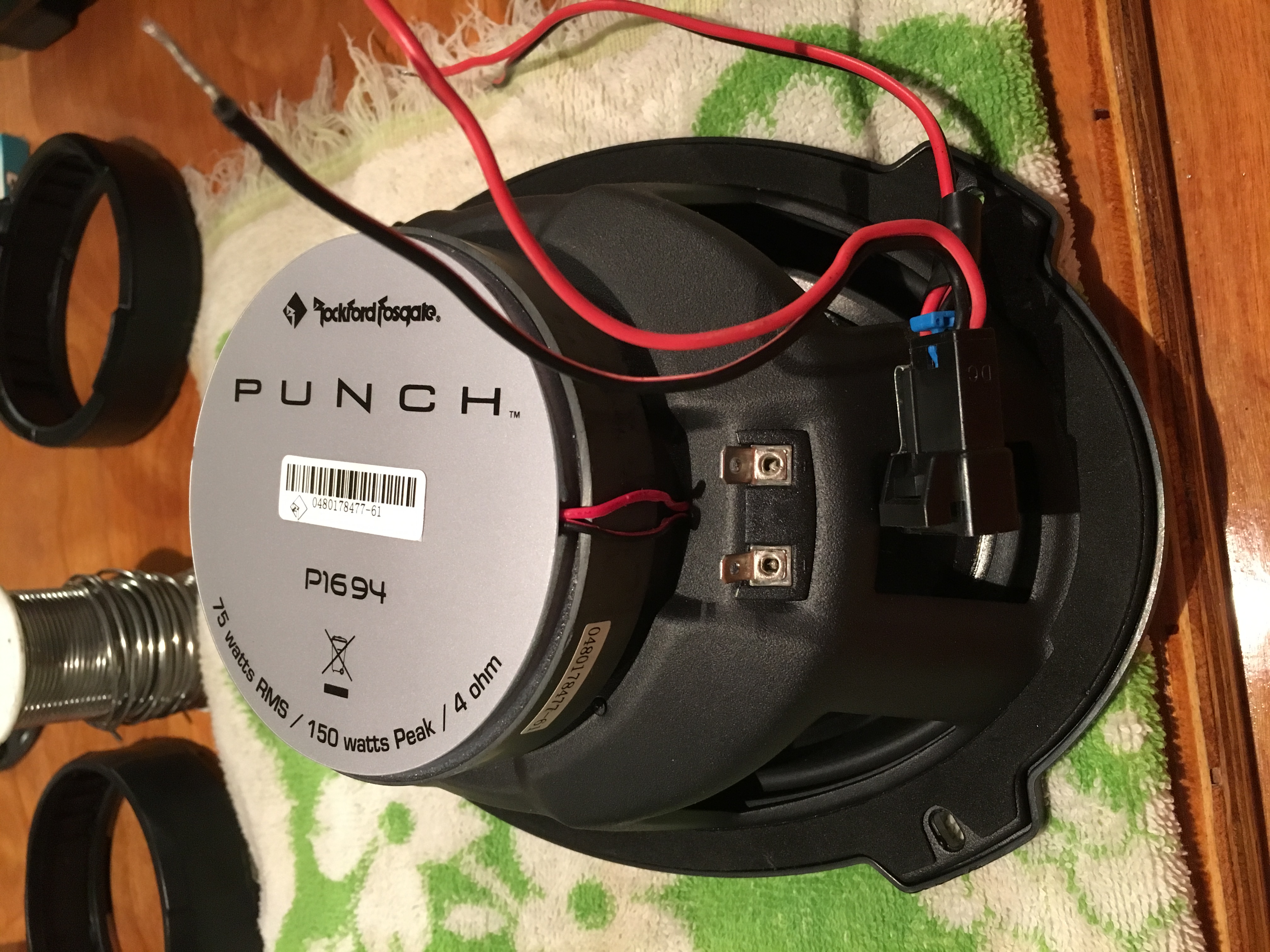

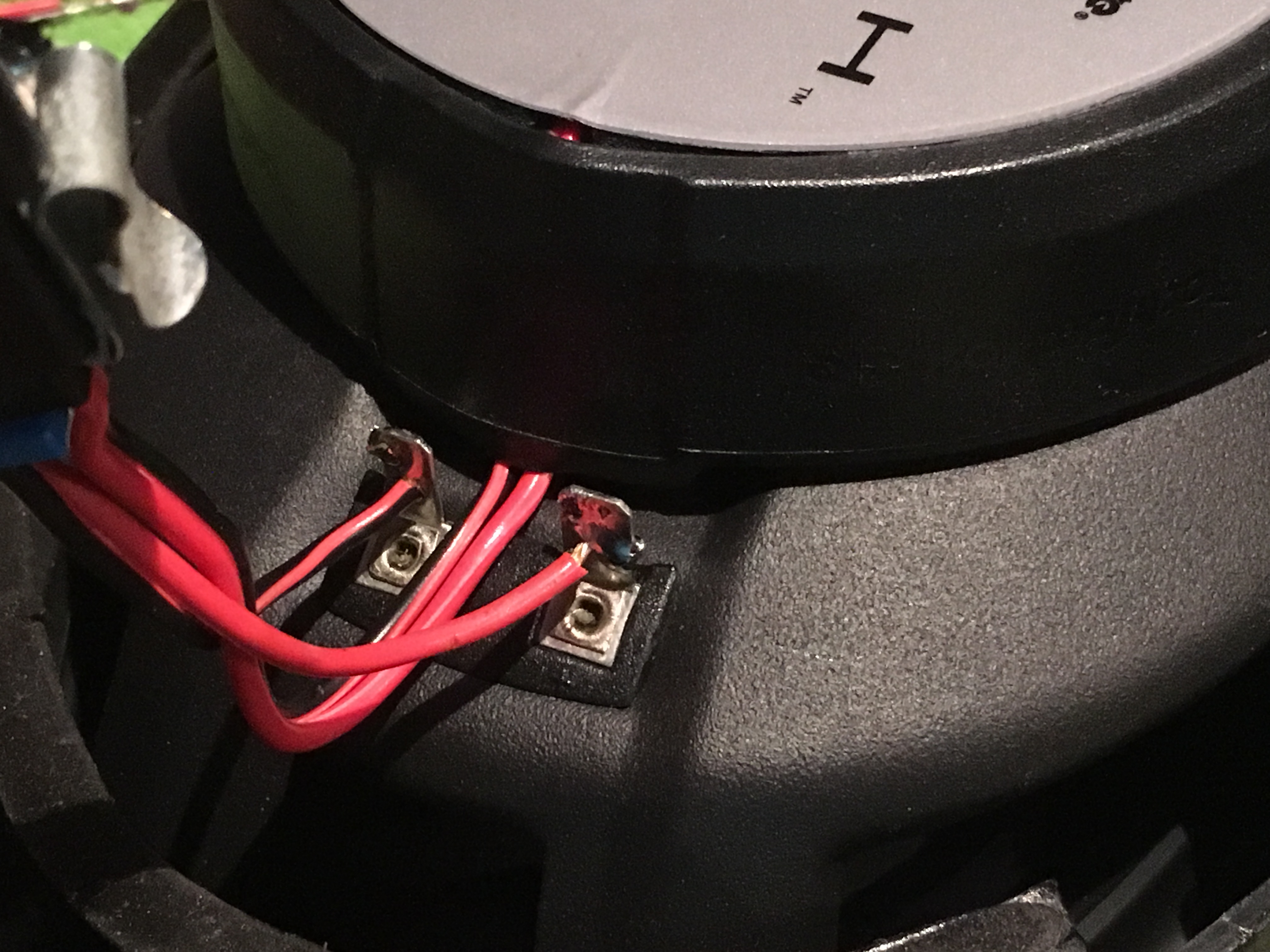

I recently replaced my rear speakers for a set of Rockford PUNCH P1694 speakers. They work pretty good. I re-wired them to break the channel for the woofer from the rest of the multi-channel features, this is done in case I want to adapt the Monsoon amp. For the moment, I made a custom adapter to go from the Monte's factory rear speaker connector to the Monsoon connector I added to the speakers (all it does is re-connects the channels I separated). The reason for all this, if I decide to go to the Monsoon amp, or do comparison testing, I don't have to take the rear seat out, all the effort is now in the trunk.

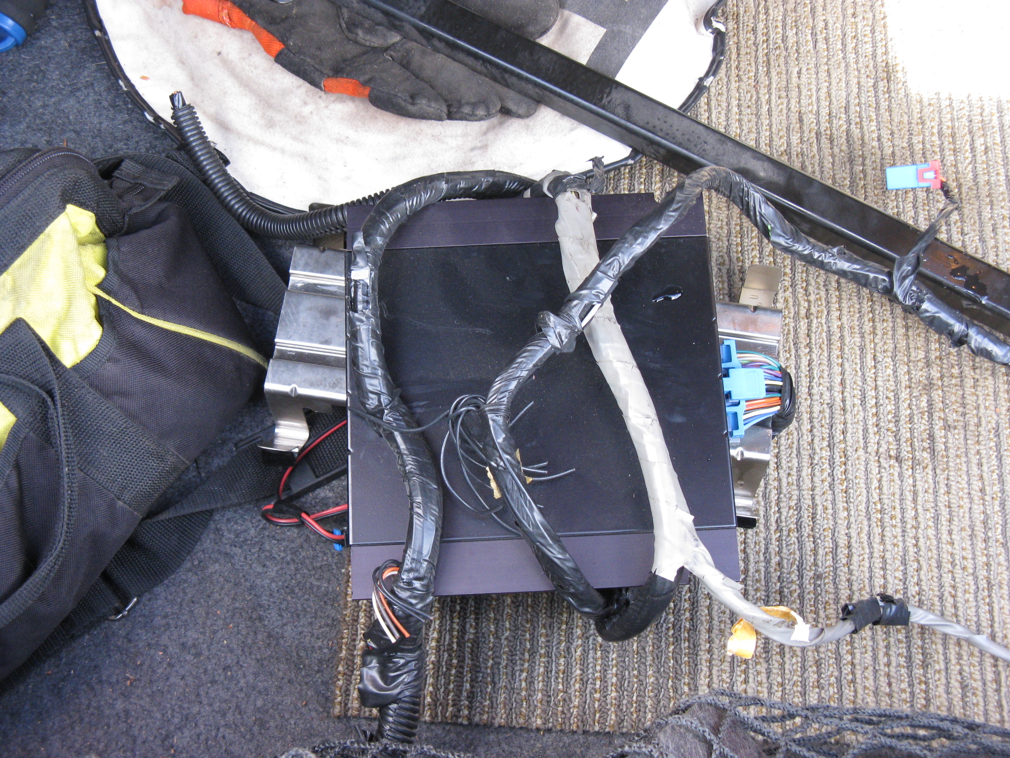

I have built a wiring harness to adapt my Monte amp to a Grand Am Monsoon amp (and as for the speakers, I would abandon the original rear speaker wires and use new ones for the Monsoon amp). Pics attached.
