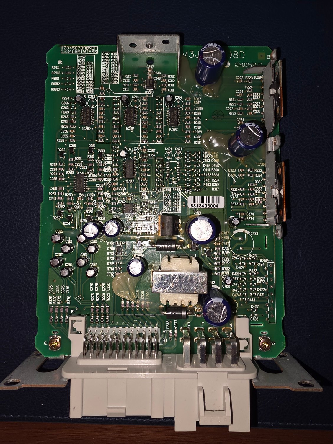

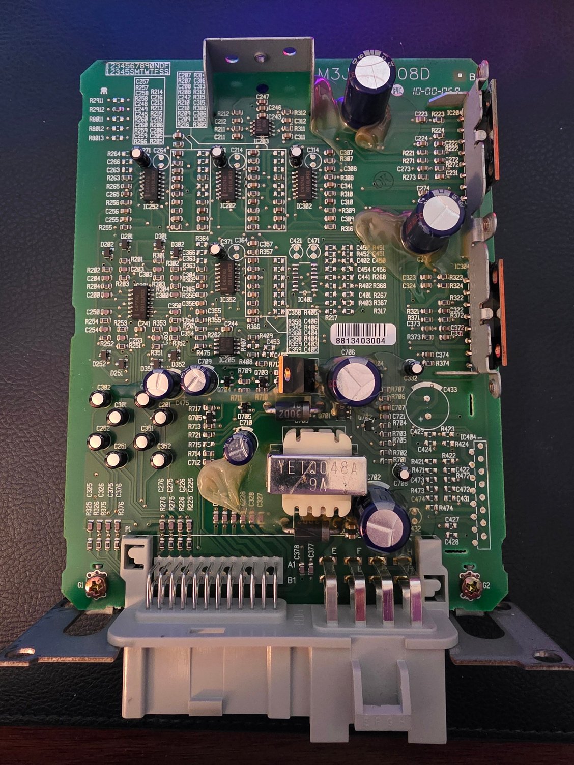

My driver side speaker died... removed it from car and it works fine on a seperate system. A few months later the passenger side died.
I still have the original amp and head unit.

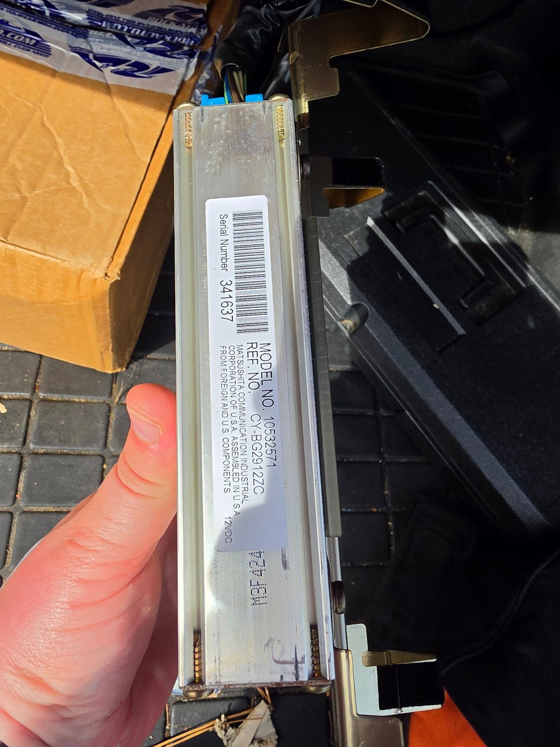

I'm noting this here because i cannot for the life of me find this online - the typical amps that seem common are 10309547 or 10432571... but i have 10532571! Confusing... I'm assuming there may just be some difference in gain or impedance?
Well I'm back at it again.... I've found the exact 10532571 on ebay and ill buy it. I'll also pop open my amp and see if maybe some caps are blown or something that I can handle fixing.
Old Apr 17, 2026 | 03:50 PM
Jason B's Avatar
Joined: May 2015
Posts: 95
From: Long Island, New York
All the caps look good... I guess I'll have to test the wiring now.
