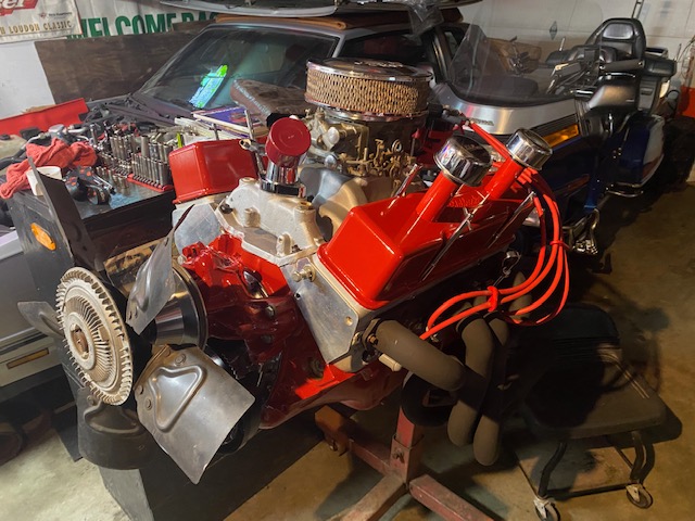

I did a similar swap on my '79 C10. I swapped the 305/TH200 for a 350/TH350 and everything fit perfectly. The TH400 is definitely going to require some fab/modding. You might try looking for a wire harness for another model vehicle, like a Camaro, with the same engine & transmission that you are putting in.
