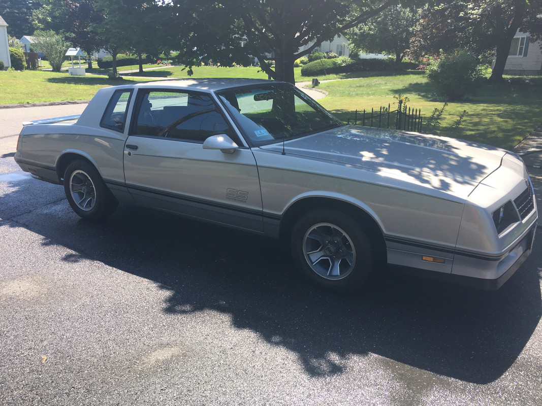

Old Dec 21, 2021 | 07:48 PM
MontesRule's Avatar
Joined: Jul 2019
Posts: 20
From: Springfield, MA.
https://postimg.cc/ct7BnSDg
