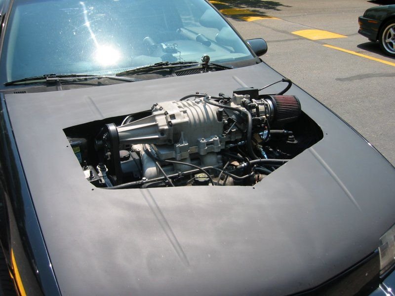

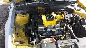

Had a chance to run down some more pics. A few are duplicates of the thread above.
Most of the GA stuff is the remote mount blower, but TBH that's not going to make a whole lot of sense to recreate unless you can find a complete kit for sale used.
