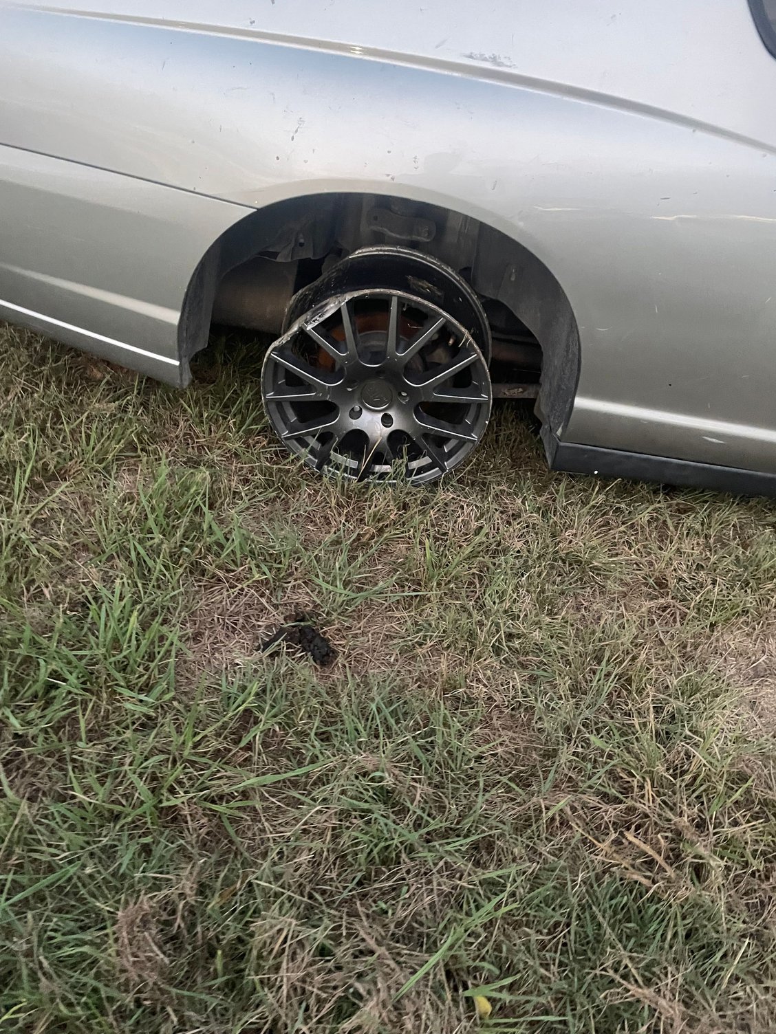

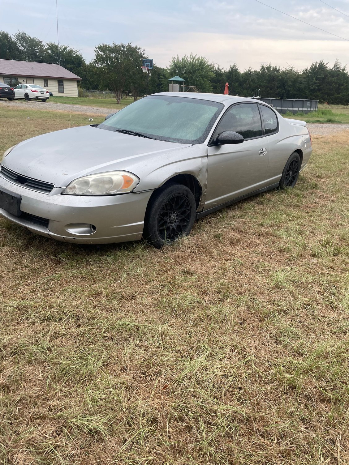

Here’s some pictures of the car now too

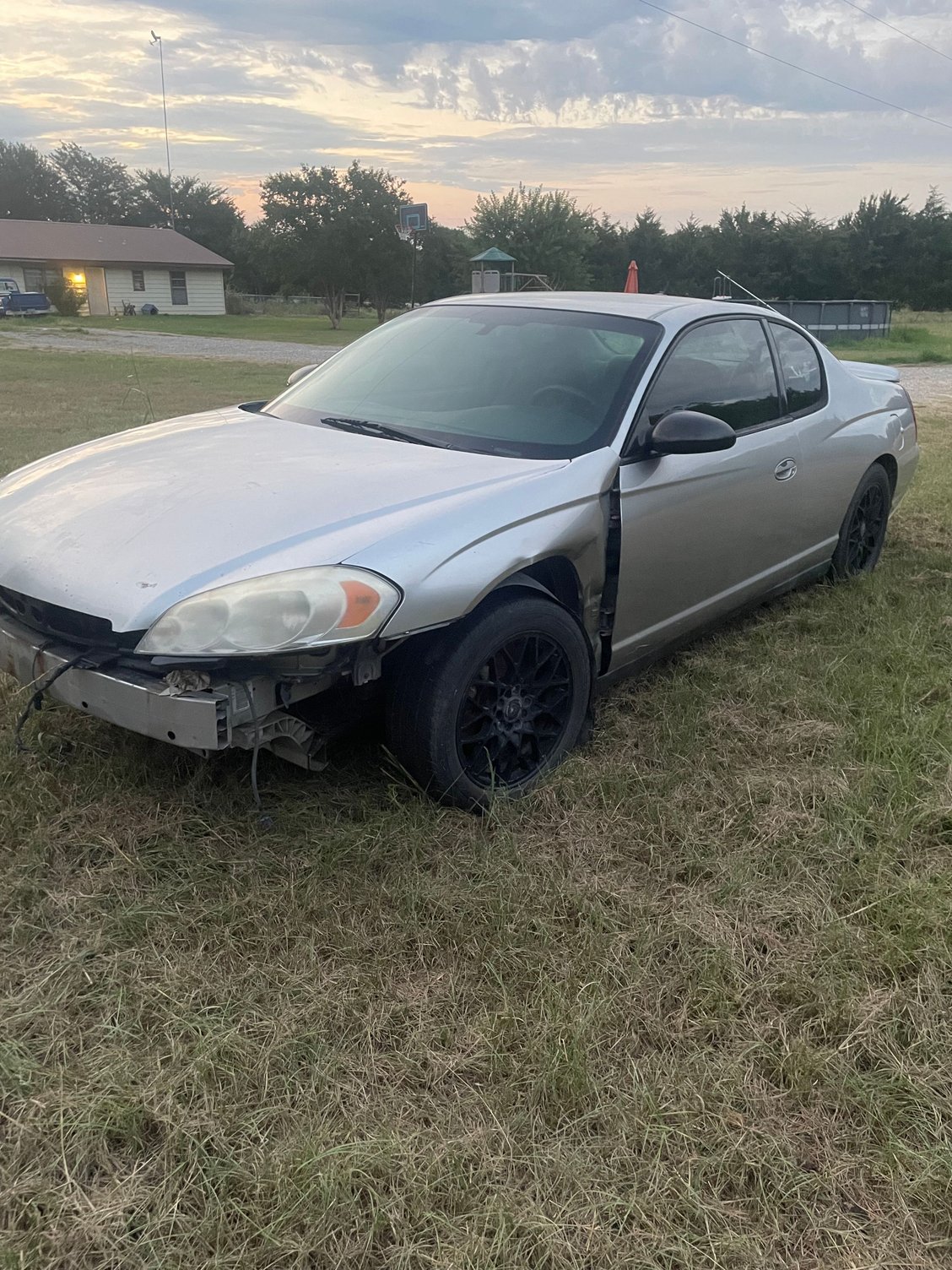

Update, put a new starter on, and I’m going to wire a button inside of the car, I pulled the starter relay because the short in the signal wire was killing the battery constantly, also fixed the messed up wiring, now everything electrical that wasn’t working before is working now, the starter still isn’t turning over the engine, it’s a good starter, but I think I might need to shim it, will update if the shimming works, and here’s a new picture of the car, on its 3rd life now
