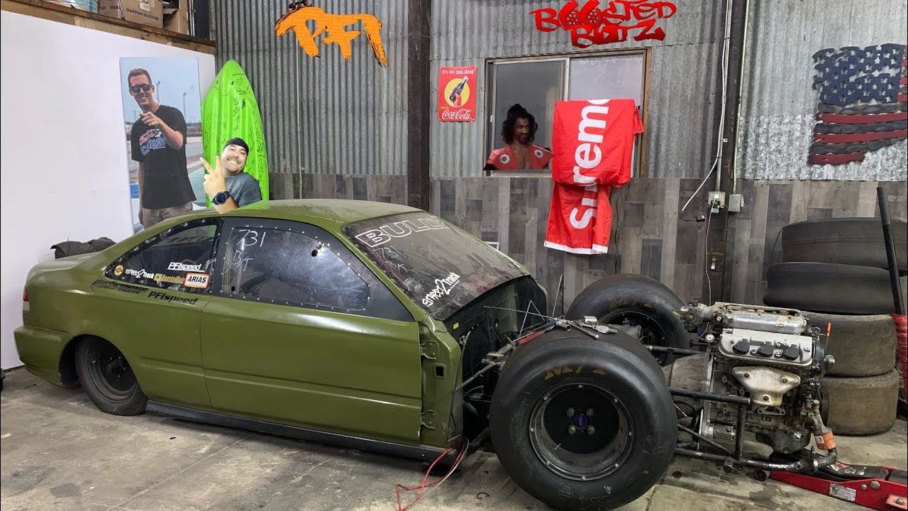

I hate to say it, but you're never keeping this FWD with a T56 regardless how good at fabrication you are. The T56 bell housing to tail is nearly 3 feet long. Keep in mind, that's transmission only - you still need a driveshaft and a rear end (unless you get a corvette style transaxle with the differential bolted right to the transmission, but that's got to be north of 40" total length).
If you leave the engine tranaverse, you're literally going to have to make the car into a 3 wheeler and do a driver's side wheel delete and even then it'll probably still be hanging a foot outside of the driver's fender. You'll have to climb out the window to change gears.
Even if you rotated the engine front to back like how a T56 would normally sit, you'd end up with a monstrosity like those pro-FWD cars to make it actually drive the front wheels (only with the engine hanging even further out there as a t56 is way longer than the 2-3 speed transmissions they usually run, plus youve got another whole bank of cylinders beyond what the car below has):
I own a T56 car, my daily driver GTO - I can tell you that thing is huge / there's no way youre cramming that under the front end of a stock body car to drive the front wheels with the engine up there too.
