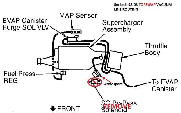

Remove the solenoid, and leave the BBV hose open IIRC

Remove the red vacuum hose and make the vacuum connection at the fuel pressure regulator an "L" (this line leads to under the sc snout I do believe) instead of a "T". Then leave the hose coming from the actual BBV to the solenoid disconnected and open.

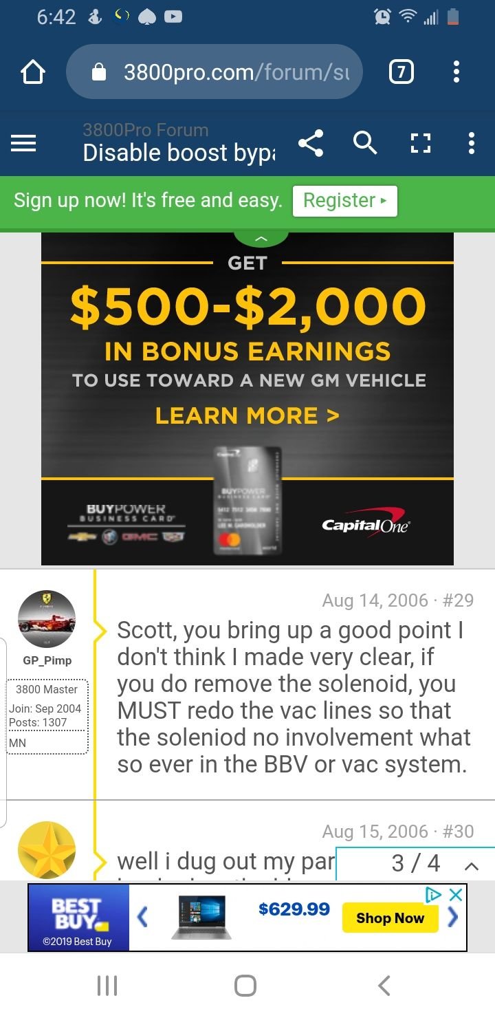

Old Dec 1, 2019 | 08:16 AM
04l67's Avatar
Joined: Jun 2018
Posts: 122
Like this found on gpforums
