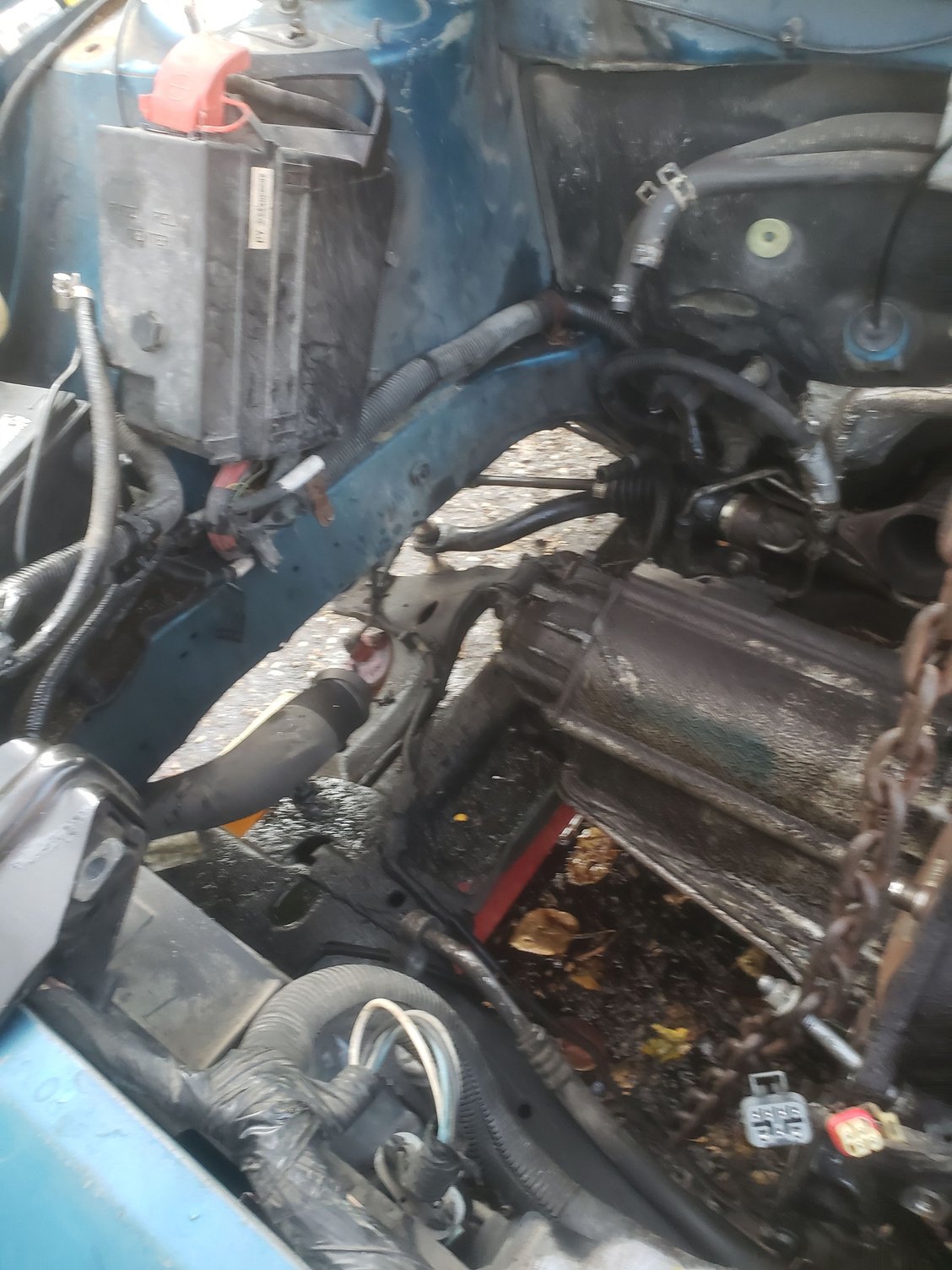

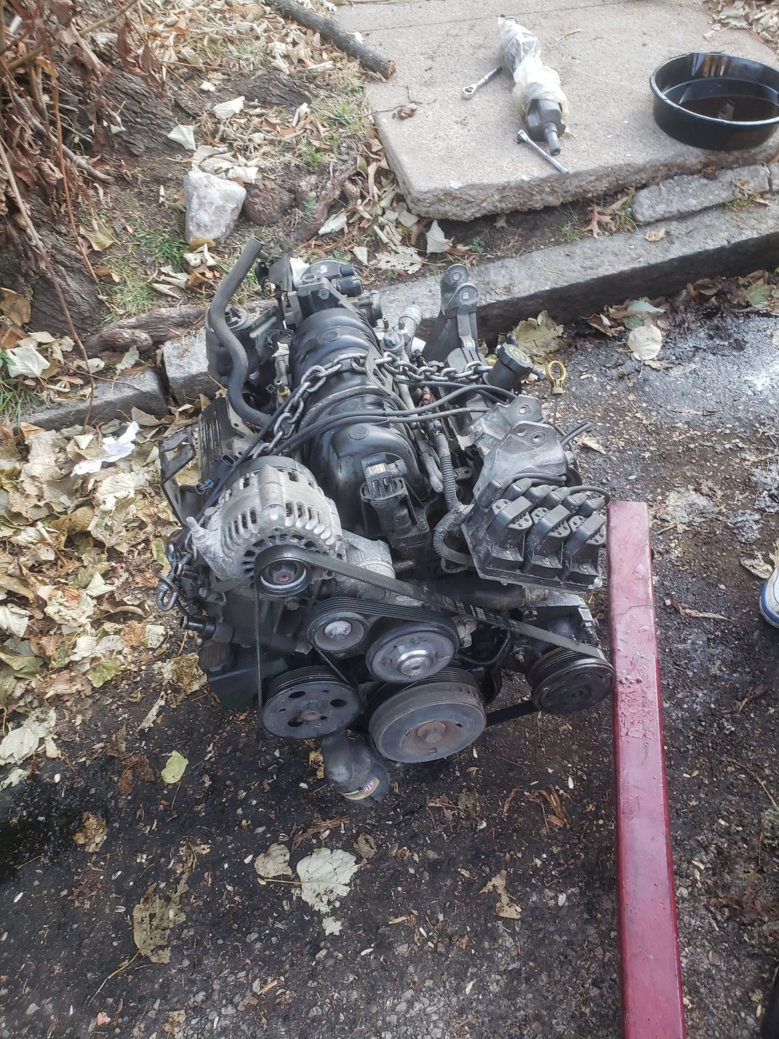

Picked up a transmission from a 99 gtp 140xxx starting the swap today going to pull the engine and swap over the pan and oil filter neck donor engine is out of a ssei Bonneville oil filter is located on the side of f the block swapping coil packs ordering the map extension and BBV wiring also going to pull off fuel line from a gtp swapping the transmission out to hopefully no issues or setbacks

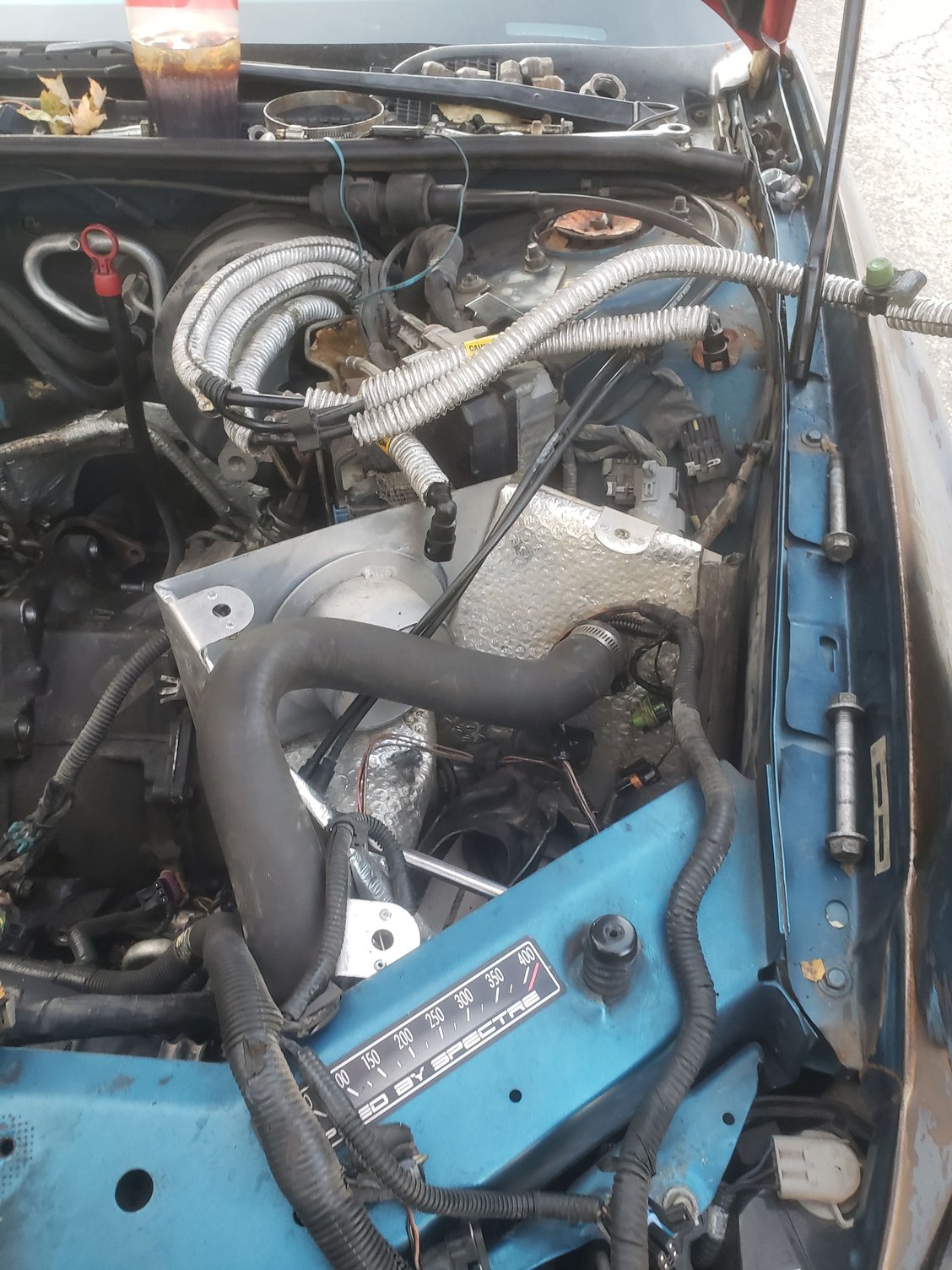

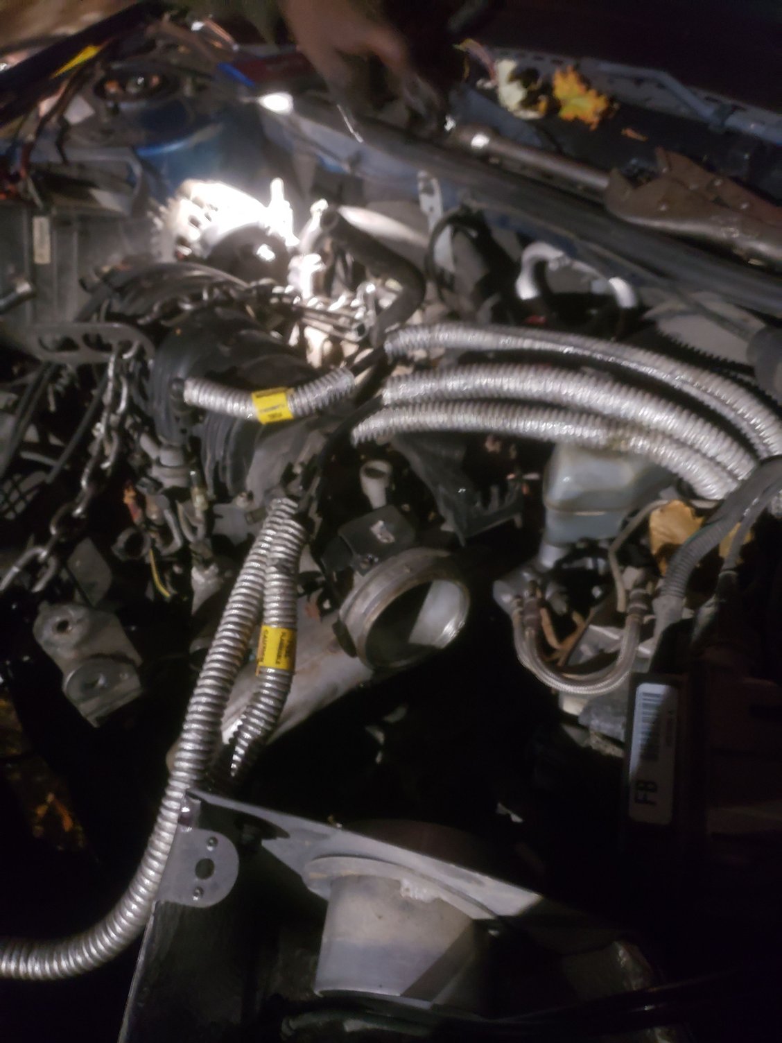

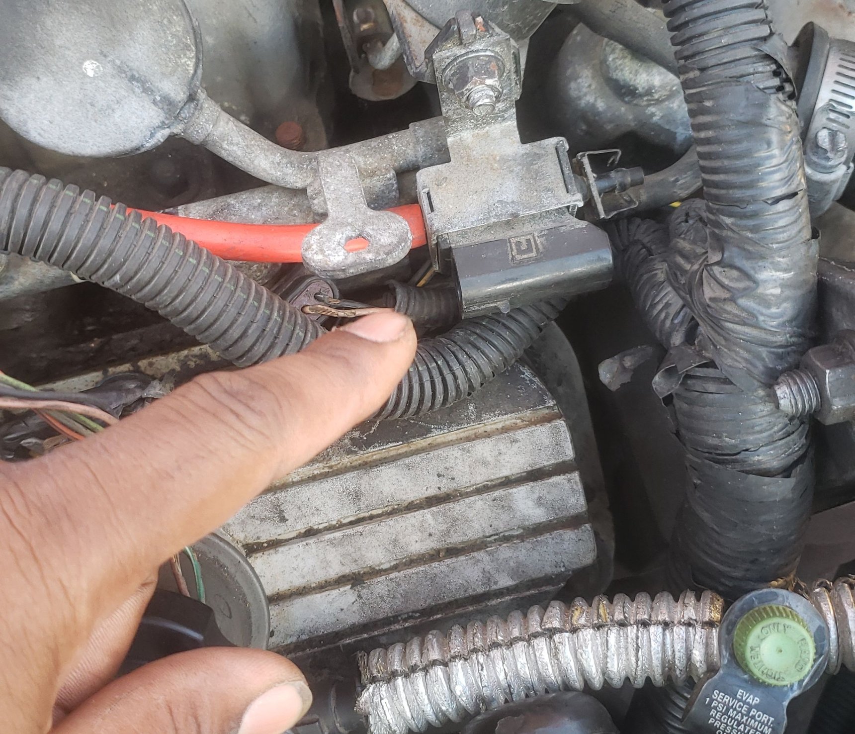

So basically got the motor and transmission in car is running just dont think supercharger is working for boost didn't order the zzp kit remapped the evap valve and map sensor to reach original wiring location wanted to kno if I can just splice the boost bypass valve connector into a power and ground
Motor in and running
Only missing the boost bypass

Old Nov 28, 2019 | 09:07 AM
Posts: 6,471
The solenoid is meant to be able to be switched on/off by the pcm if you're looking for stock functionality. If you're looking for a way to just force it on permanently, then just delete the electric solenoid altogether. The BBV still works fine with it properly removed, it's just the pcm wont have any control over it anymore which isnt a big deal.

Old Nov 28, 2019 | 11:50 AM
04l67's Avatar
Joined: Jun 2018
Posts: 122
So to delete I can just remove it and run the hose from it straight to the fuel pressure regulator t vac
