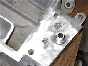

When talking water/coolant in the oil on a 3800 L36, it's normally one of the following:
- Lower Intake Gasket (normally the culprit)
- Upper Intake Gasket
- Upper Intake (where the stove pipe is for the EGR will burn a hole allowing coolant that feeds the throttle body to seep into the UIM and dump into the engine with your air flow, thus white smoke out the exhaust).
In your case you have white smoke, could be a head gasket (but that's less common). My guess, your upper intake is failed. Your fixes are:
- 1 - Replace the UIM with another plastic one (APN makes the best one)
- 2 - Replace with a L26 Series 3 aluminum upper intake (some extra work is involved, if you want to go that road, I happen to have a L26 aluminum UIM for sale, we can discuss the issue further).
- 3 - Take the UIM off, tap and plug the ports in the LIM that run coolant to the throttle body (for added security, I'd fill those ports on the UIM with JB Weld).
#3 is your CHEAPEST method. I did it to my Monte (as I just did not want to warm the incoming air), I know some one else that did it to a Grand Prix to save a couple bucks (working fine, no issues). You can buy the plugs are Home Depot or any other hardware store. In case, I also put JB Weld on the threads of the plugs.
Here's a pic of what the LIM would look like:
