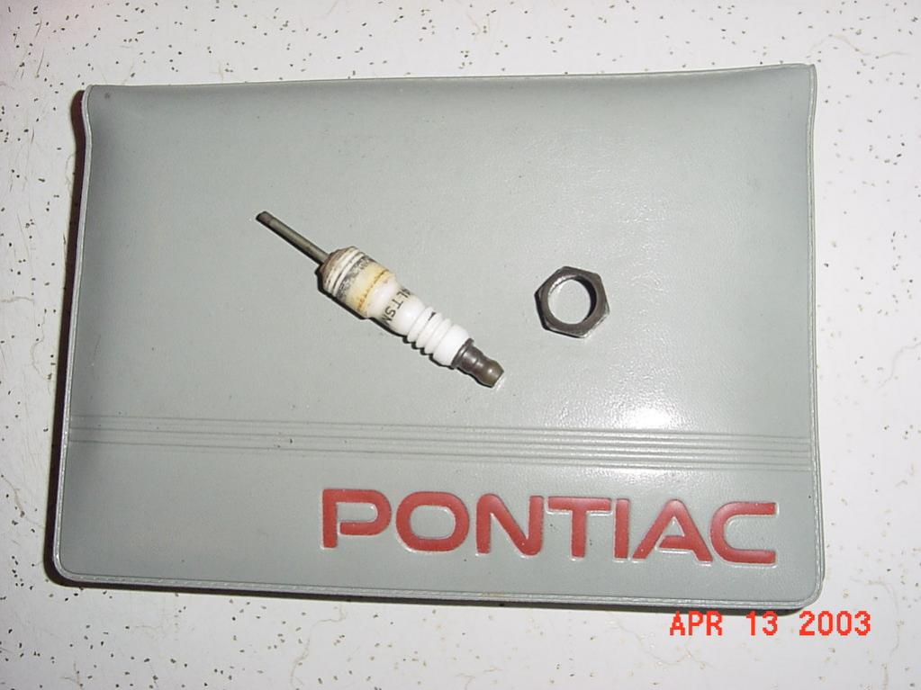

Here's pics from my worst spark plug moment, with a 3100 of all things... Here's what came out (this was the back cylinder closest to the alternator, I consider the worst one to reach):

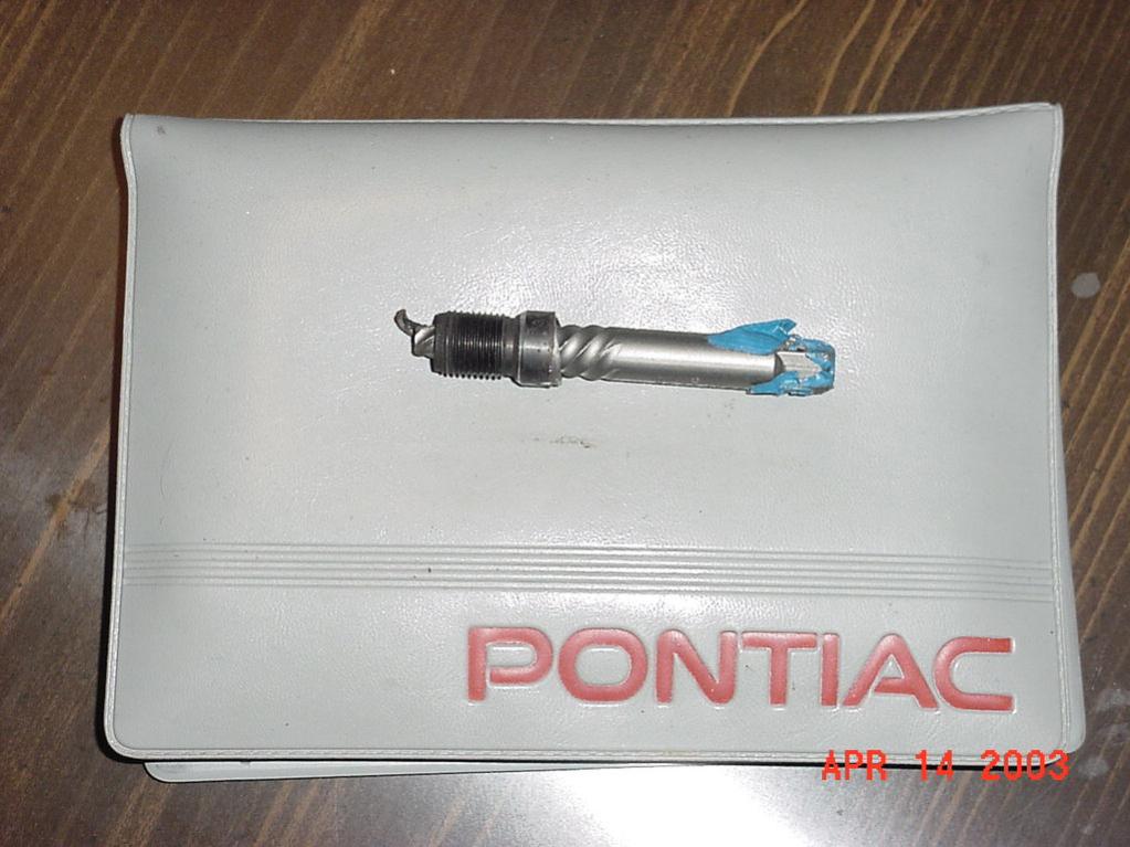

Here's what the rest looked like (and my dad STILL has that thing on his easy out to this day)!:
