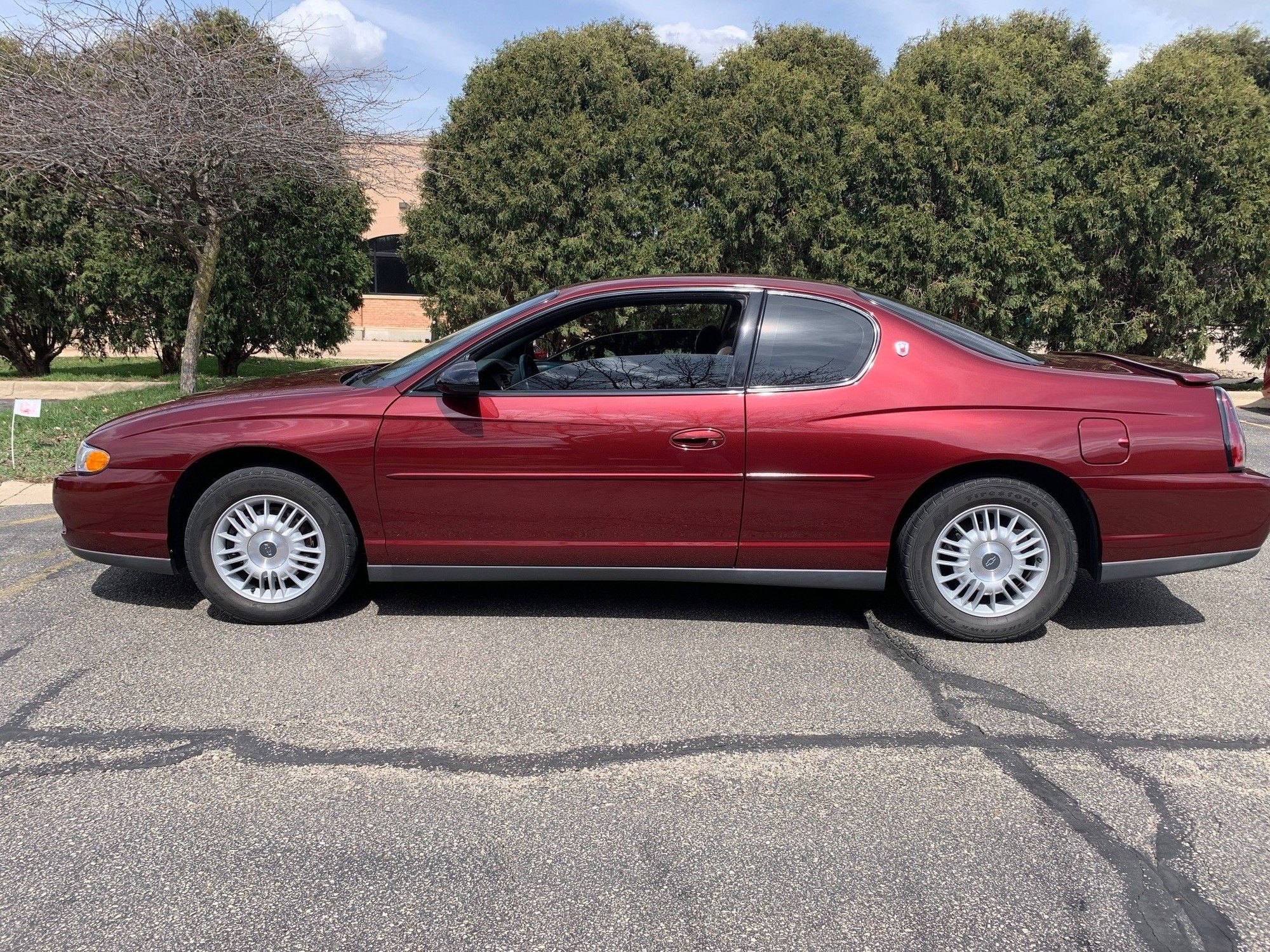

I'm trying to find specific data for changing my stock wheels to a 18" wheel. Tire rack has going from a 225/60-16 to a 245/45-18 set up with +35 offset. They say it will fit and not rub, guaranteed. Anyone done this before? How much of a difference in ride quality will I sacrifice doing this? How far out do the tires stick compared to the stock tires? I don't want to chip up all the paint on the side. Trying to find something i like to get rid of the 16" LS wheels, haven't found much in a 16" wheel i like.
It's hard to quantify, but it will be worse. Everyone has different levels of sensitivity to NVH, but you're losing nearly 20% of the meat between the rim and road that is currently air + flexible sidewall. It's not race car harsh though as you've still got a few inches of sidewall left- certainly much smoother than a 20" would be with rubber band tires.
I can't help there as I don't know offsets for stock 6th gen wheels. Lots of people run 245s without issue though, myself included on a 5th gen. If you're very worried about it though, you can always keep the width the same and go with a 225 45 or 225 50 but each of those yields a +/- 1/2" overall height whereas the 245 is an almost perfect height match.
