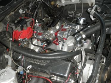

Just out of curiousity, do you have any pics of the engine?

I will take some pics today and post them. Like I said I love everything about this car was just suprised at the times. The car itself is in excellent shape looks very similar to the one in the photo at the top. Thanks for all the input. If I was having an issue internally where do you guys think it would be with that kind of power loss. Also I have AC was wondering if there was any power loss just from it being in the system but not running?

Ok here is a pick of the engine.

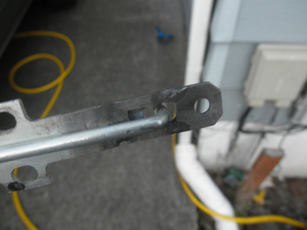

And here are some more of the car. The last one is my vacuum advance if you look closely there is a plate welded on it to stop it from advancing to far what affect does this have. Thanks for everyones help.
Attached Thumbnails My first track experience-042.jpg   My first track experience-043.jpg   My first track experience-044.jpg   My first track experience-045b.jpg

Sorry forgot the pic of the vacuum advance.
