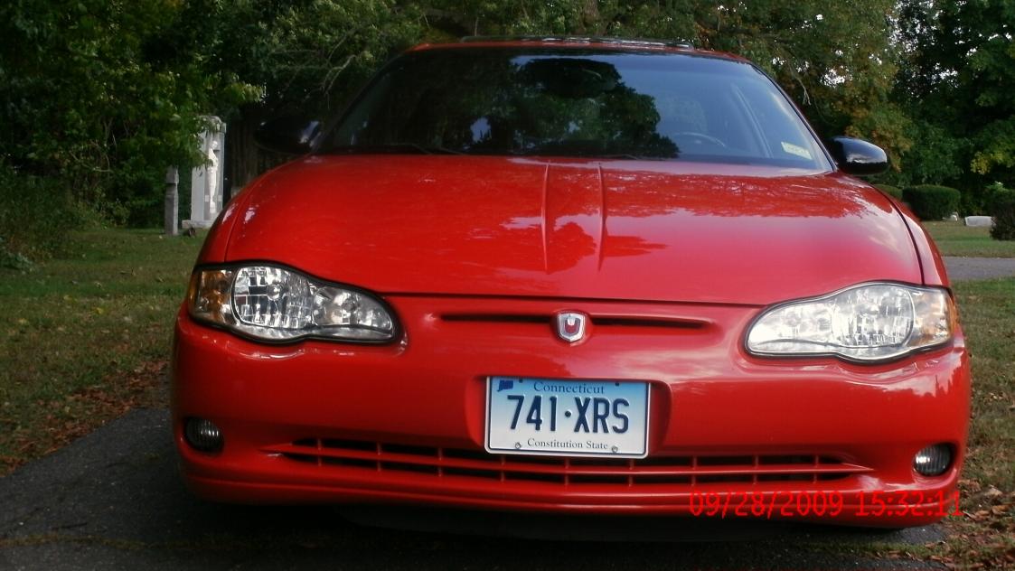

Talking OK -Heres the Deal.. My TS Grille install project!!
I followed Dale3's install pics post on page 2 here pretty closely..Thanx!!
I found that buying the cheap one (cheap..yeah right) on ebay..sprayed grille gloss black and siliconed the SS to the grille black spot..it fits perfect! Then I blacked out with flat black after light sanding the part behind where the grille mesh would show through and removed the idiotic looking knights shield ..The secret to my install was to use two sided tape on ENDS of grille only cause the curve of the grille is a bit different than whats on car..I put clear silicone all around the inside of the grille and using temporary guides i taped in place (beforehand) so as to position grille properly when mounting on car..Viola!! (the tape on the ends is the key) I sponged a bit of sqeezed out caulking with watered rag..Done ..and there is now a permenant watertight seal all around the grille..thanks everyone for their input! hope this helps others...

Looks good!

Yeah "grandpas oldsmobile 98" front end stock look stying.. had to go!
