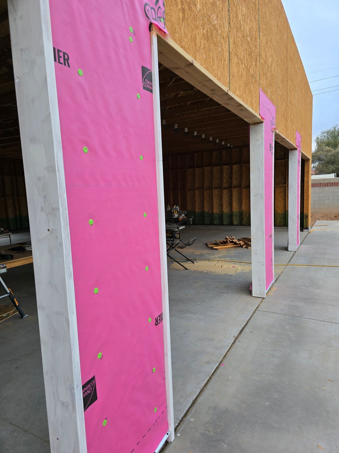

Finally to the point of starting to install the first layer wrap.
Spent most of Saturday getting all of the overhanging OSB flush and spent the little time I had today finishing up the weep screeds. Need to custom bend the drip edge flashing over the doors still, but I can put that in afterwards.
Took off the side jambs for a first coat of oil primer and got the easy sections of wrap knocked out. Looks a little Barbie house-ish, but Im glad to be making some visible progress again.
