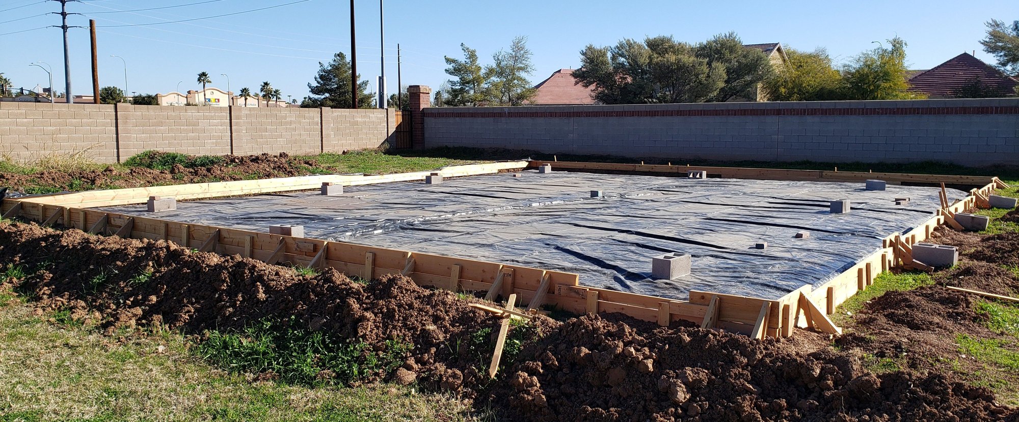

Making more progress finally. Busy end of the year with travel and its been so wet lately that its been hard to get much done. But managed to sneak in some work the last few weekends on the dry days.
Got the tops of the concrete forms totally done:
It's motivating to finally start visualizing what it'll look like. The slab has a 4" curb cast in, so the dips in the forms are for the doors (man door being closest to the camera, garage doors on the front and back walls).
Been working to get some key materials on order too. Had a really hard time getting quotes for the trusses for some reason. The place I'd used for my initial estimate ($13k during the height of covid lumber craziness) absolutely tanked in ratings over the last year or two and is now sub 2 stars on Google. Not taking a chance there.
Spent a couple weeks reaching out to other places and finally got a good quote back- $10k and 7 week lead time from a place with good reviews, so I've got those on order.
Struggling a bit with garage doors. Lead time seems similar to trusses, but had some issues with ordering Clopays thru Home Depot, so I'm pivoting to another brand now (Amarr most likely). Need to make a decision fairly soon.
Next steps:
-Fill in bottom of form board gaps (adding a secondary 2x board below the existing one to plug the gaping hole to ground level), add remainder of form bracing
-Finish digging footing hole. 95% done, but haven't been able to make progress with how wet its been. Getting the form boards in place makes it much more obvious what needs removed still.
-Compact footings
-Install rest of vapor barrier thru footings
-Install rebar
-Add curb forms
-Install anchor bolt holders
-City inspection

Been making some good progress lately. Got the remainder of the form boards up last weekend (still needs more bracing for concrete - especially across the front, but its dimensionally correct/ good enough for city inspection):
Spent Fri + Sat getting the footings 100% dug out for minimum width and depth. I hindsight I wish I'd have attempted the footers with a bucket digger. Ive run them before and wasn't super comfortable digging a straight and consistent depth footer so I went with the trencher instead (about half of the necessary width), but it made a huge amount of added manual work. Summing the hours worked, I'd bet I've got 3-4 full 12 hour days into hand finishing the footers - I could've screwed around a bunch more with a bucket and still come out hours ahead.
Regardless they're done and very straight/ flat consistent.
Rented a jumping jack compactor Sunday to compress the bottoms of the footers. Its mostly untouched soil, so its not super loose - but still nice to get it as compressed as it can be with a bit of added moisture to help pack things better.
Next weekend I'll finish installing the vapor barrier in the footers (need them to dry out first from the added water during compacting) and start into rebar.
