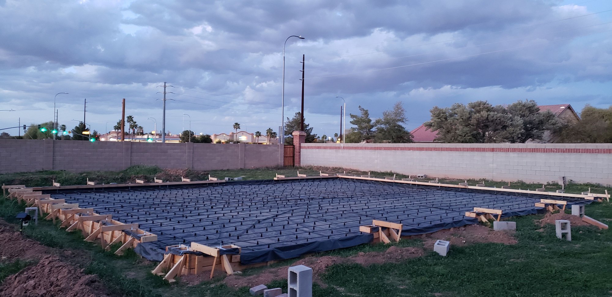

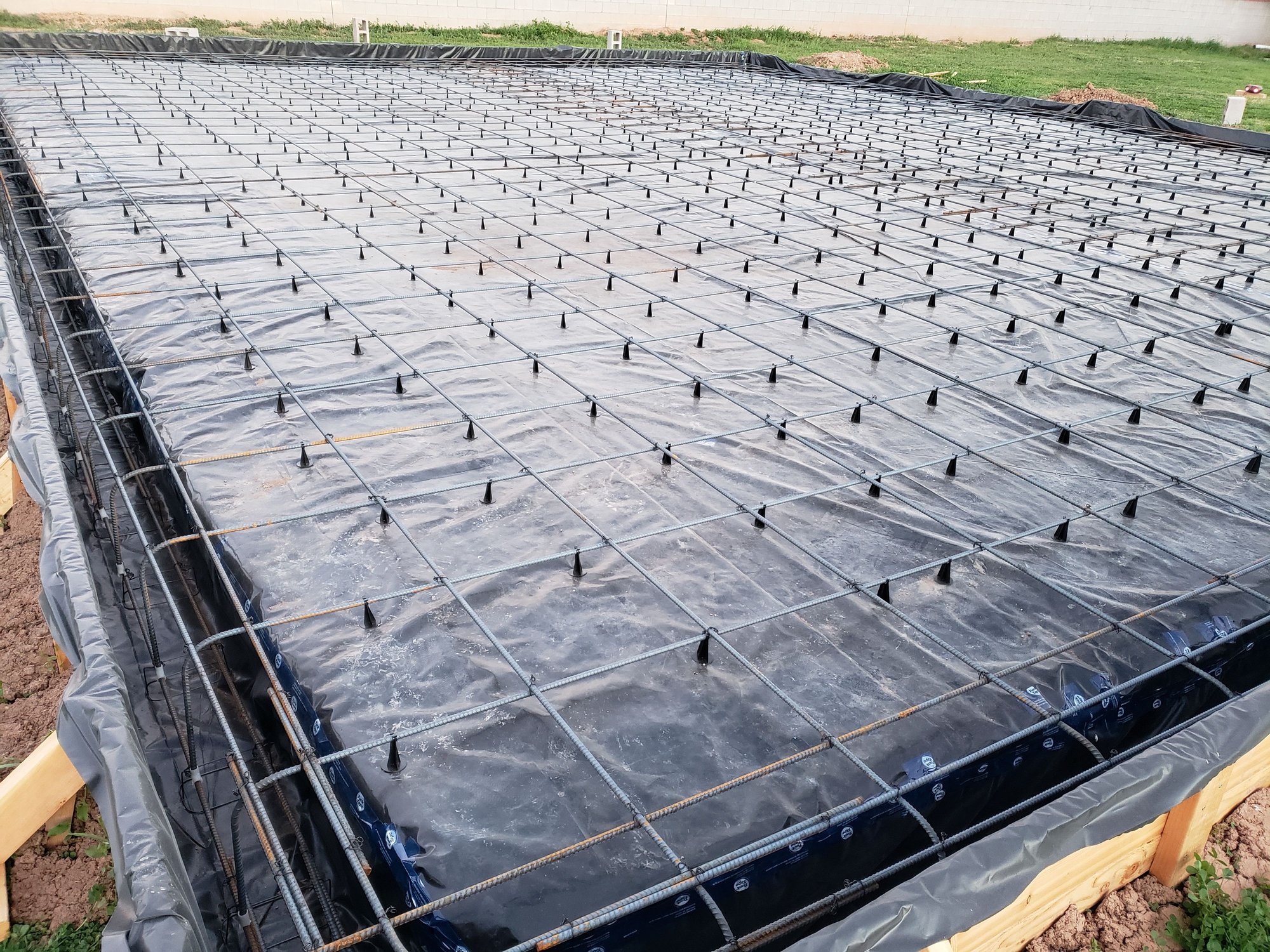

On the upside I made some good progress on rebar - its all 100% done. Ended up just 200 feet short of 3/4 mile of rebar altogether. Hands are wrecked, but at least its over.
Next up is finishing the forms for the curbs and making up brackets for the J bolts. Hoping for foundation inspection in 2 weeks with some concrete soon after...

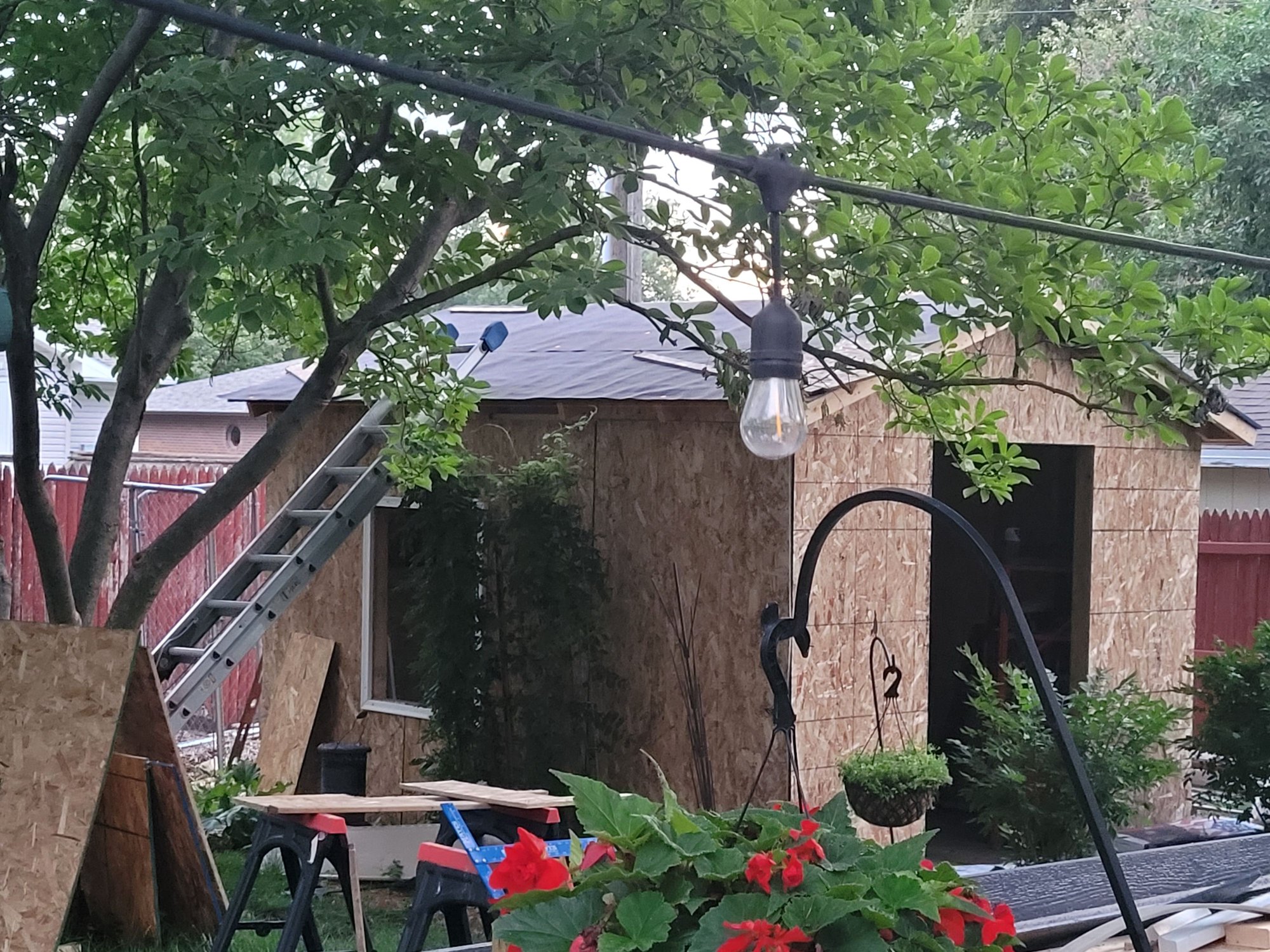

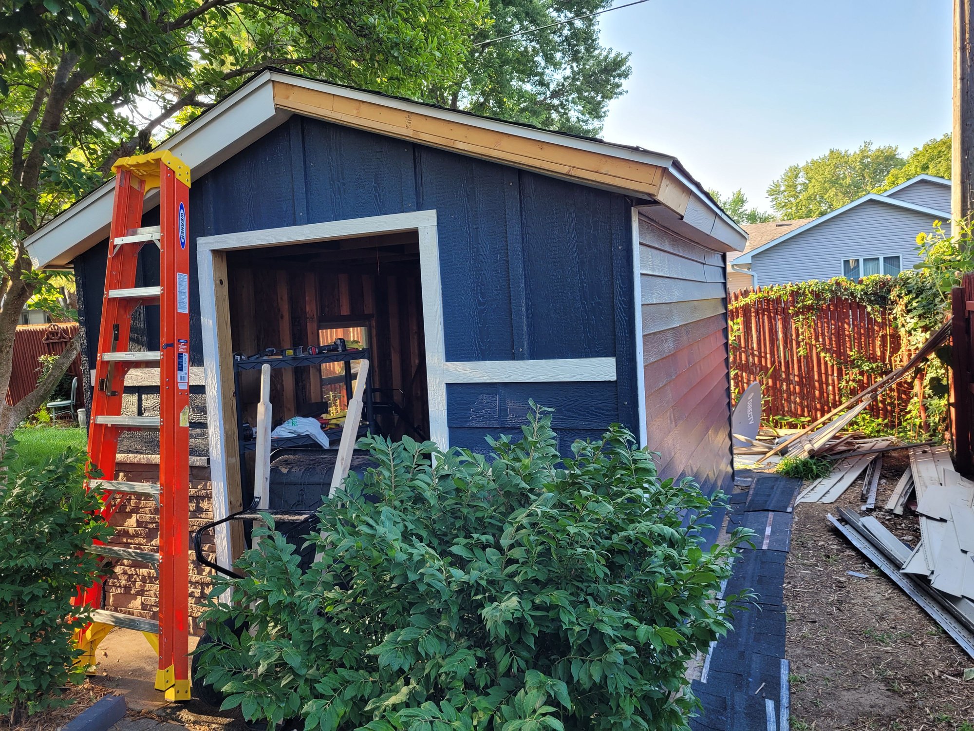

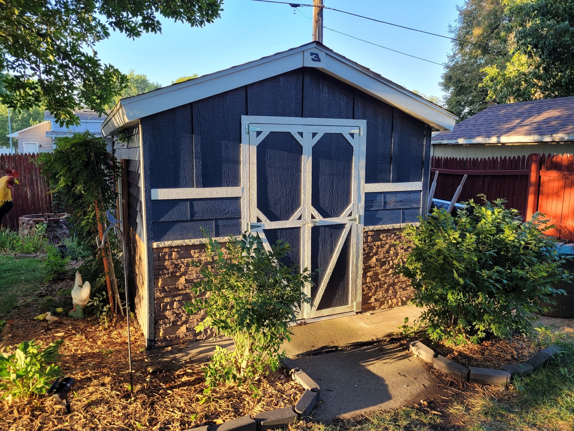

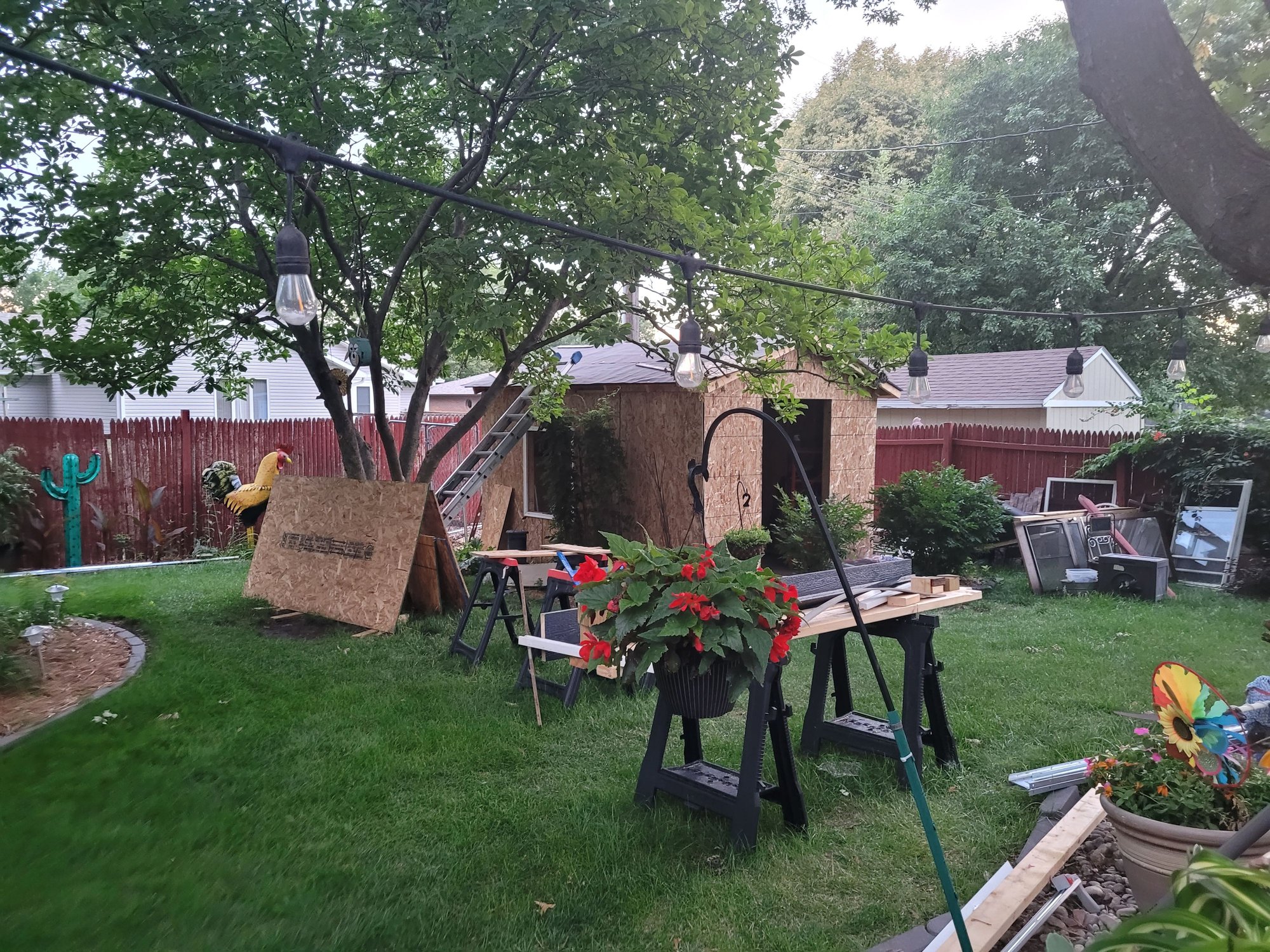

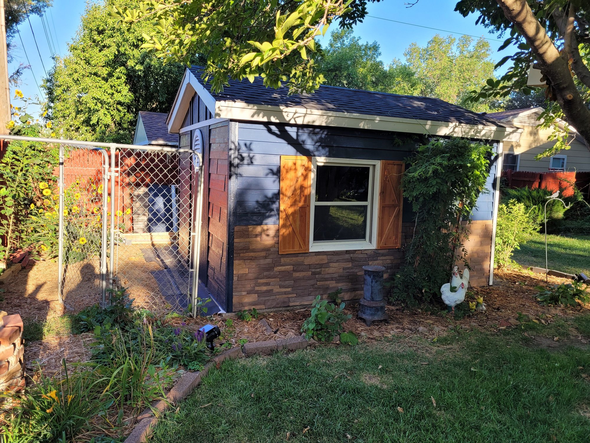

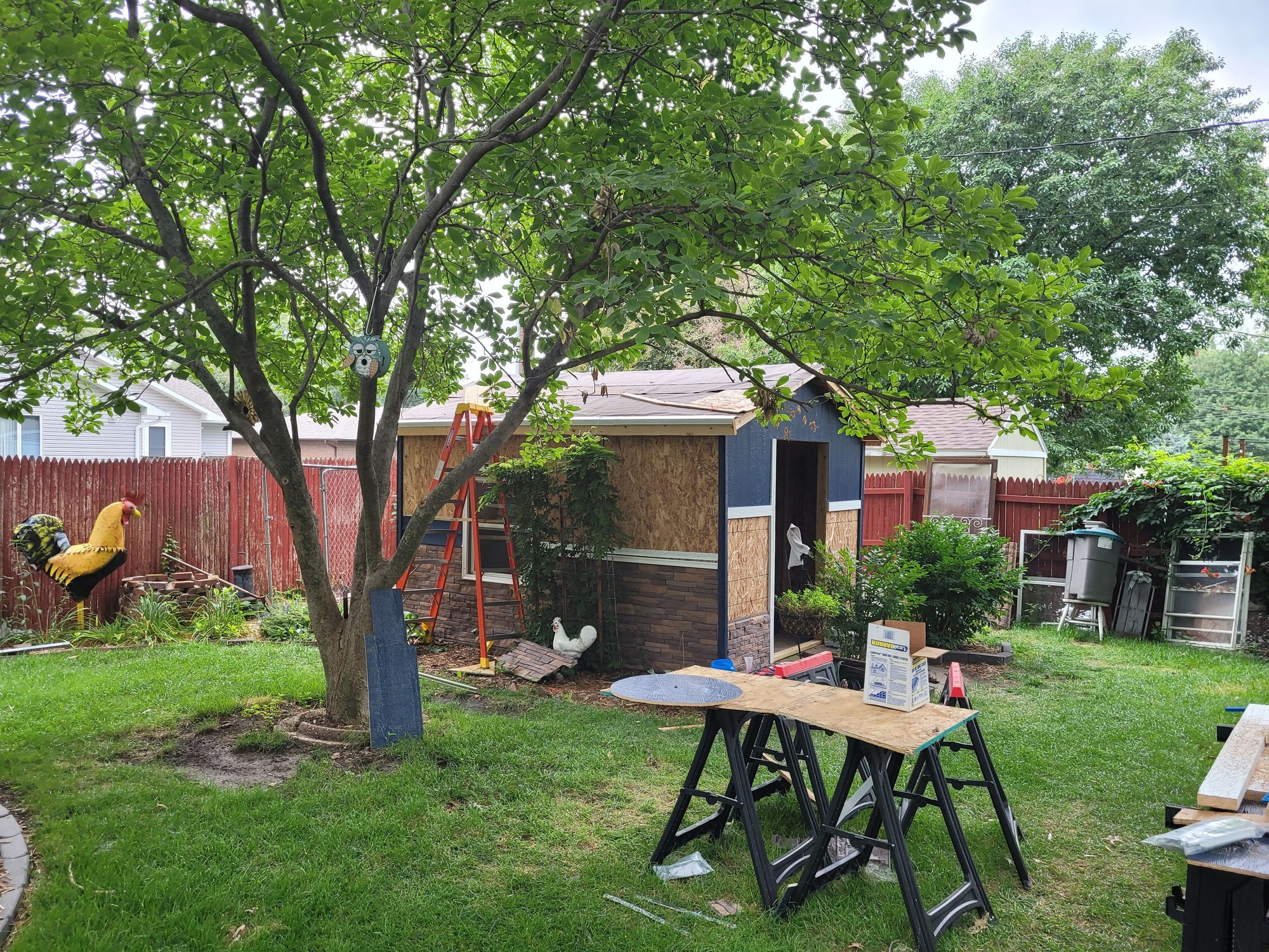

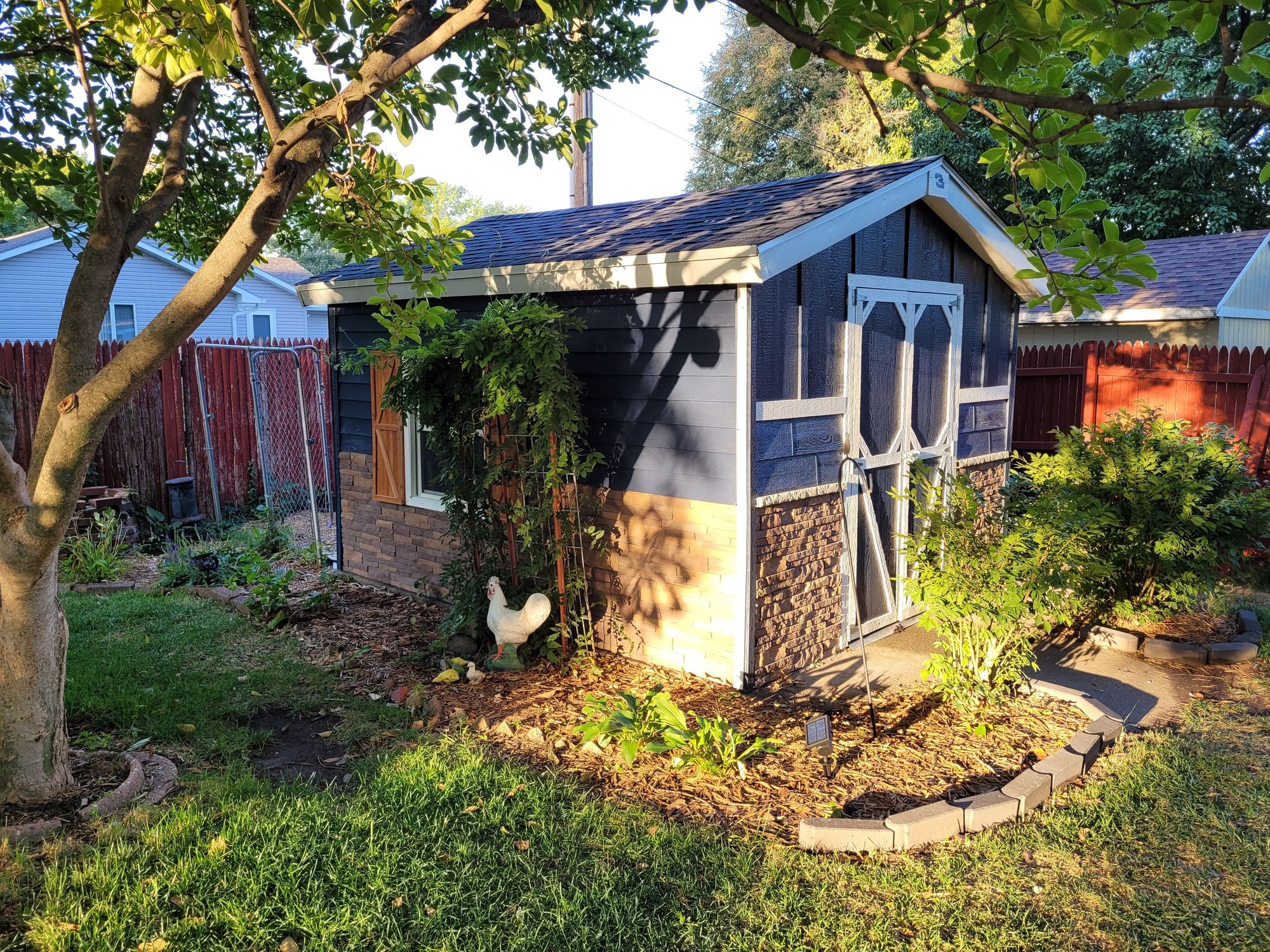

Wow that is pretty impressive. Last year I rebuilt the backyard shed that was destroyed in the Hail Storm of 2022. I couldn't get anyone to do it so finally i gave up and did it myself this time instead of the Tin shed I built it out of wood, Built my own Trusses used to engineer and design them, I was also a GC but it took like 150days to complete mainly because I am 72 years old and each do I worked on it was super Hot. I would start at first light and about 3 hours and then I was done. What I refer to as a 3 shirt day because the humidity is so high hear.
What I had and had to take it down, stabbed my self in the foot and needed a tetanus shot. Lol
Starting out
got the walls and the rafters up
Diamond Kote siding Metal fascia
I got luckiy and didn't fall off the roof when I shingled it
I put the vinyl stone that was on the front of the house when we replace that siding
A 3 on the the Peak?????? I built the doors and they work fine after the winter.
Gotta have a Vent
I even put a window in it, hand built the shutters
Wow, that's a nice looking shed - I don't think I've ever seen one with that much detail work put into it!

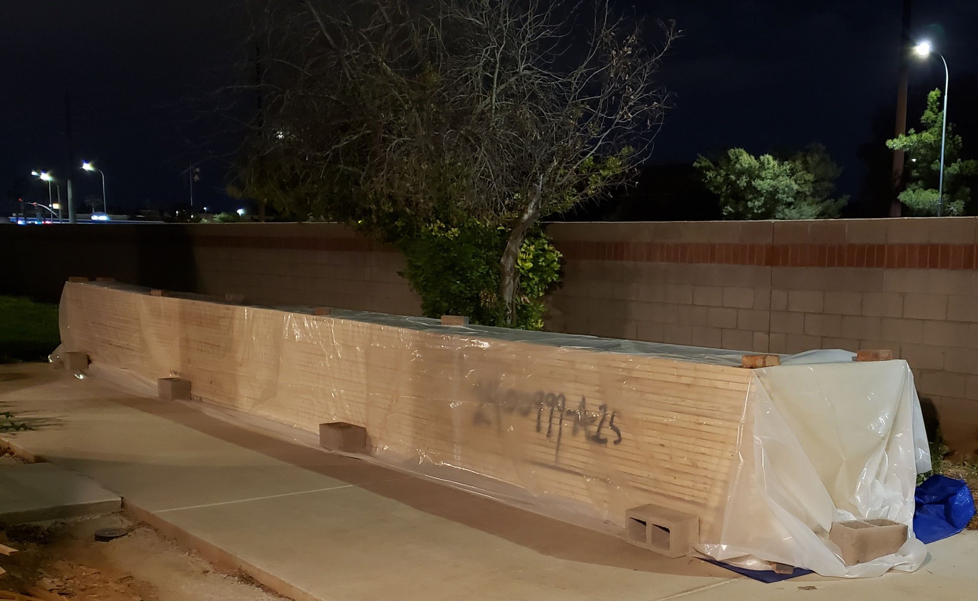

Trusses are here! Ordered a bit too early, but Id heard horror stories of people being delayed months for them due to backlog at the factories. So I've got them all wrapped up for short term storage.
They're 200 lbs each, but its amazing how they're a wet noodle when not installed + braced. I figured we'd set them on furniture dollies and just roll them, but I expected something a lot more rigid where we'd jut be applying light force to keep them upright. Not only did we fight to keep them vertical (sometimes falling different directions at opposite ends even), but also roughly in a straight line as we rolled them. I'm used to seeing the upside down V shape trusses that are maybe 20 or 30 feet long, but a lot taller.
Going to be a bit of a pain getting these on top of the roof.

you should be able to tote them into the Garage, Point down set one end on the wall and then set the other end on the wall Brace up the end wall truss.
Then tip the Truss upright and use a few 2x4s to set them upright.
Remember to plumb them.
They make some metal spacing bars that you can slip over the truss for proper spacing the are light and actually come folded.I use d to design them build them and set them up and was a sales rep for like 10 years.
When we get closer, I think I'm going to look into some kind of rentable machine to get them to the site and up there. We did carry 1 and frankly it was about at the limit of what my wife and I could carry due to the size- I definitely don't think we could do more than a few back to back like that. Thats why I'd used the furniture dollies for rolling them standing up from the street as far back as I could on existing concrete. Maybe I'll get lucky and the timing will work out so that I can get the rest of the driveway poured before I'm ready for trusses on the building. Would be nice to be able to at least roll them the rest of the way on the dollies into the building to save some back effort.
But I am seriously doubting if we can even lift 1 end up onto the walls by hand/ on ladders though. I think at a minimum I'll need to hire some labor help. My big fear is that one rolls onto its side while its only supported at the ends (ground on one end, us on the other up on a ladder) as it seems very likely it could snap in the middle. We'll see - have to play with it a bit when we get closer.
I did put in an order yesterday for those Simpson truss ties/spacers for both the top and bottom chords (the kind you can leave in / sheath over). I was forced to for the bottom chord, and figured it would make things easier if I got them for the top also. The truss designer originally had the bottom bracing specified as interior drywall, but this building permit is only for the building shell. I really dont want to put ceiling drywall up to finish this permit as I can't do electrical / lighting / hvac / insulation on the existing permit, so Id have to pull it back down for the next permit.
So the truss designer added these lateral braces as an alternate so I could leave the interior open for now.
