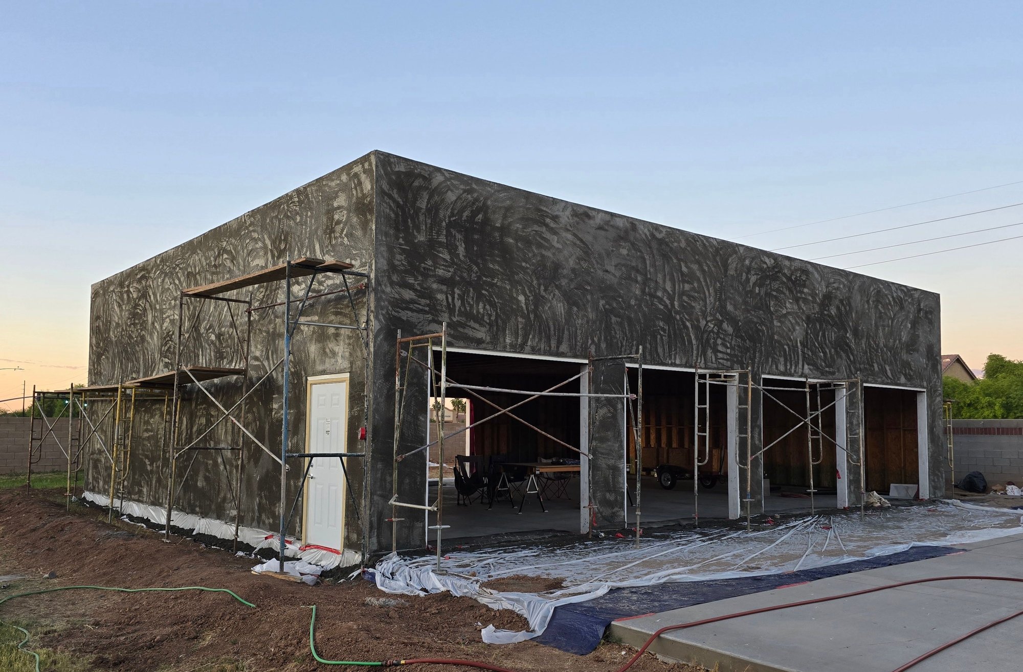

Baby steps. Top coat stucco next week once this layer cures.

Old May 15, 2025 | 09:39 PM

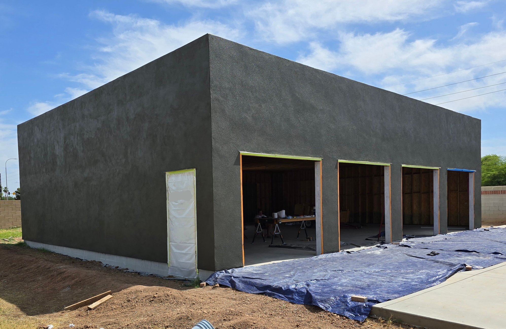

Posts: 6,471
Lots of work this weekend. Got the whole thing coated in "hot" stucco primer (pH is still 12+) and one coat of gray paint. Still needs a second coat of paint to complete the system / even out the finish.
The colorful stuff around the doors is just me using up every scrap of painters tape I had left in the house to keep the deep gray off the white trim.
Lots of labor hours left to go, but at least its all on just a handful of projects rather than a mile long list.

Old May 27, 2025 | 09:33 PM
  #117
That looks awesome!
