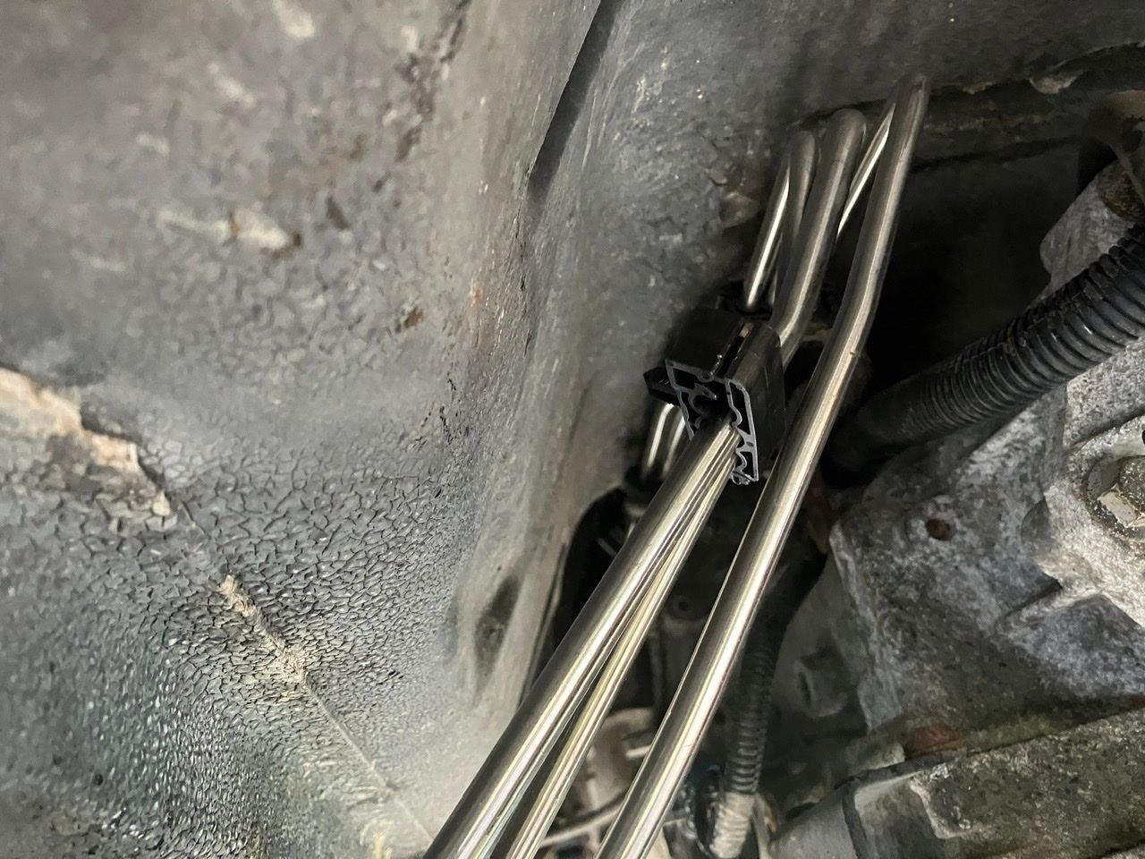

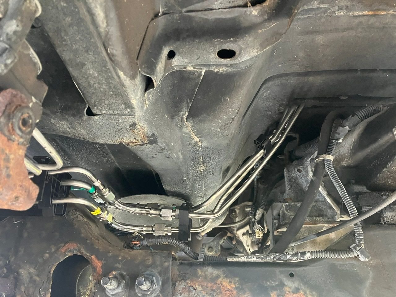

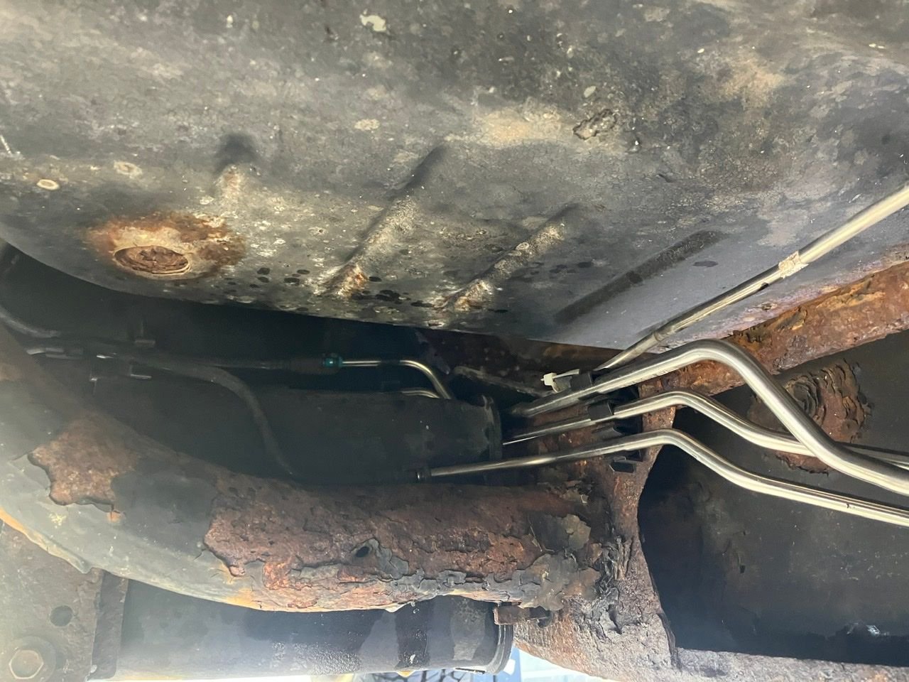

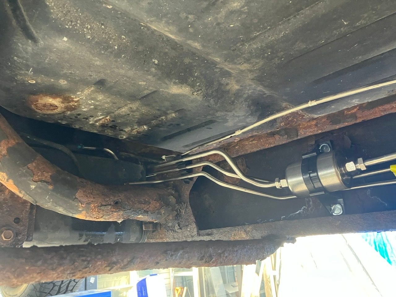

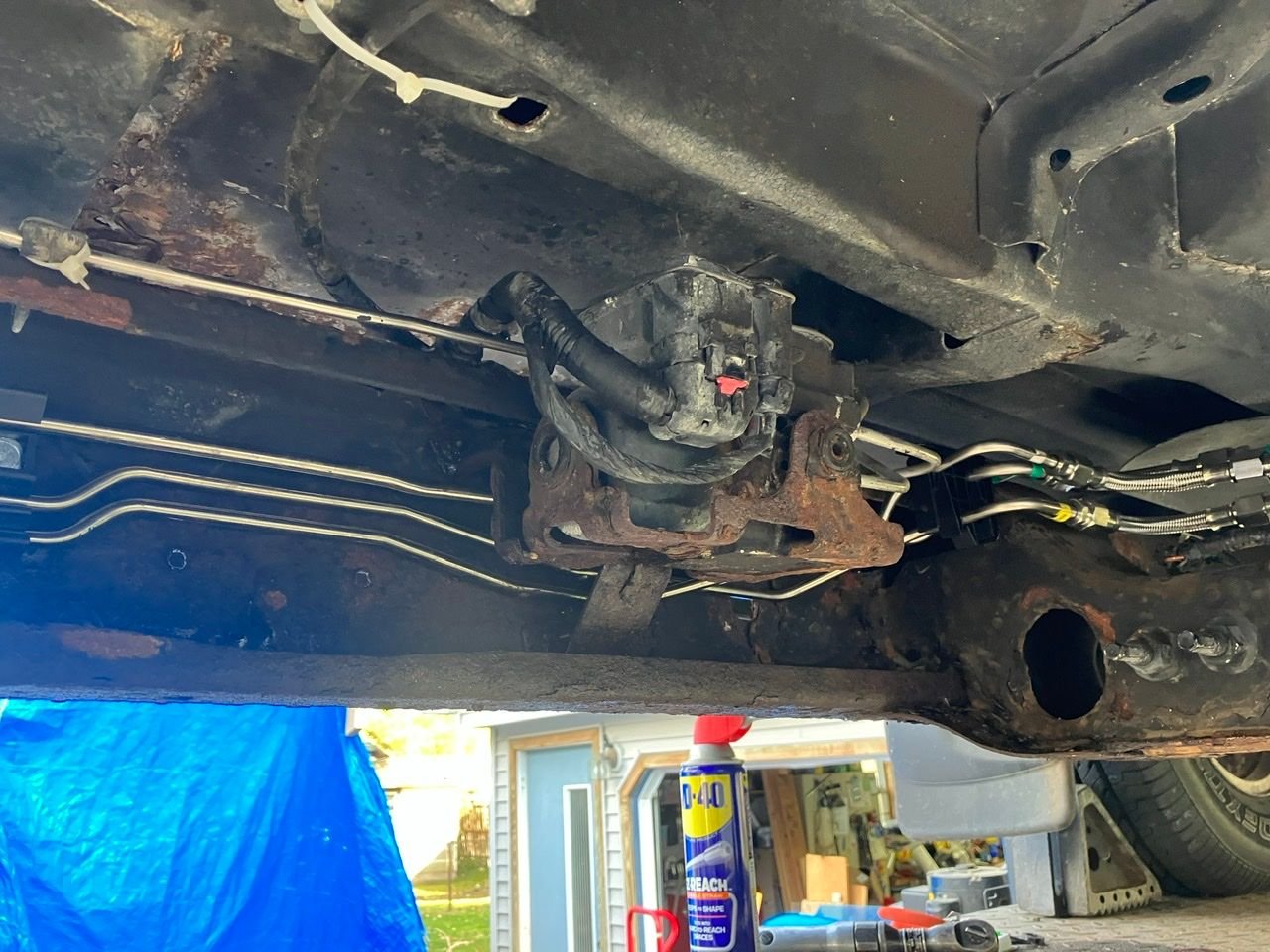

I know this is NOT a Silverado forum, but I had to share my non-Monte project of the weekend. This is a truck my dad and I co-own, we bought it in 2019. We got it as a spare vehicle AND great to have when you actually need a truck (no more arranging to bug a friend). When we bought it, it needed a brake line, we went and used the Dorman stainless steel brake line kit. The kit is nice, but not sure if it was me or the kit, but I remember it being a pain routing the lines to the ABS pump (side note, that pump is in a HORRIBLE spot on the frame rail). We also bought the Dorman Stainless Steel replacement fuel lines (we knew it was going to need them and well, three years later, here we are).
Some back ground, years ago I helped a friend replace the fuel lines on his 2003 GMC Sierra (same truck). He used the AC Delco OEM replacement lines. Because of that ABS pump issue, we cut the lines, flared them and used rubber fuel line and clamps to reconnect (that was MANY years ago, truck is still running with no fuel line issues).

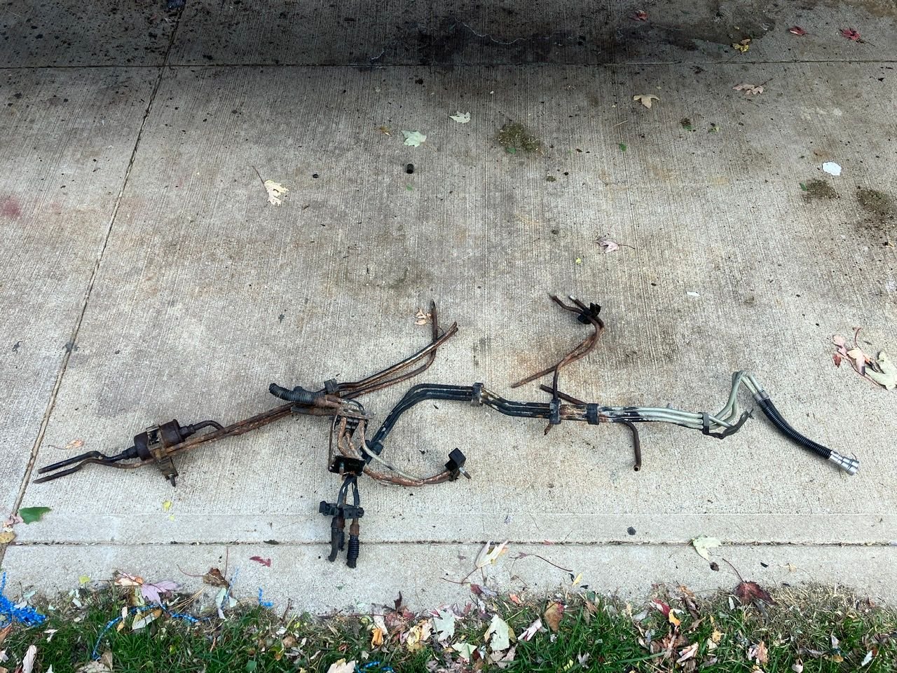

Back to this.... Dorman has a 2 minute video and if I recall they said difficulty is moderate and install is 1-2 hours. I think we are in the 4-6 hour range (including a lunch break). There are some things I wish I had pics of. Removal of the old lines had 2 problem spots. Finding the right touch to disconnect the quick connect for the vapor line under the hood. Second, fuel supply line from the nylon tube going from the tank to the metal line. When it came out, it brought a plastic retainer that I spent some quality time getting free, but I got it. I also used 3+ feet of socket extension to reach a nut holding a retaining bracket.
New install, pretty awesome! Sure, you had the usual stuff like "here's a wiring harness and I am on the wrong side of that" or, I go back to BAD placement of the ABS pump. The new lines were in three sections. The front-to-middle section had flex lines you had to connect (which is where GM had flex lines) and the middle-to-back had some unions. My ONLY complaint, one of the flex line was kinking, so I took the hard line out of a couple retainers to help get better spacing. But, over all, awesome. It's done and NO leaks!
