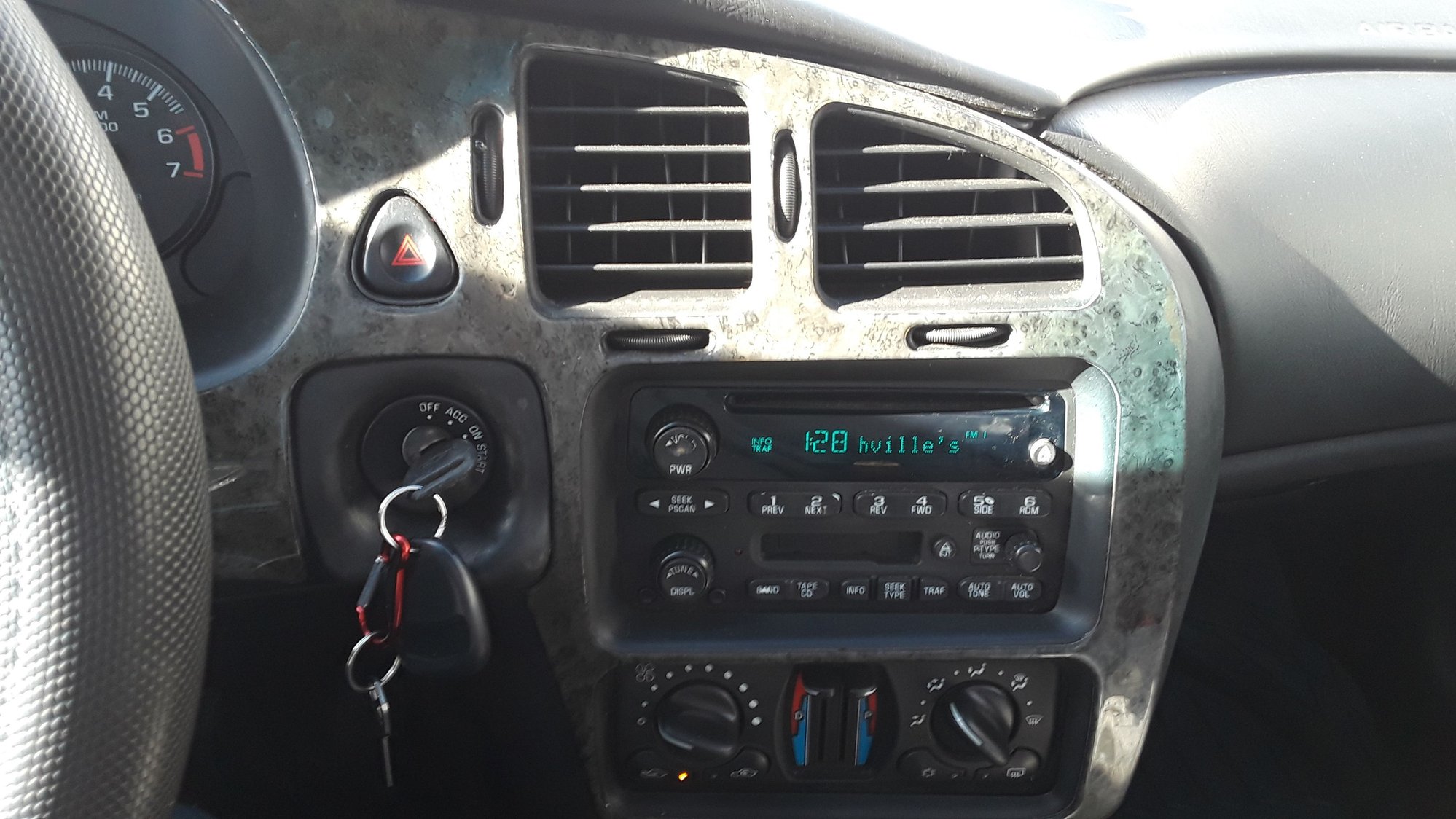

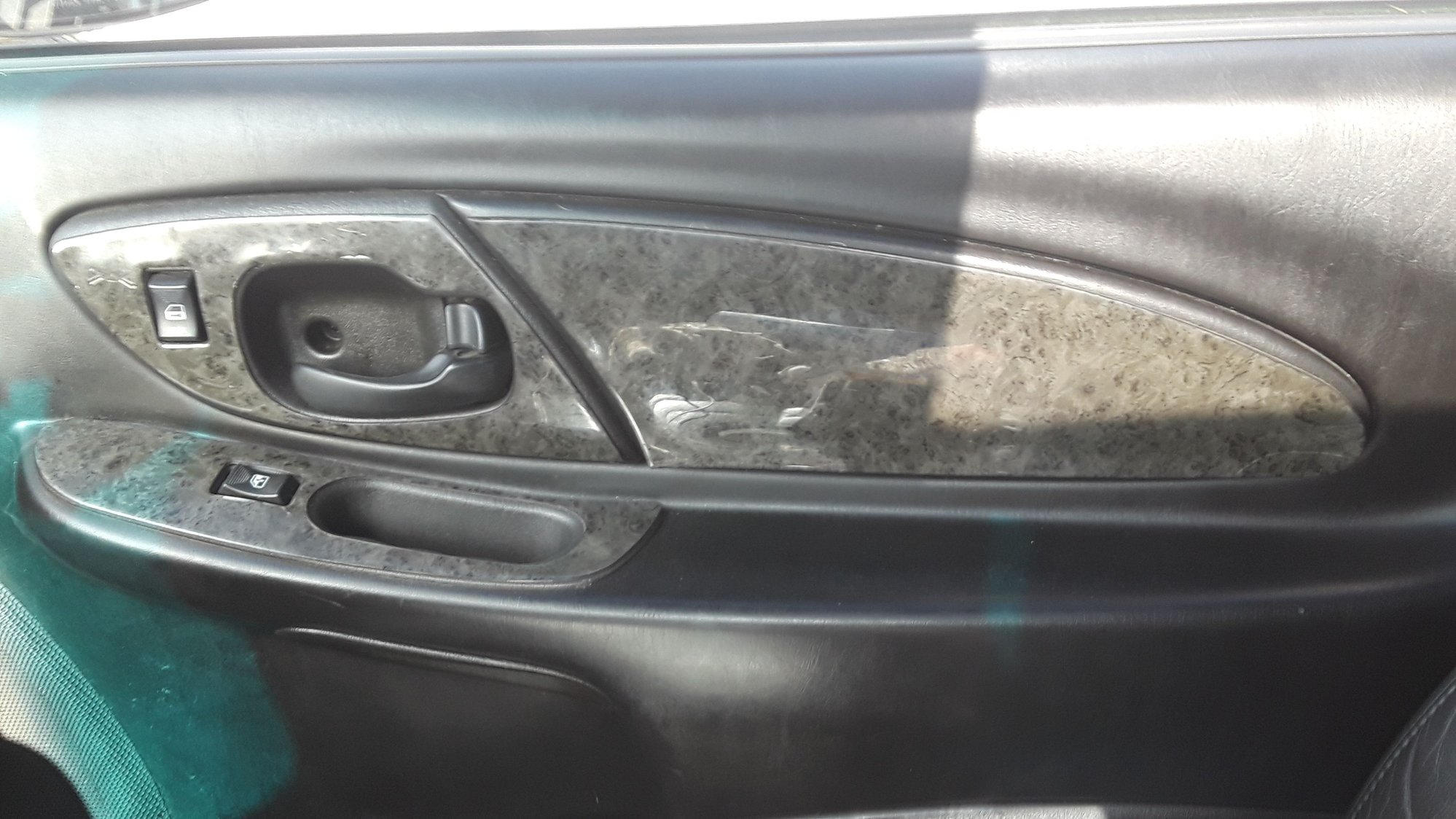

Someone before me stuck this crap over my doors and dash. How do you get this off? Carb cleaner? Heat gun? Know any tricks?
Dash junk
Door junk

My car came with some (not all) information on things installed on car. The pieces on the interior appear to be from a company called "Exoticwooddash.com", I had no luck when I looked online for them. The instructions mention using an adhesion promorter, the final step says to uses a hair dryer and press firmly. You might want to try heat and a plastic putty knife on the door handle. If it doesn't work that piece is easy to replace without the whole door panel.

I will do some testing. Even carb cleaner can melt some of the adhesive stuff. There is also goop gone that is supposed to free things up. I have a heat gun. I will give it a shot. Thanks for your input.
