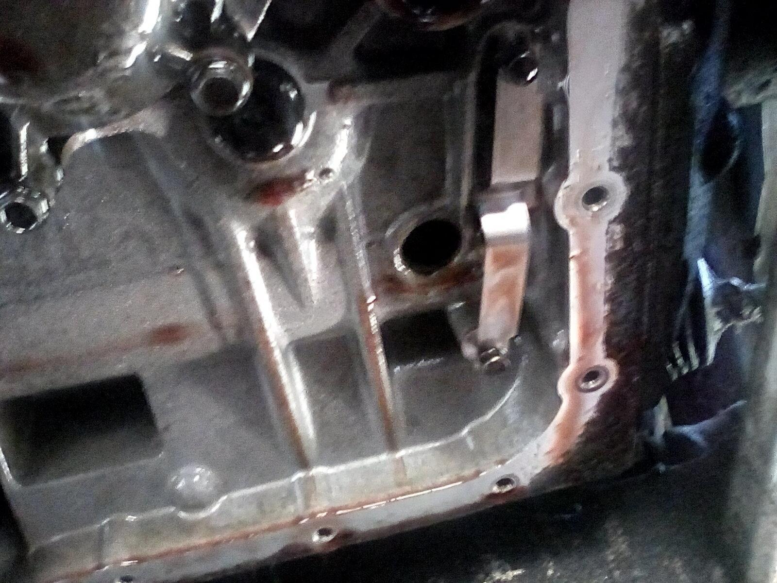

02 Monte 3.8 Was changing the filter on the transmission and while cleaning the mating surface, I knocked this thin piece of metal off. I looked under the tranny and attempted to put it back despite not knowing where it actually goes or how it actually sits. So, here I am looking for someone who knows where it goes and how it's placed. Thanks.
Fell out while cleaning the mating surface of the tranny to pan in the vicinity of where the filter spout is inserted.
I placed the slither of metal on those two posts but don't know if that's the right place much less if I have it installed correctly

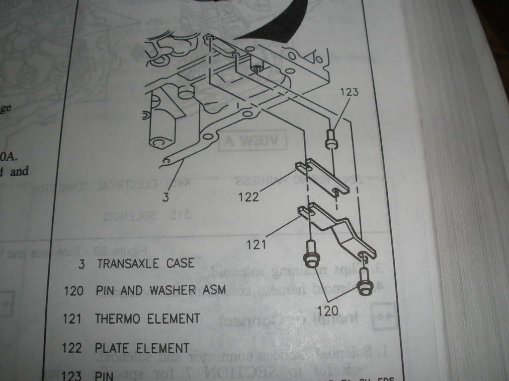

From this stock image, the box area is where I attached it but I don't see it in this image

The piece in question is called a thermostatic element, problem solved.
