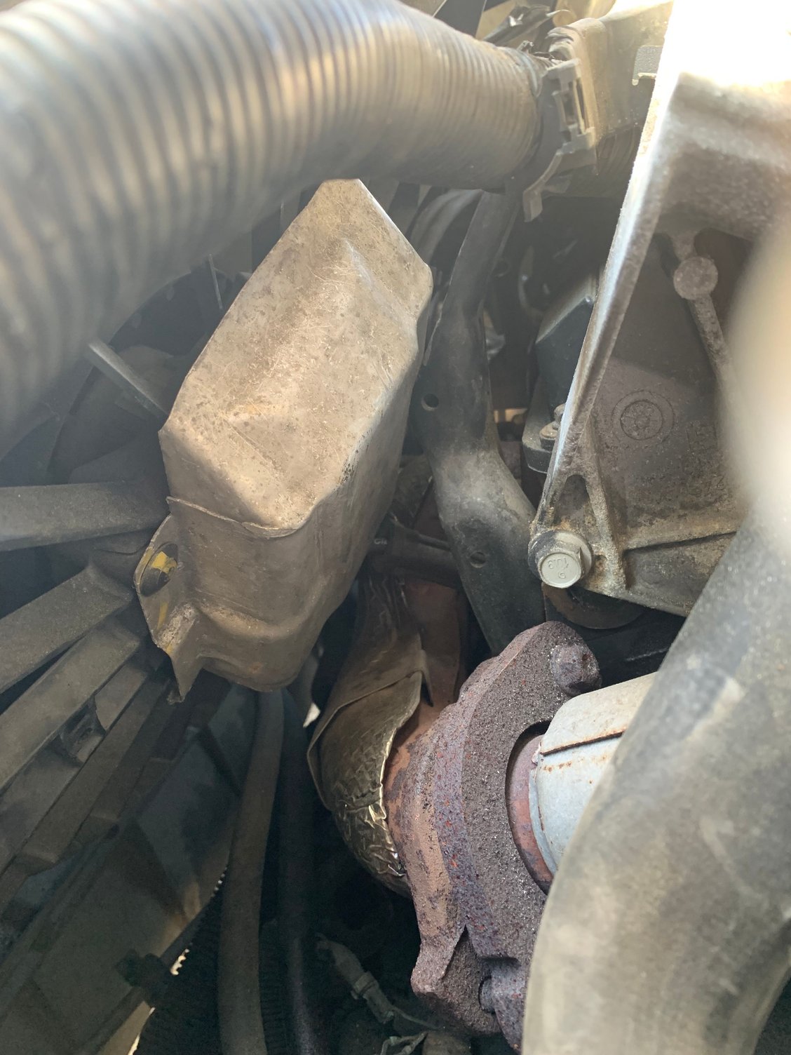

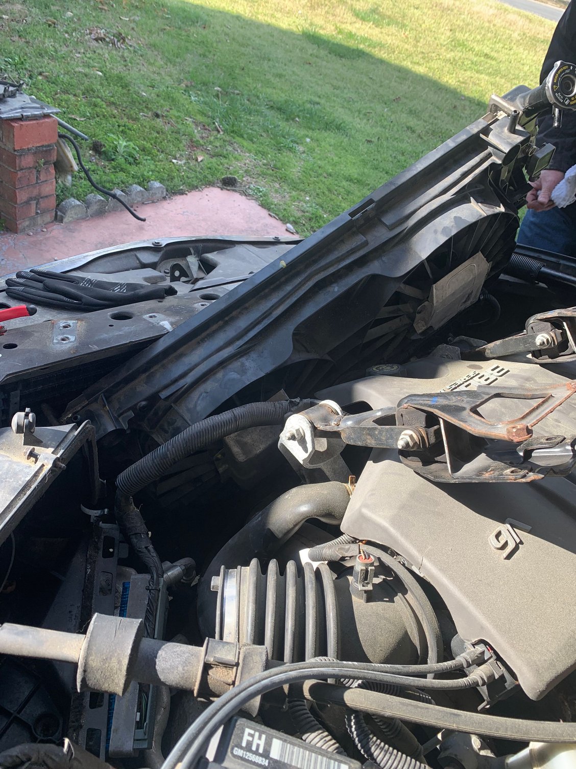

Got to here.
Metal plate on fan rubbing against engine preventing from coming out.

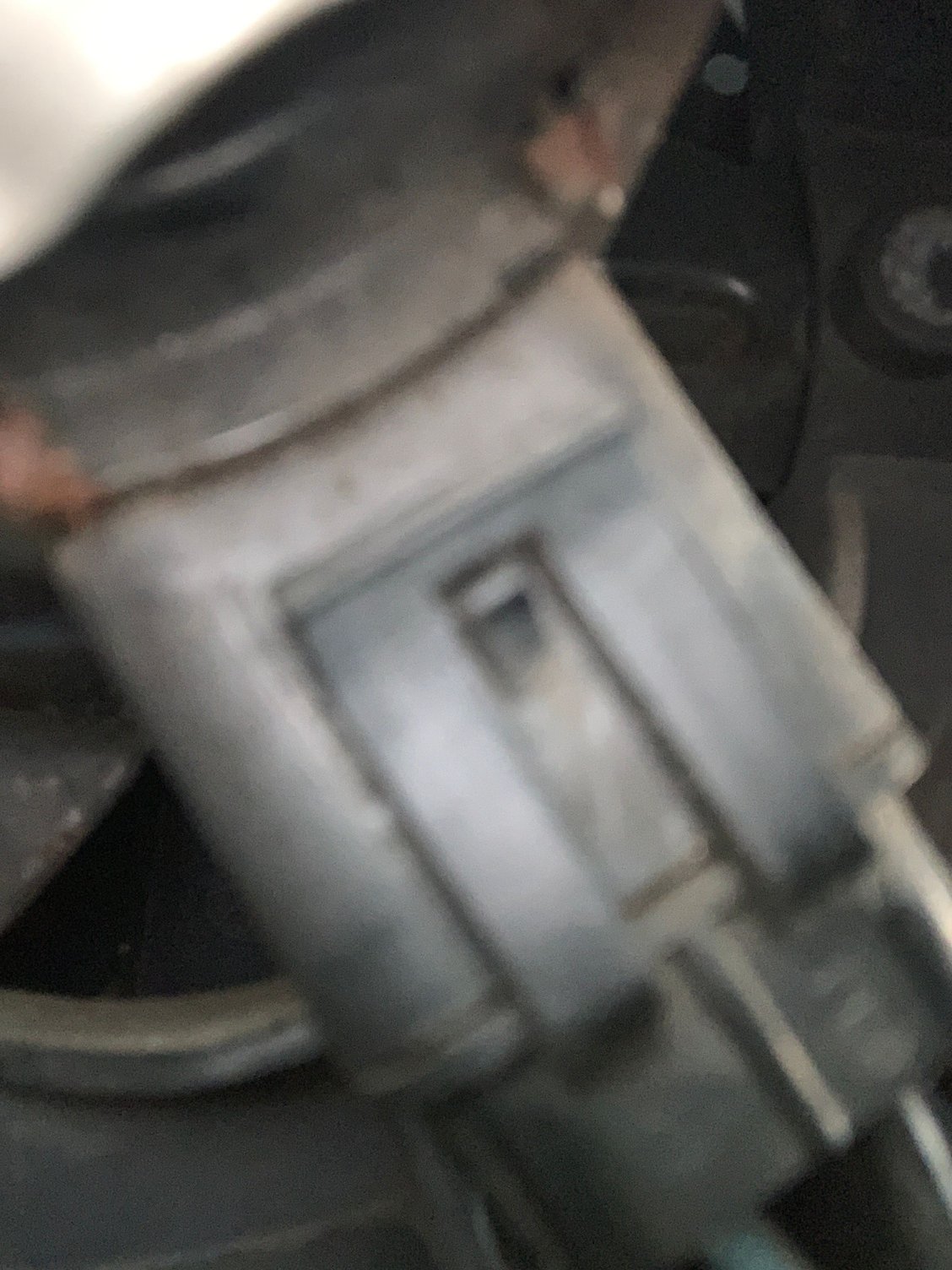

Then realized fan wire harness was still attached. Can’t see it to get it undone.

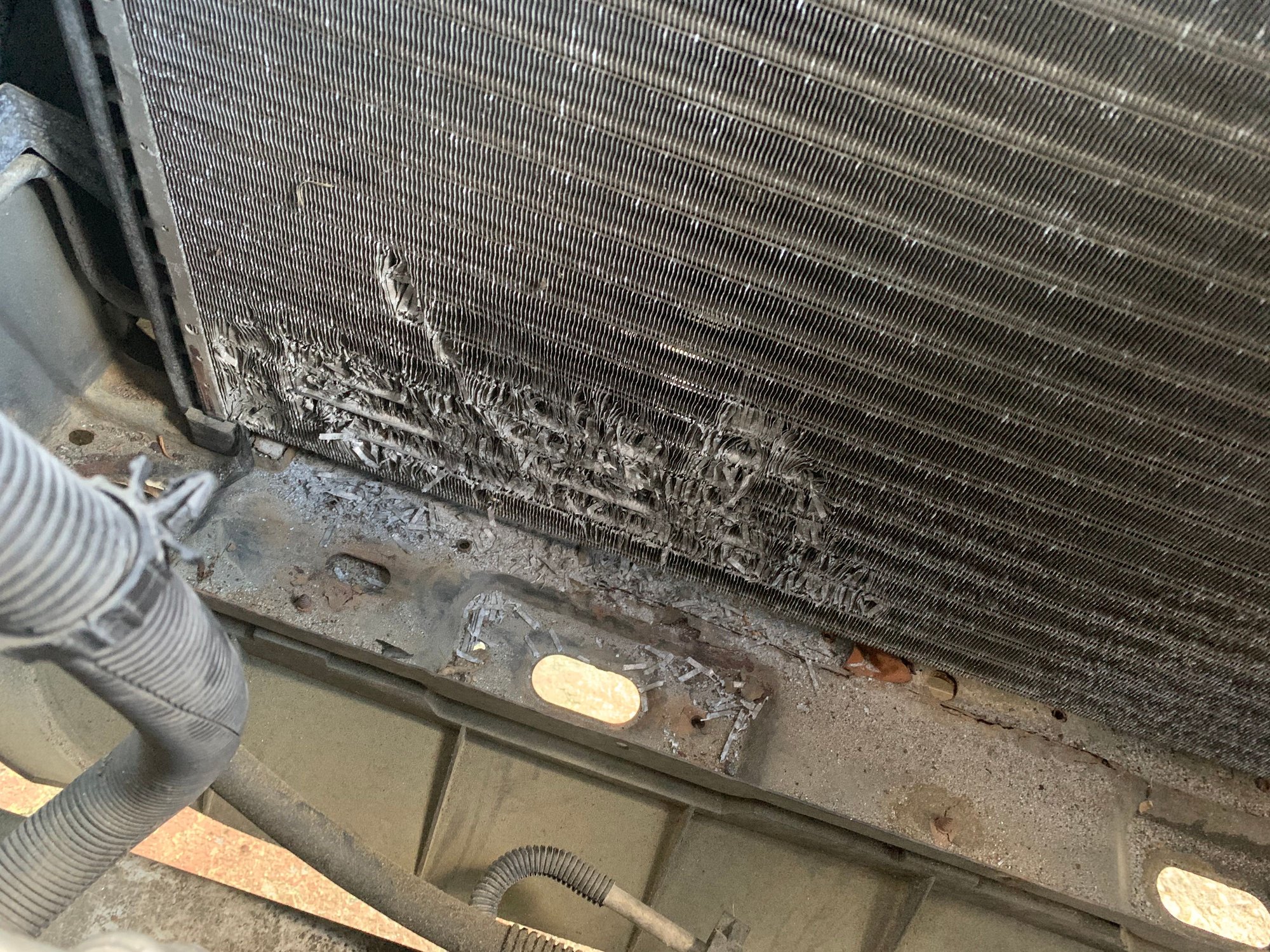

It’s out! But not without damage to the AC condenser.

Originally Posted by Household6
Any input on what else I might want to replace while this beast is out, please advise.
I hate to say it, but Id be very tempted to replace that ac condensor too. The fins can be straightened, but Id be worried about a pinhole leak forcing you to pull it all apart again. Without a radiator, it would be tough to run the engine long enough to see if its holding pressure.

I've changed a couple of these radiators. And it might be due to my experience, I found the task straight forward. Drain the system, remove the dog bones, then the upper, disconnect the hoses, disconnect sensor and fan wiring, unbolt the fan assembly from the radiator, slide fans out. I am trying to remember if the AC condenser attaches to the radiator or not (I want to say it does and if so, it lifts off the radiator). Then reverse everything.
I do agree with Bumpin, the condenser looks rough with all the fins fallen. It takes a pin hole to make your AC fail and you are a bulk of the way there, not much more to change it.

There was a plastic push pin/screw on the bottom of the fan assembly that was causing the grief - not allowing the fan assembly to come out without the radiator attached.
