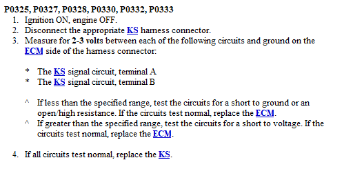

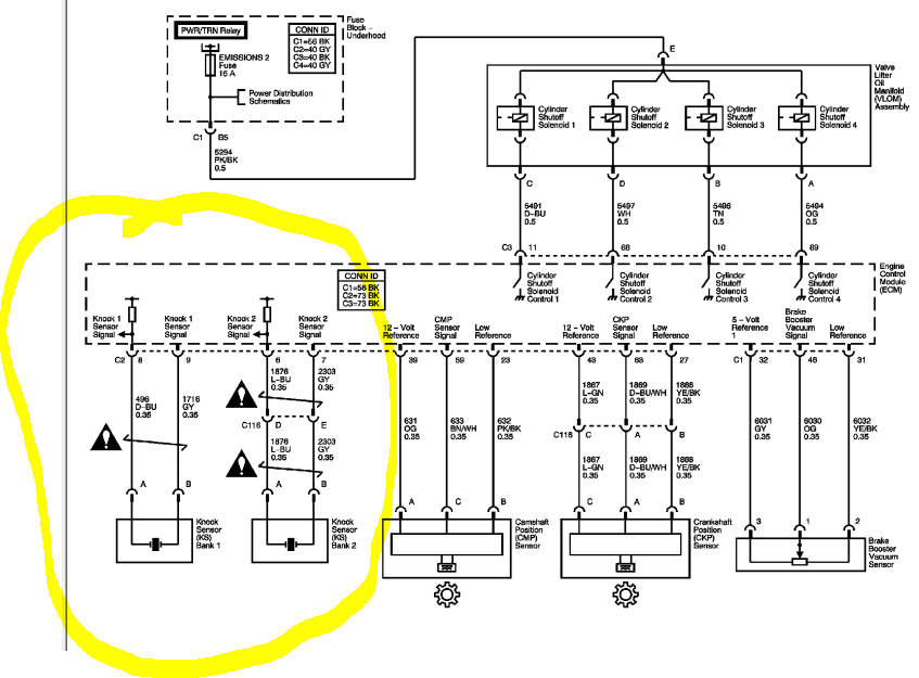

That code means the knock sensor is shorted to ground. I attached some testing steps to take as well as where it inputs to the PCM. If the resistance test is fine then I would check to make sure you don't have any chaffed wires from the knock sensor to the PCM causing the ground input to the PCM for the knock sensor.
