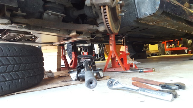

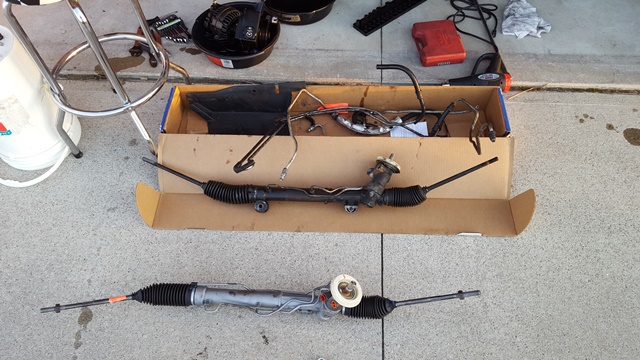

Here is a good YouTube video on how to replace the Power Steering Rack & Pinion.
I replaced my entire power steering system on my Monte. (steering rack, steering pump, reservoir, high & low pressure lines and cooling line). I did this with jack stands and ramps.

9 hours total. It took me 6 hrs the first day, then I did not touch it till the following weekend. The next weekend I spent 3 hours on it. All together I did the power steering, oil change & rear plugs and wires since I had good access with alternator off.
