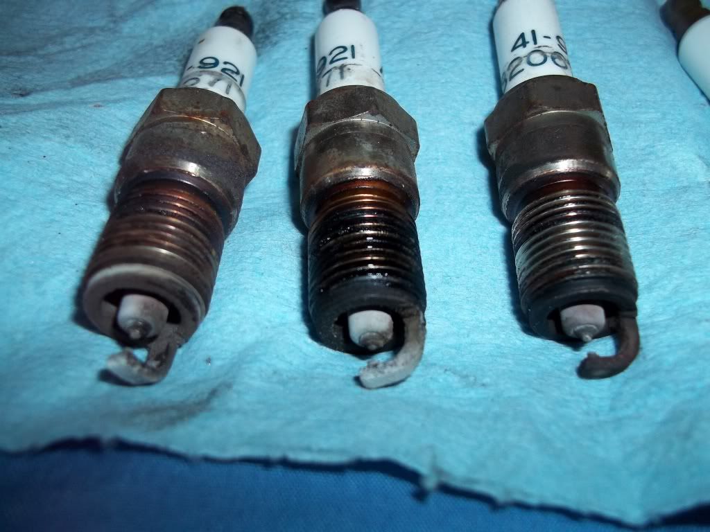

Hey everyone, I have finally been replacing the plugs on my 2000 Monte Carlo SS. She has a little under 130k miles on her. I have replaced the front three plugs and wires with stock ACDelco parts. However, I have a few questions:
1) Can I drive her for a little while with just the front plugs replaced until I can get to the back ones? Or will this be hard on the engine?? The old plugs were getting fairly bad:

I'd put them back on they are there to protect the wire from heat/melting. As far as the plugs I would do them ASAP. I don't think it will cause any damage but it probably won't run as good as it should.
