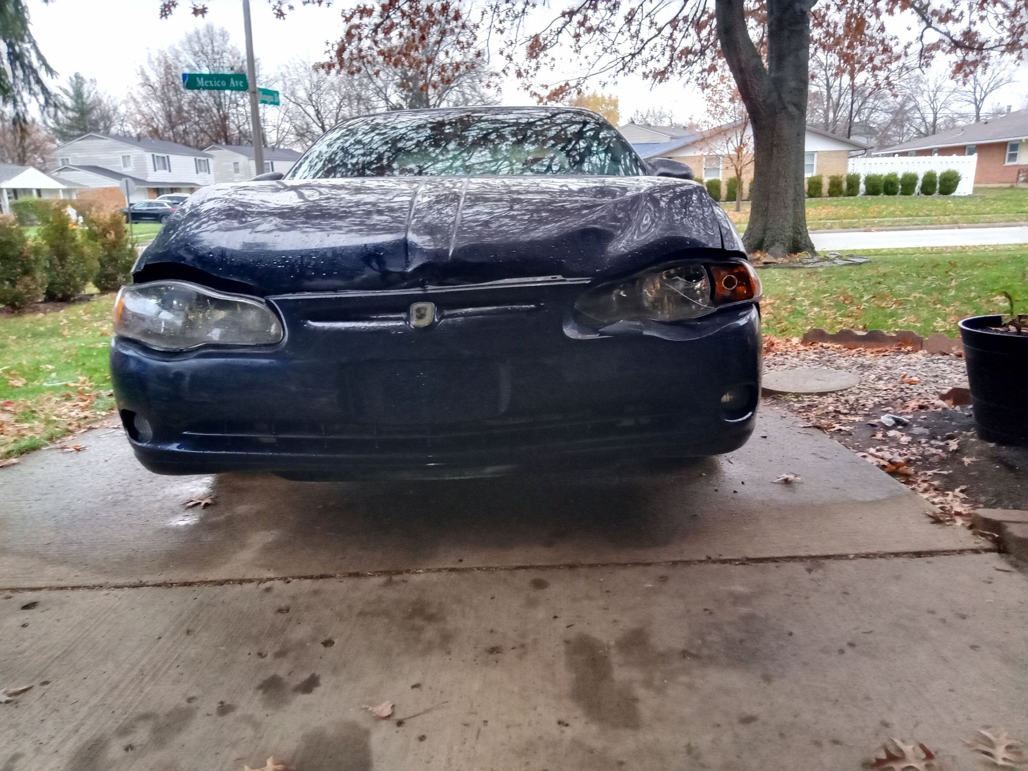

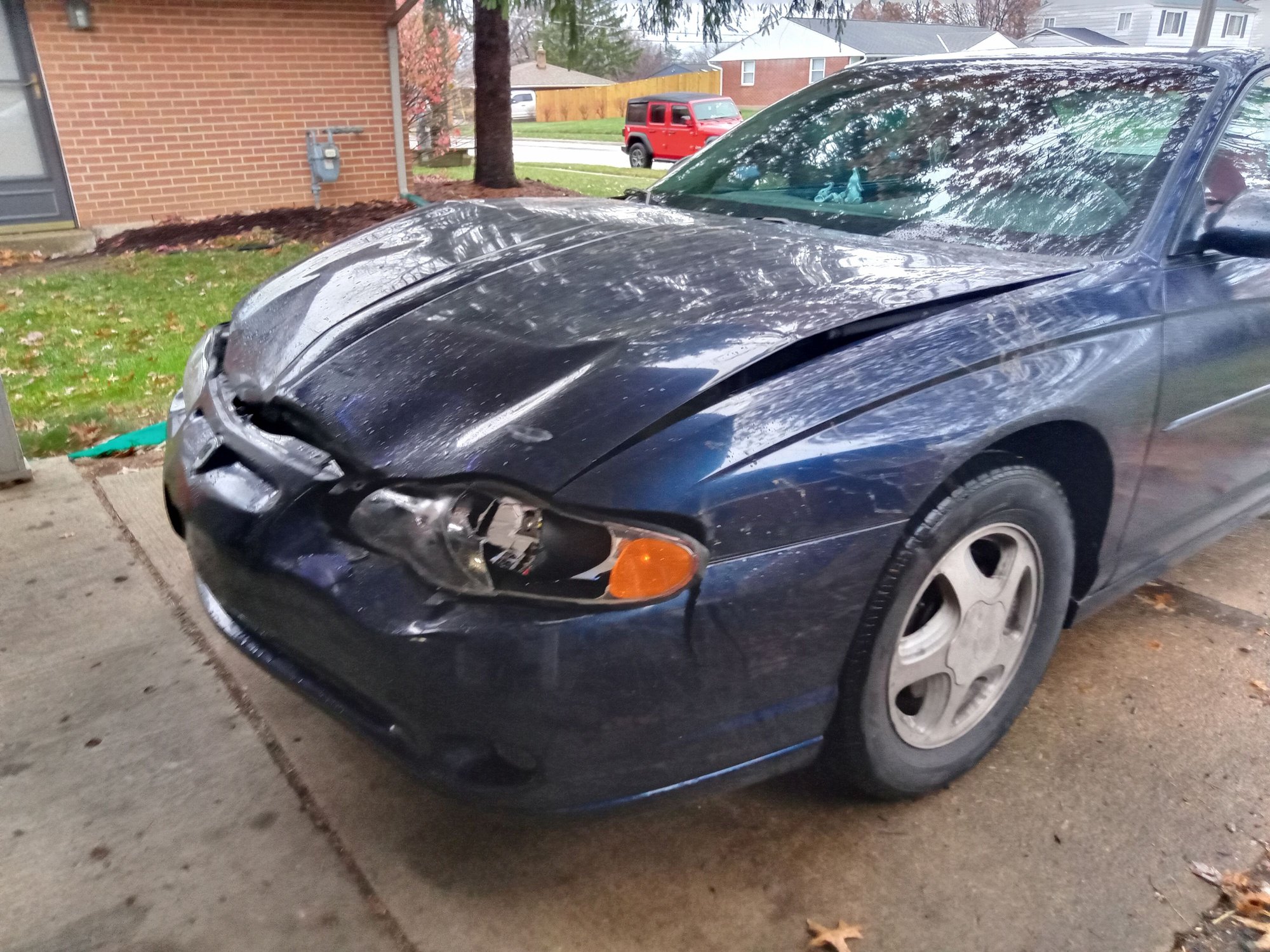

This is what happened the day before Thanksgiving due to this feeling... going around curves at any sort of speed feels as if my car wants to go both directions, so if I turn a bit to the left it feels like it wants to spin me around to the right. This took me into a guard rail after someone locked up their brakes so that air could cross the road on a hwy on ramp.
attached are before and after photos of midnight. Luckily only cosmetic and I was driving alone. Uninjured and whipped it around and drove it home...
After swapping headlights
Black eye and busted lip
Nothing major *phew*
Afted straightening everything out - here was the test fit Now its all realigned and tightened down... hood has two pins, a temporary braided cable hinge, and the factory heaight assys are being utilized again
