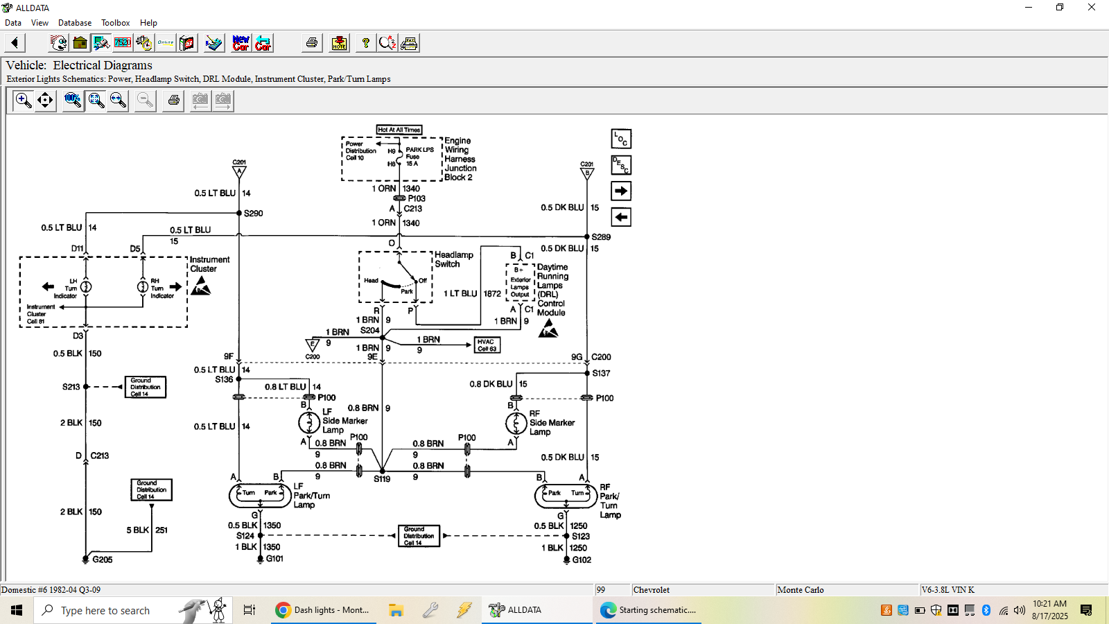

My initial thought is the wire that illuminates the radio buttons when the headlamps are on is actually being back fed from the replacement radio causing the taillight and dash lights to stay on. However you said when you remove the fuse (tail light fuse) it will go off, so that makes me think its something else. Attached is some lighting schematics for your vehicle for the headlamp switch and radio lighting in regards to when the parking lights/headlights are on at night.

Hey thanks for the help and wiring schematics. It's been on the back burner for a while. Kind of waiting for cooler temps. Here's a couple of things to think about! 1 the stereo/radio has been completely eliminated for now. 2 it has an aftermarket remote start system on it. Thinking about eliminating it for now. It's supposed to start cooling off in the next couple days. So hopefully I can get back after it. I will study the schematics, so I'll be up to start going back through everything. Thank you very much Bart S,

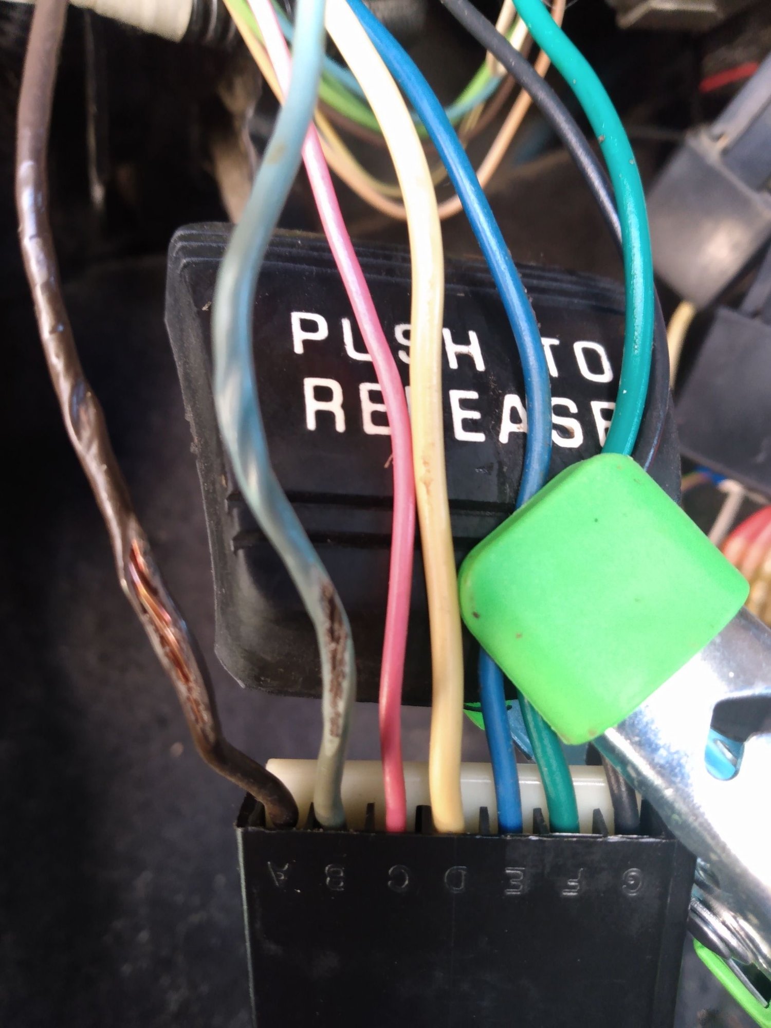

Thumbs up Short
Finally, after hours of tracing wiring and scratching my melon and chatting with experts on here I found the PROBLEM. According to everything I researched and through all my chats this is what happens when you put an aftermarket stereo system in this 1999 Monte Carlo Z34 with this style of light switch. Stereo pulls to much amperage and eventually shorts ignition switch and possible melting these 2 wires together. The attached picture explains everything. I would like to thank everyone that had a hand in helping me with this. You'll never know how much appreciation from your help wiring diagrams and inputs. Thank you everyone Bart S.
Old Aug 22, 2025 | 09:10 AM
02MonteSS_D.E.'s Avatar
Joined: Jun 2025
Posts: 77
From: Southern Virginia
WOW, yeah something was wired wrong that's for sure. Glad you found it before it caused a fire.
