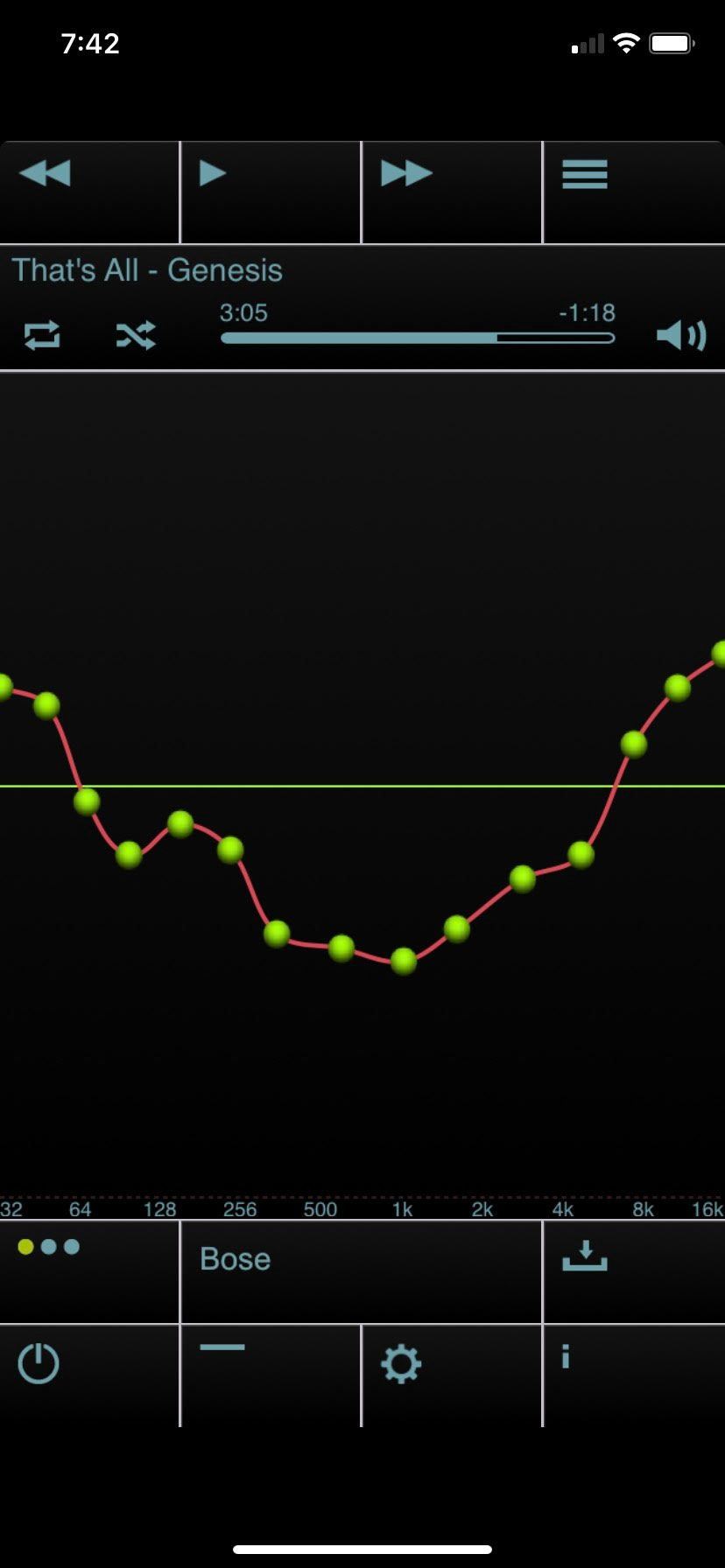

Maniac, I really appreciate that Monsoon amp install. That is in-fact what I am doing with this JL amp. Heres a new problem I have discovered. When you remove the factory radio, you loose a few options and I am not too keen on the idea. Seriously. I know some guys will hack a car up until its got whatever but I am not one of those guys anymore. I like non molested nice vehicles that have extremely clean modifications and time taken to get connections looking good with a factory look install or better. I have a fix for your sound without adding a DSP in between the radio and amp. It does not work as good as a DSP because it does not have time alignment or a crossover for each speaker BUT it does work well!
I am a big audiophile, so I use an app for all my music to correct the recordings. I stream all my music through this app and I can customize the EQ settings for all my vehicles and believe me, it even makes a high dollar factory car radio sound 10x better! Aftermarket set ups its like a HUGE improvement. This is what I recommend to get your midrange frequencies under control. Here are some pics of the app called EQu. I use an iphone.
You can literally taylor the audio to your specific system and it will automatically populate all your playlists from itunes or whatever you have stored on your phone. You can even volume boost the radio by sliding the entire eq spectrum up for a screaming loud output. I have had this app get me many of compliments, even when I used it in my 2013 Silverado factory junk system. I had people ask me what speakers I was using. I have a 22 RST Z71 now with the factory BOSE system and its magical with this app. I will not have to install any speakers in that truck, just a little 8 or 10" sub maybe... but it doesnt really need it to be honest.

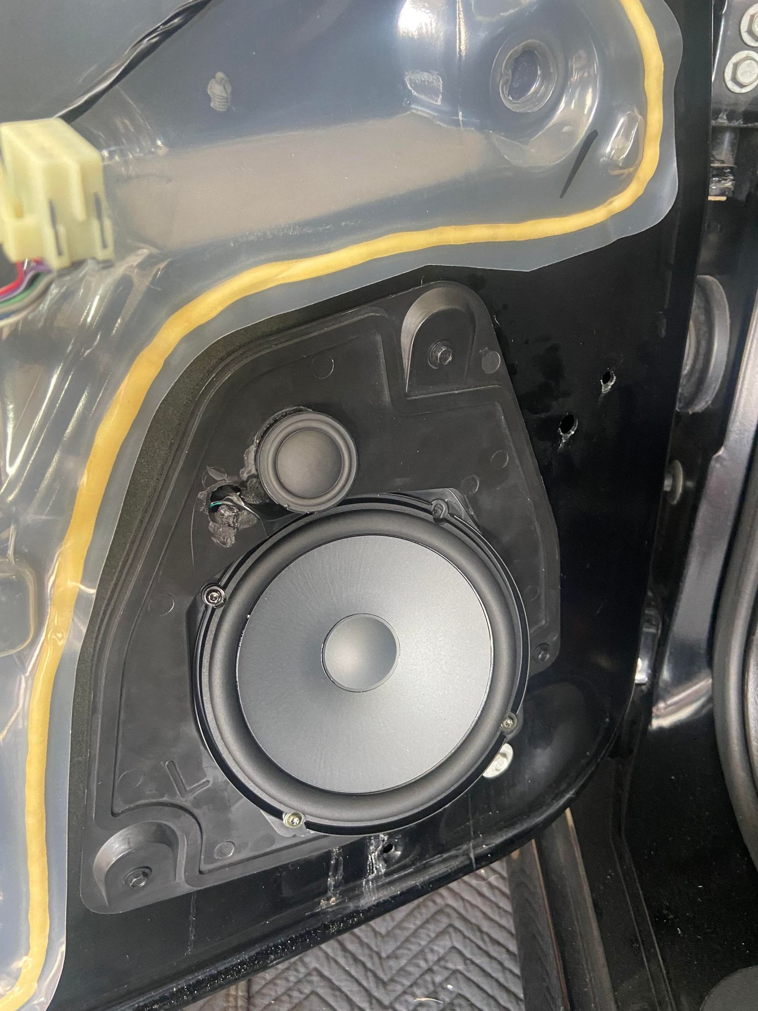

I got the Audiofrog G60S's installed using the factory speaker mounting plate. They dont even begin to sound as good as they do with a real amp and head unit. (Expected) - Lots of work to do on this system!
