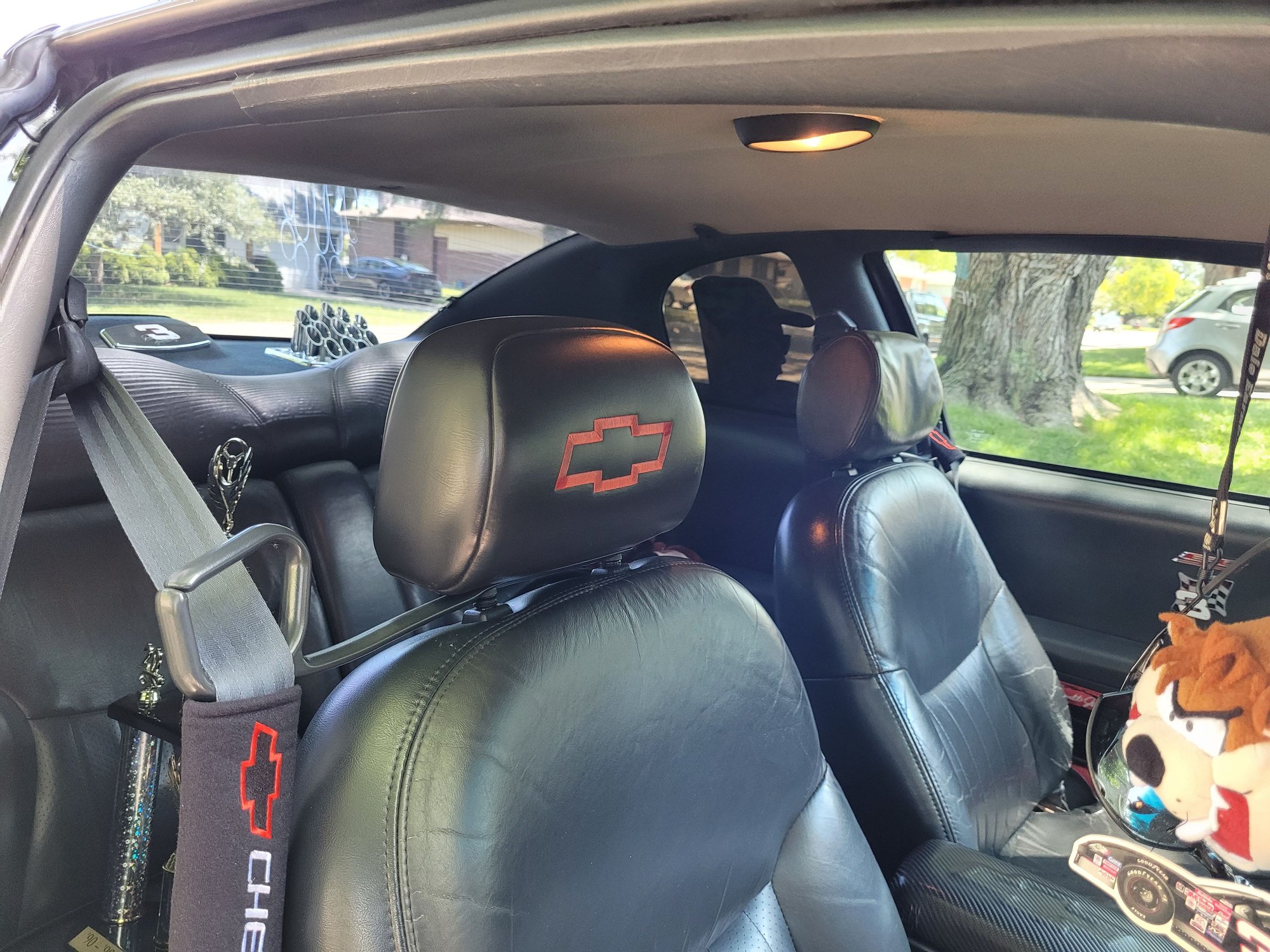

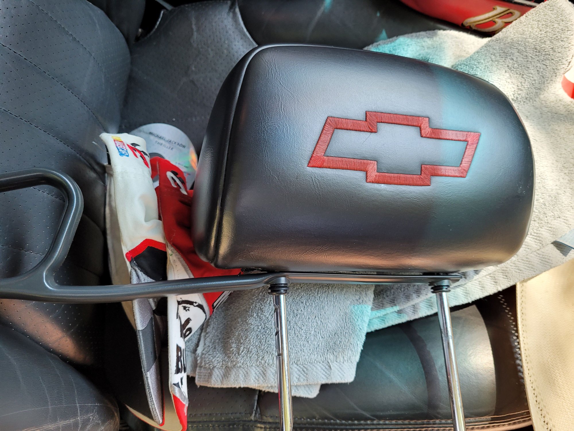

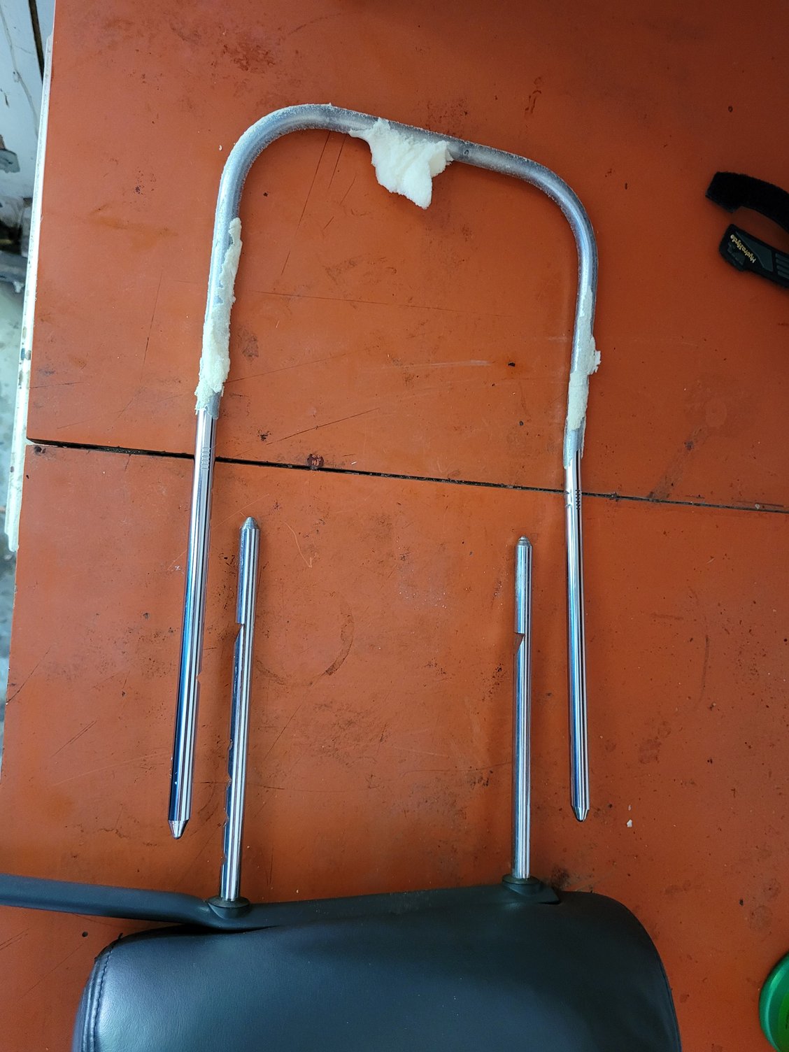

Something new to add to this is some Bowtie headrests that came from a 6th Gen MC and I converted them to fit in my 5th Gen. Found them in a MC at the U-Pull it how lucky that find was. The biggest Challenge is to convert the head rest rods to fit the 5th Gen. about an inch smaller in placement width.
So I opened the headrest at the bottom and cut thru the inside foam and then inserted the smaller rods from my head rests and filled it with window seal foam, then I used shrink film to hold it together until it set up. Turned out really good.
