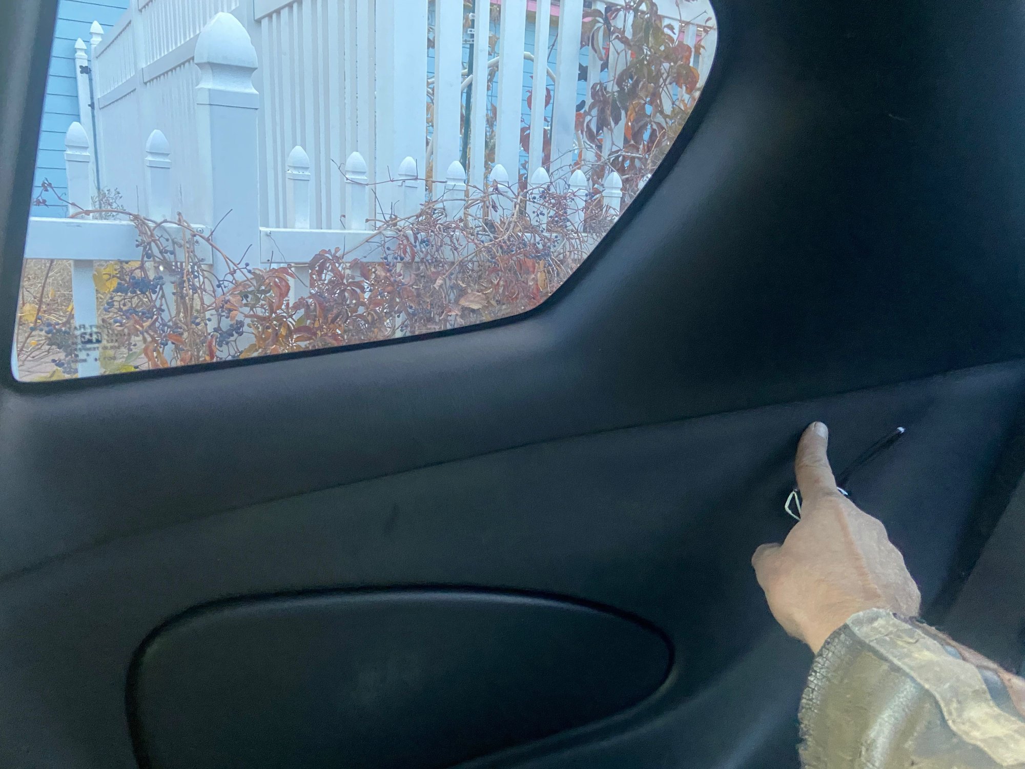

Fix I found for the difficult problem I noticed on my 2007 Chevy Monte Carlo, concerning the rear plastic interior side panels & arm rests.
Problem:
Where the top window trim panel's bottom edge meets and connects to the bottom arm rest panel, there was a distinct gap as it progressed wider towards the trunk, you could put your finger through in it. (see pic pointing at seam gap problem area).
This is because the arm rest is totally unsupported directly underneath, allowing the panel to sag.

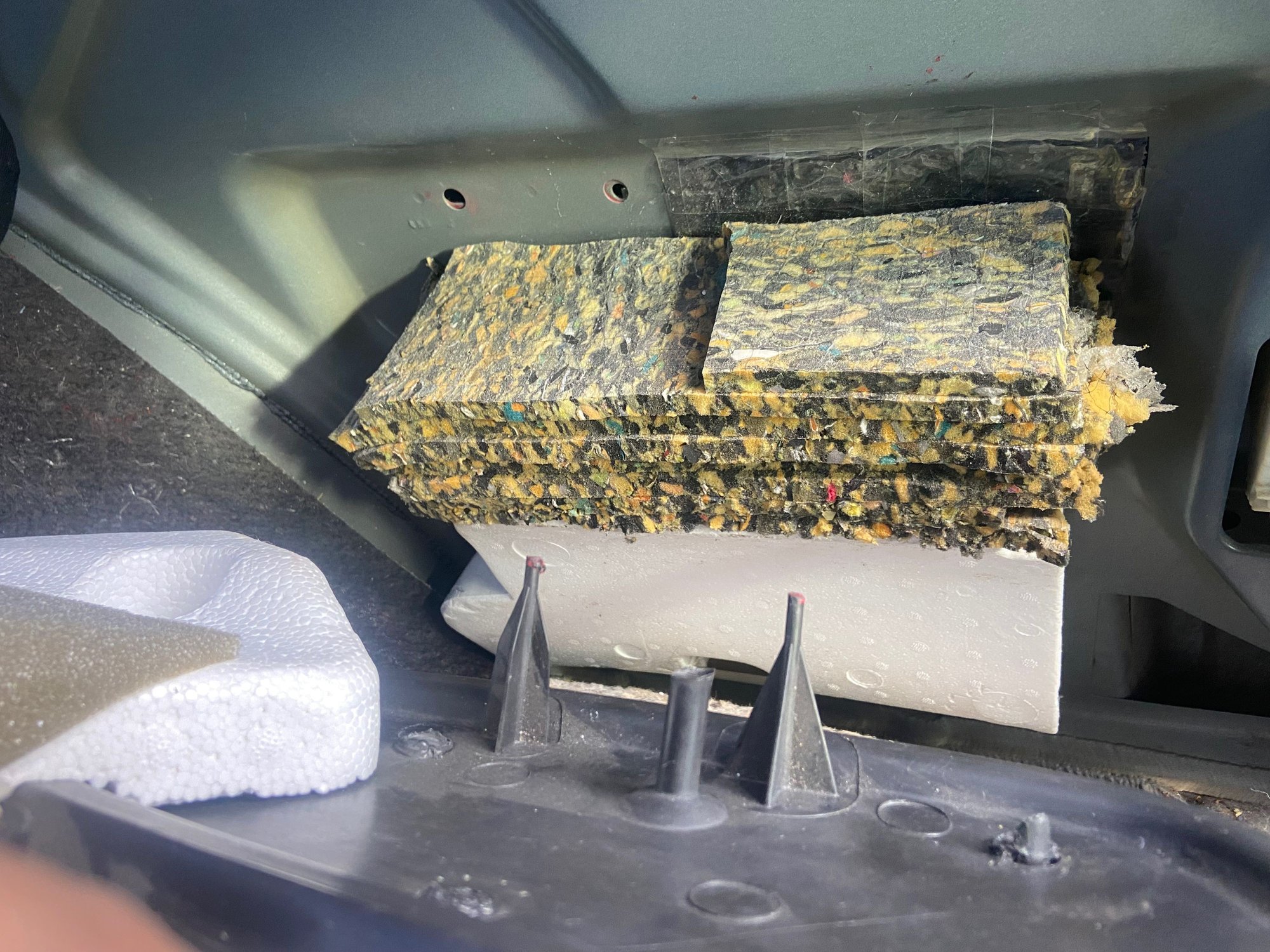

See the solidly affixed styrofoam block under the arm rest area.
Inspect the arm rest for any cracks in the plastic from people's elbows. If there are any, from the underside, carefully flex open the crack and apply super glue and close the gap.
Then wet the crack seam with super glue and sprinkle it with baking soda. If the arm rest is quite broken from heavy elbows, you may need a salvage yard replacement or add fiberglass & resin to its back side to reinforce/repair it.
Install carpet padding on top of the styrofoam block:
There is an appropriate 3.5" gap between the top of the block and the bottom of the arm rest panel. So there is no support for the armrest from the block.
Adding carpet padding layers will change this and their spring action will allow for variations in the gap closing.
So cut carpet padding strips approx. 12" long and 3.5" wide expanding to 4.5" wide.
If using 1/2" padding, you will need 7 strips for each arm rest. Additionally you will need a 4" long final topper strip to place towards the front of the arm rest area.
Dry fit the padding strips width to make sure they generally do not protrude past the long lip edge of the styrofoam. (see pic).
Use spray adhesive to attach them to the top of the styrofoam block, one strip glued on top of the other.
Now dry fit the arm rest panel placed over the foam.
Press down on the arm rest and feel the much needed support it is getting from the pads.
Look inside the panel and you should see the clip towers approx. aligning to their sheet metal holes.
Ideally the panel should sit just slightly higher than the holes when not pushing on the arm rest.
If the panel sits low or too high, add or subtract a foam strip.
Also cut a 12" x 1.5" wide foam strip or two and glue to the bottom-underside of the panel molded bend area where it touches the floor, to help it the panel sit up higher.
This all will keep the panel from ever sagging again and showing a gap at its seam with the top panel.

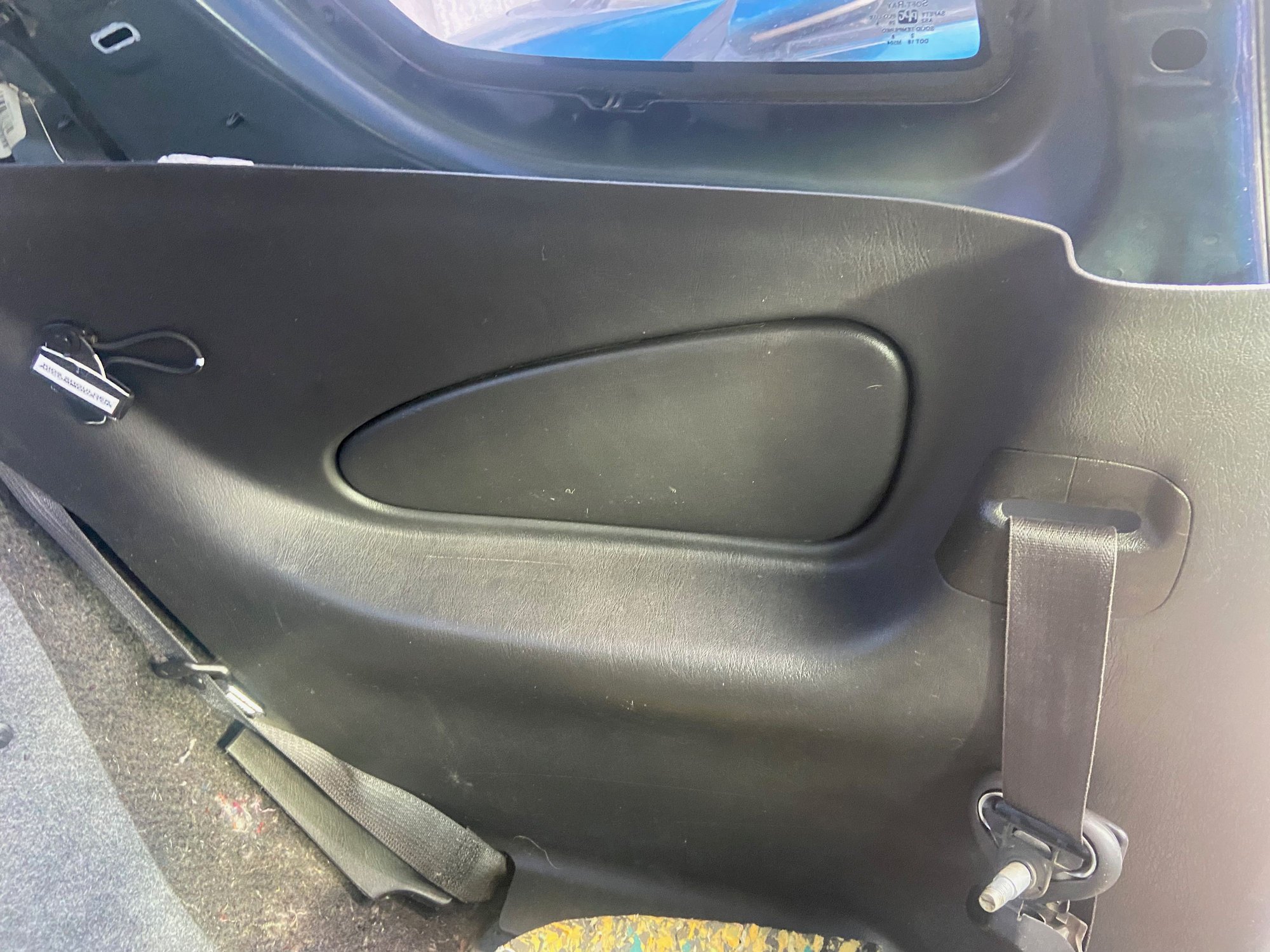

Now reassembly the panels and the seat in reverse order, starting with the arm rest panel.
Note the panel's clips positions and make sure they go in their sheet metal holes, pushing on the panel in those areas.
The top panel is a bit tricky, take your time. Make sure none of the window fingers are on the outside of the panel, the panel goes over the fingers.
