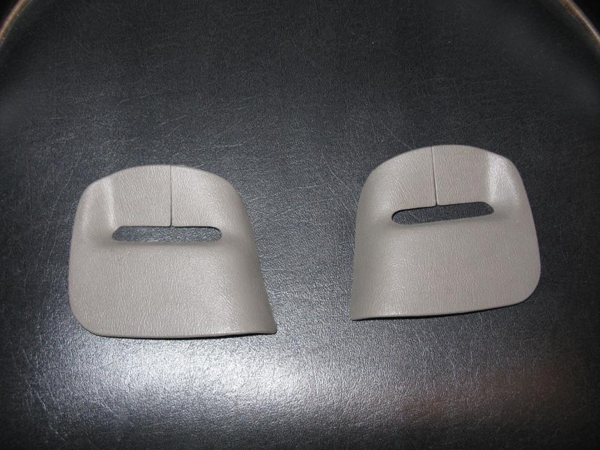

On a recent trip to the junk yard, I found a 6th gen Monte (been picked over and stuff people didn't take was damaged). Well, it had the pewter/gray interior. I noticed two/4 pieces, not sure how well they will work, but I picked them up and figured, once I get the Monte back with it's new 7th gen spoiler, I can put these pieces in and see.
They are the pieces for the seat belts. One set is where the seat belt come up out of the rear trim, the other piece covers the metal bracket bolted to the car.

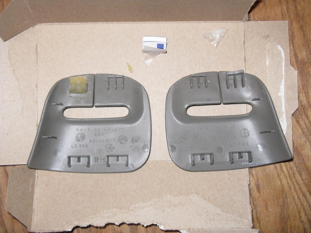

I oopsied and damaged the one bezel during removal at the junk yard. Luckily, only one tab broke. I don't think it will be overly critical. But, I am trying to re-form one with two part plastic epoxy (that stuff gets REAL hard). I first lightly scuffed the fins left from the tab (in hopes to improve adhesion). I made a small form by cutting up a cereal box, using Scotch Tape with the sticky side out, wrapped tightly, that's how it's held to the bezel. I mixed the two part epoxy and gooped it on. Tomorrow once it's properly cured, I can inspect for how well this idea will work.

Great news! I checked my little repair job this morning and it looks GOOD! Used a razor blade to cut the Scotch tape and pull the cardboard form out (and I was able to pull the Scotch tape easily off the glued surface, something I hoped would happen, but NOT a requirement).
I wiggled the new epoxy tab and that sucker is like a ROCK! It's probably STRONGER then the original tab!! I took a grinding wheel on the Dremel and trimmed it a small bit. I think this will work PERFECTLY!
