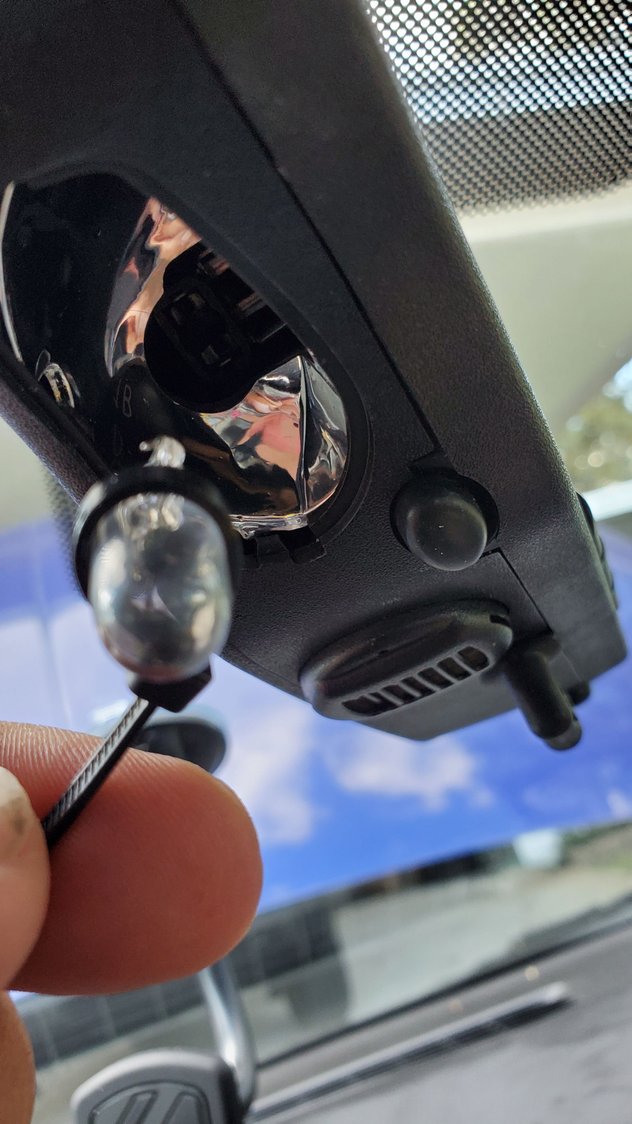

Howdy! I was spending the better part of 2 hours trying to replace the map light bulbs on my '05 Monte Carlo! After some trial and error, I found that using zipties was a really easy way to remove them without using a dedicated tool or some sketchy pliers. I hope this technique helps someone else! (This is my first post on here, be easy on me!)
Push the ziptie back so that its hugging the bulb near the base
Tighten it with a finger as well as you can and then wiggle it back and forth, pulling away from the bulb base. It should eventually come out, granted you give it some elbow grease!
Success!
Replaced with some 194 LEDs. Very nice!

Slik idea thanks for sharing that , this is a really old thread back in 2010 you might want to show this and start a new thread.
