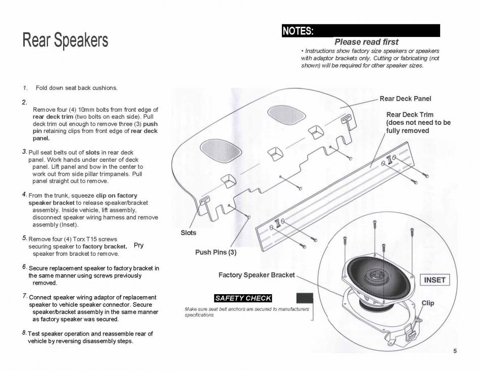

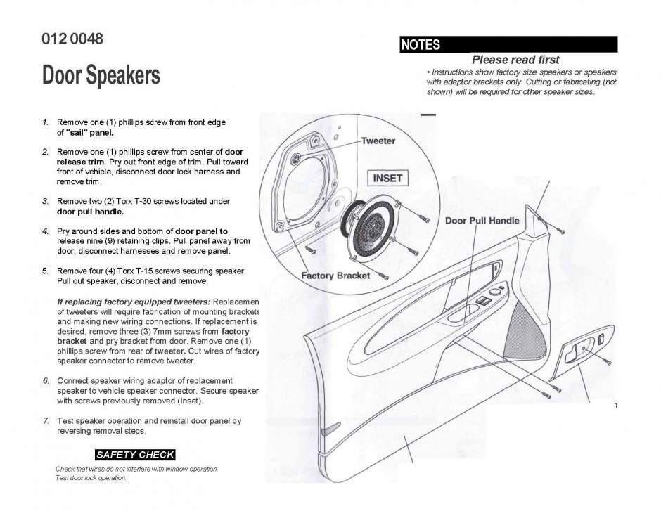

Here are some pics on how to install a HU/Speakers on a 6th Gen MC.
Head Unit/Speaker Install 6th Gen!-door-speakers.jpg
Head Unit/Speaker Install 6th Gen!-factory-radio-removal.jpg
Head Unit/Speaker Install 6th Gen!-rear-speakers.jpg

That's correct. I've read a few people here ask about how to remove door panels and other radio related things and, since I finally found these pages in my vault, decided to post them for them.
