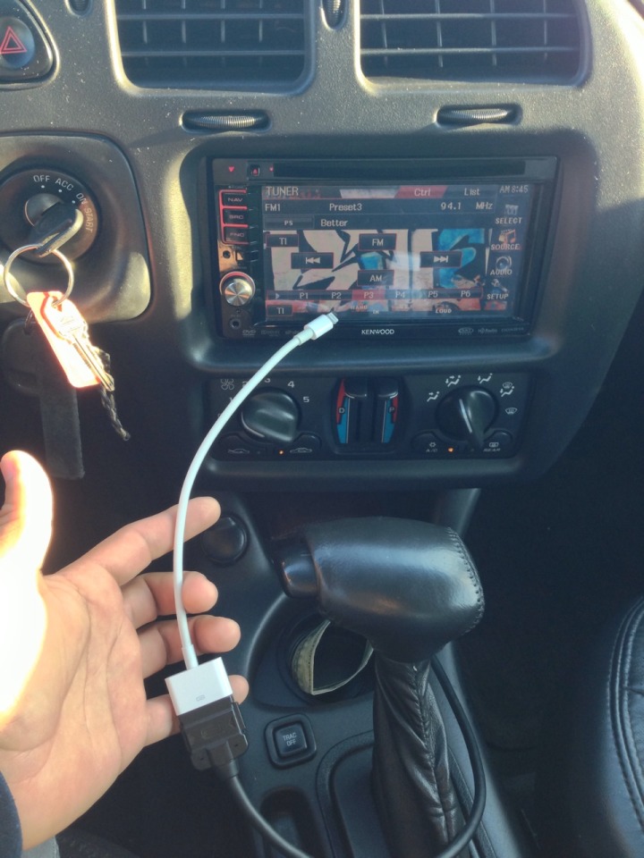

I have an 03 with a Kenwood DDX514, I don't remember my harness being more than $50 lol and I have onstar as well (not that it works though haha) IIRC my harness/interface thing was only $45ish at Walmart... Made by scosche
I Love my DoubleDin, I mostly listen to pandora through my iPhone 5
