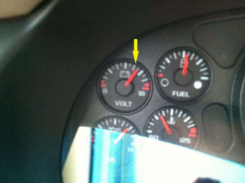

I replaced my alternator and I still notice that on a longer drive (45 minutes) the volt meter climbs a bit. When I sit a light (with car in drive and foot on the brake) it seems to go down after a while.
I tried a friends OBDII reader on the car but it did not have any voltage data to display so I am not sure what the exact voltage creeps up to while I am driving.
The yellow arrow below shows where it runs normally after the new alternator was installed. The gauge is shown where it creeps up to after driving.
My dad works at a garage and someone suggested that the meter runs off a bi-metal strip that could be worn/wearing out.
Thoughts?

My car does the samething, when i drive the volts will go up and when the car sits and idles, the voltage will drop, thats normal because it will never just stay at one steady voltage but move and I also have a stinger volt meter that shows more clearly the voltage. You have nothing to worry about only when it drops or increases dramatically you will have a problem. That is if it stays at that low or high voltage.

As long as it stays between 12.3 and 14.8 you are good.
I run a scangauge2 as well as that gauge to monitor everything.
