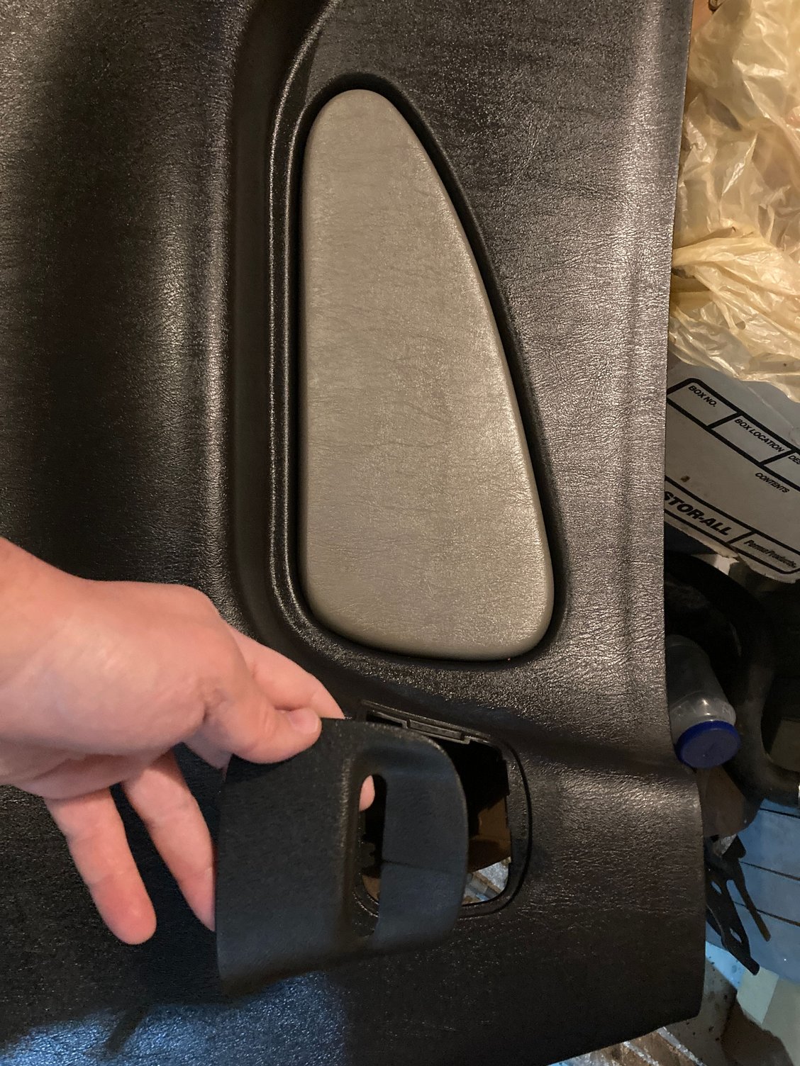

Some small updates. A few nights ago, I finally spent some time cleaning these panels up. A little more work than I expected. I removed the seat belt holders and the guide trim. First, I wiped them down (front and back) with Lysol wipes. Who knows what these were previously subjected to. I later went over it with a scrub brush and soapy water (dish soap). And I am well aware, this treatment can dry the plastic and possibly cause issues.
After this, things were looking pretty good, except, the one gray pad had some marks that were not coming out well (possible scuffs/scratches, maybe just junk in the grain of the material). I tried an experiment. I grabbed a brand new horse hair brush/wheel for my Dremel. Using low speed and LIGHT contact (so not to burn the material) buzzed over the area. At this point, I could not see the marks. I wiped everything with a towel to dry anything that was still damp.
I grabbed some cleaning rags, the Megiuar's Superior Shine interior treatment. I also used a little Mother's Back to Black treatment in a couple areas. A couple good wipe downs and I feel these look as good as new.
I have the panels in the basement instead of the garage. They are less likely to have any issues from other things I am doing in the garage. I hope spring to put them in my blue Monte.
Below are some pics. You see my holding the one seat belt trim. Currently on my blue Monte, I have a gray piece in that spot (part of making use of gray pieces to two-tone the car). I am debating if I still want to use the gray or go with black. Part of me says use black with these panels (as the gray would now be a bit out of place).

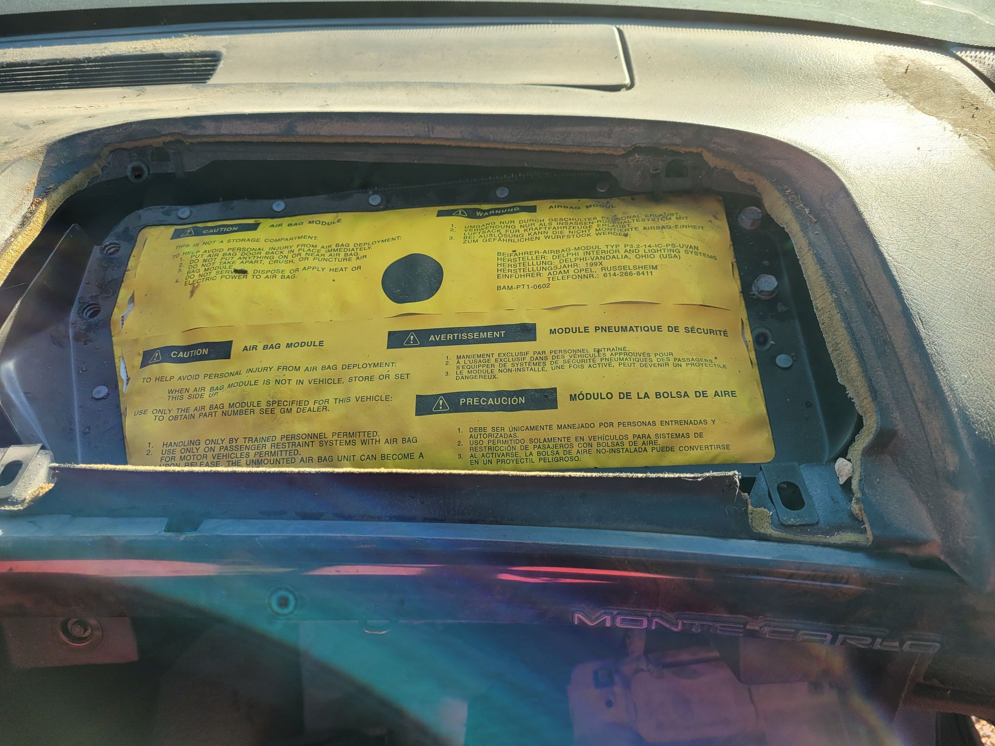

The best way to learn how to make a repair is to find the part at the salvage yard.
Here is one I found a few years ago.
air bag
front
Old Dec 26, 2021 | 01:04 PM
LOL! That is a very true statement! A few times when I was not comfortable with something, I found a car in the junk yard to test with.
