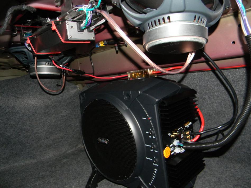

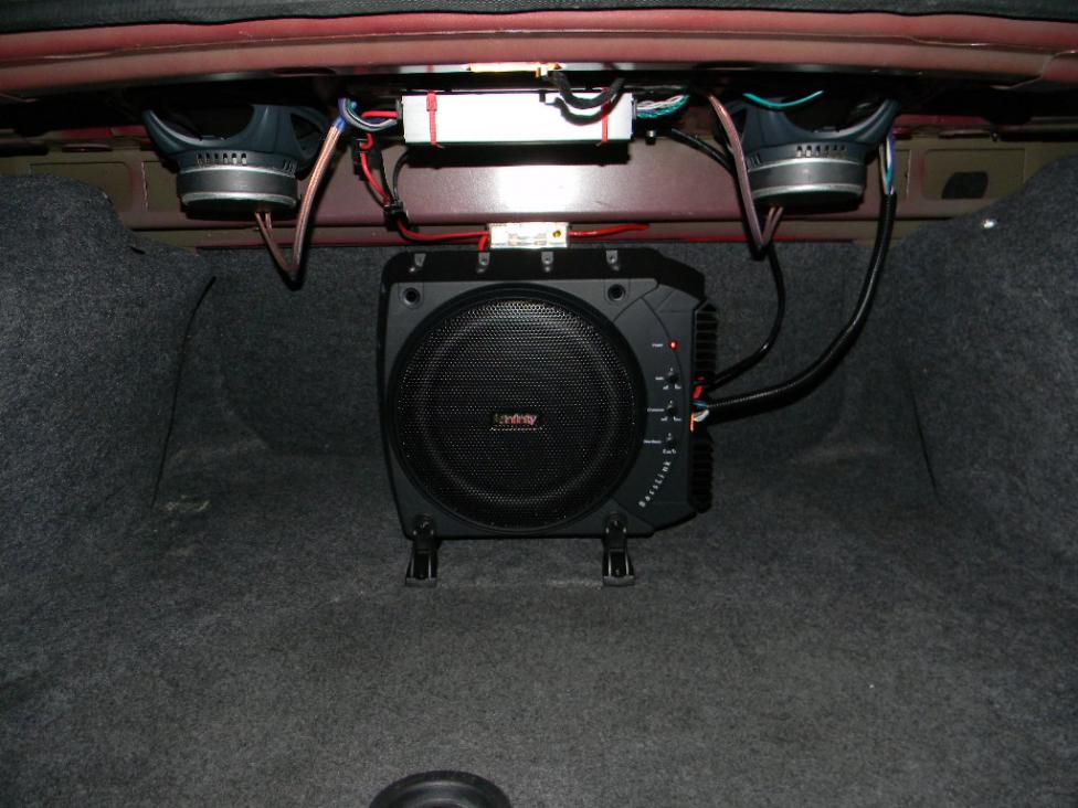

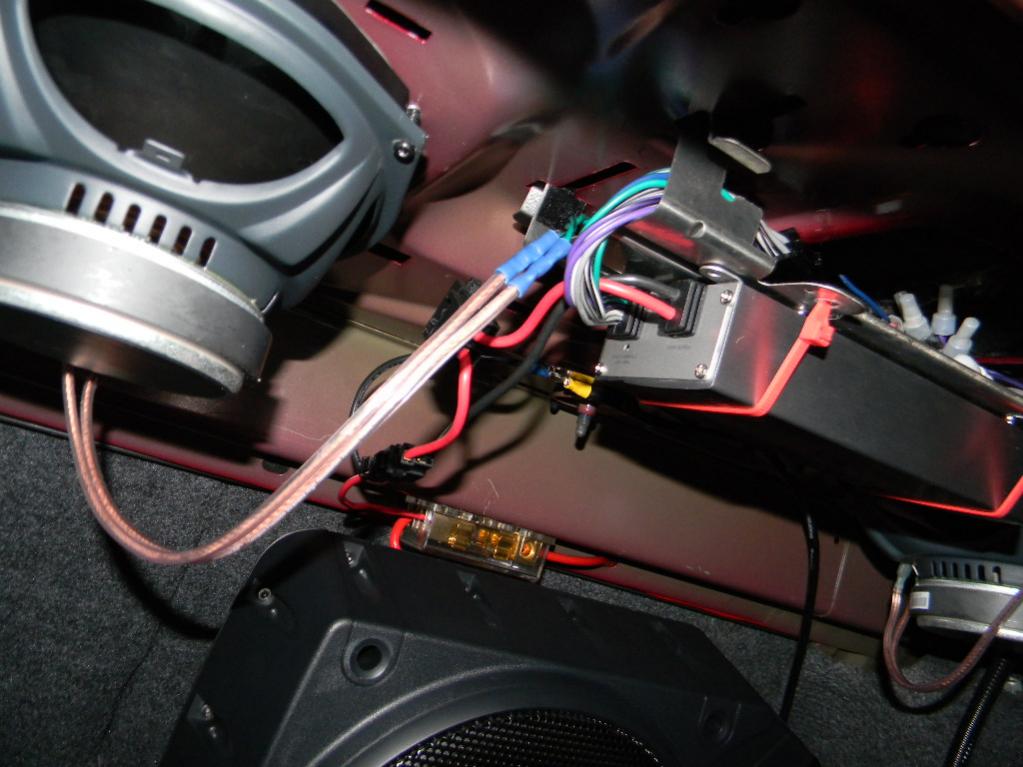

Here are a few pics of the trunk, which is really the only way to tell that anything has been done. The interior and under hood look completely stock, even though I ran a power wire all the way to the battery. I still need to tidy up some of the trunk wires, but what you see is what you get. I simply zip-tied the Clarion amp to the factory amp bracket and tucked most of the wiring up above it.
I will post a wiring diagram shortly. Basically, you'll need to tap into the factory input wires at the amp in the trunk, sending front & rear signals to both the Clarion amp and the Infinity sub amp. The Clarion and Infinity amp input wires are the same colors, making the installation almost foolproof. You can also tap into the factory speaker wire outputs to the door speakers, keeping it simple.
After listening to the system for a while, I am quite pleased with the overall setup. I have the BassLink adjusted very conservatively and it still hits so low, you can't deny it's there
