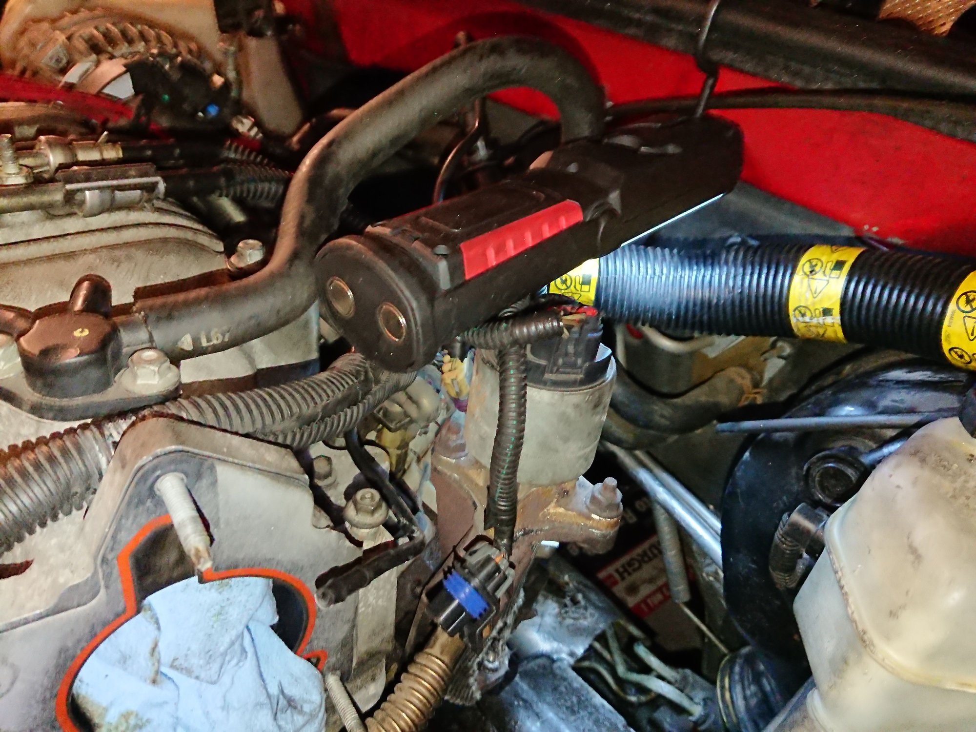

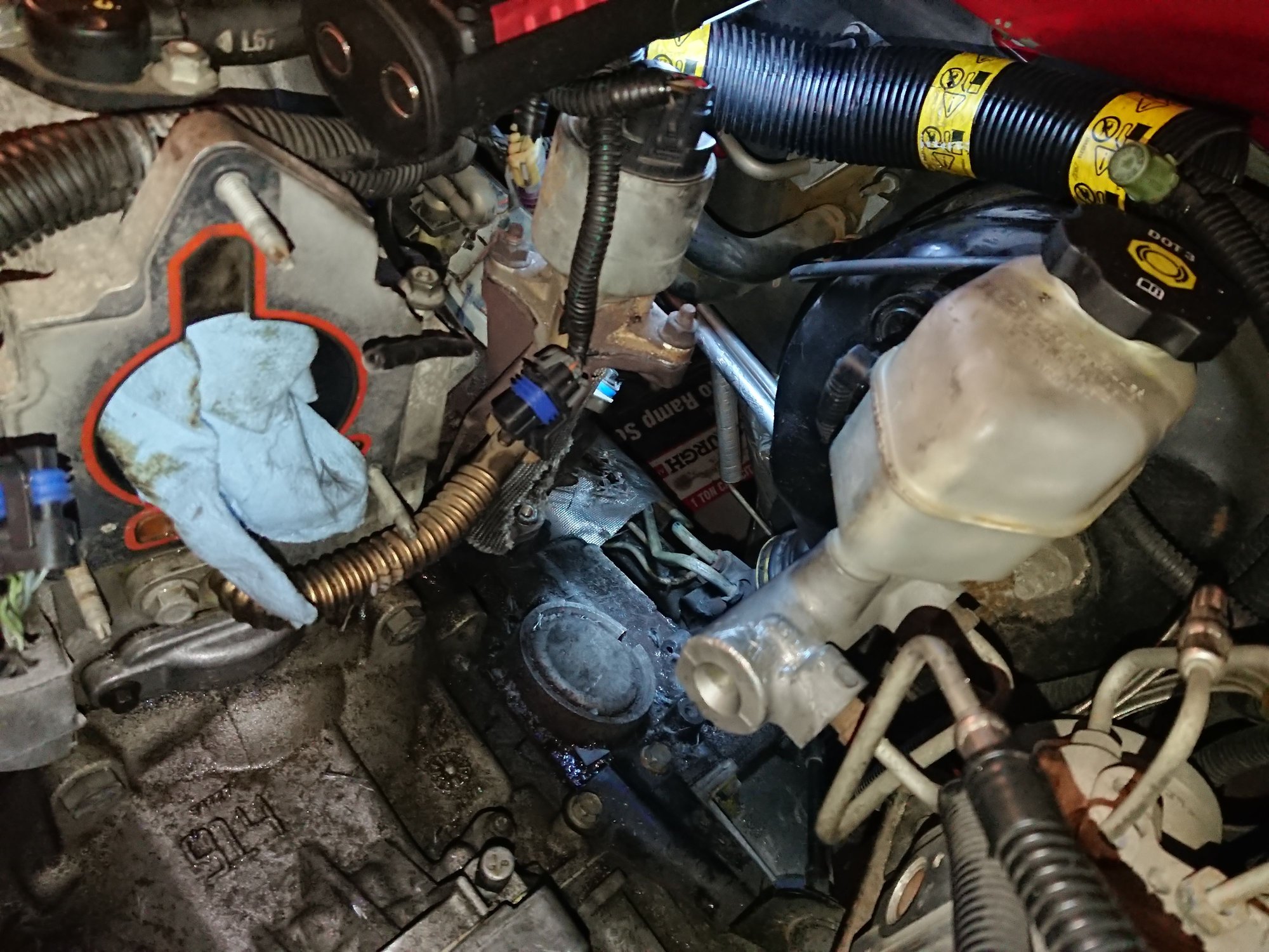

I guess I'm still having issues getting that darned thing in. There isn't a lot of room and those two metal bars are stopping it basically. I've unbolted as much as I can to make more room but no luck. Looking for some suggestions or point outs to something I may be missing. I have been holding the engine towards the front of the car for a few more inches.

Are you in a state where you need that EGR system? If not, take that off and block it. I did and im actually pretty happy i did. If so, id say remove it and put it back on after you get the header in..
Even after I had the egr removed I spent a good two hours trying to jimmy that rear header in.. It finally decided it would go in with no problem..
Ill think if theres anything else I can think of but ive seen a few times that you should be able to get it in there without removing the egr..
Are you sure you have the engine as far forward as you can get it?? I used a car jack between the engine and firewall to push it forward. As said above, the only thing you need to worry about it ripping the engine out of the mounts.
Jeeze lol, I wish I could come help so bad XD I know what a pain it was for me..

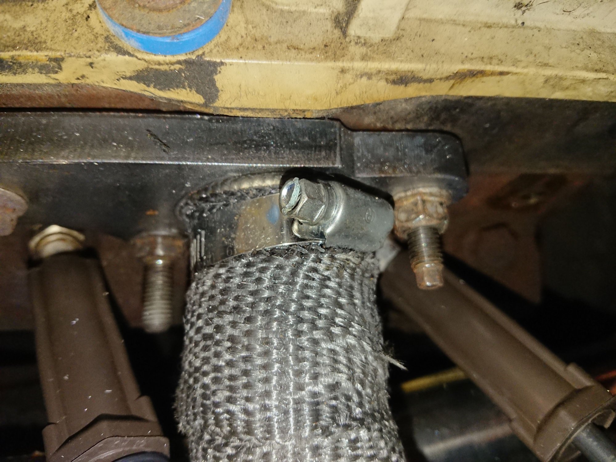

When I had started it for the first time, it seemed as if it wasn't running smoothly. After about a minute I could see exhaust smoke coming out of the headers. I'm positive they are both on tight. It looked as if the revs were going up and down but not too bad. It was definitely louder than I thought. Thoughts? I also noticed I have an extra space on the front header. I'm sure I got the front one on correctly. Pic included. Engine got hot pretty quickly.
I did change wires and plugs, made sure I didn't mix up the wires. Labeled them. I wonder if it's the plugs, maybe I forgot to gap it out of the box.

The headers smoke like hell after the first start up.. I think its some protective coating or something.. Scared the hell outta me at first..
It should be a little louder in the engine bay but what youre describing sounds like a leak.. I would suspect the gaskets they provide.. They seem too soft and thick but mine did work.. I was worried about that myself..
Theres a specific way to tighten these.. Tighten the two outer nuts/bolts, then work your way in.. Dont tighten them all the way on the first pass. Get them snug then go back to the outer bolts and work your way in again..
I did that and a couple days later had to do it again, then a month later, again.. Its starting whistle now so that means I gotta tighten them again..
I see if I can think of anything else.. Id start with loosening them and re-tighten them.. Look up the exact procedure because I could be off a little..
