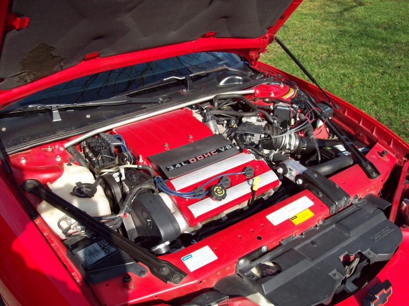

On the 5th gen, you also have to deal with the top plates on the struts.
But, those plates could lend themselves to a little custom fabrication and get what was done here:
