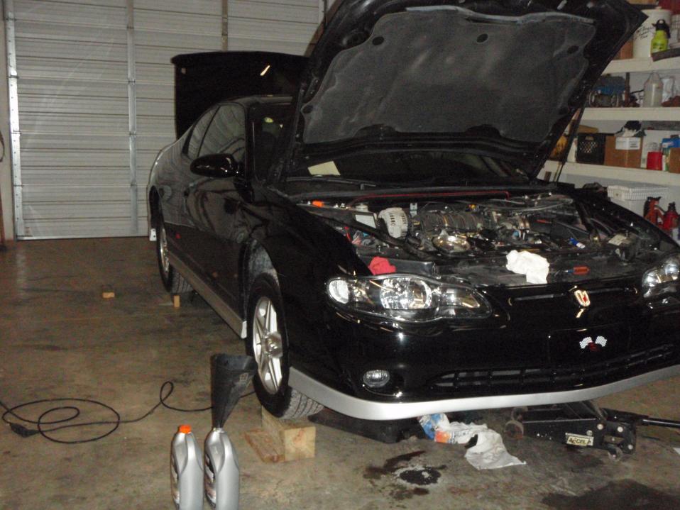

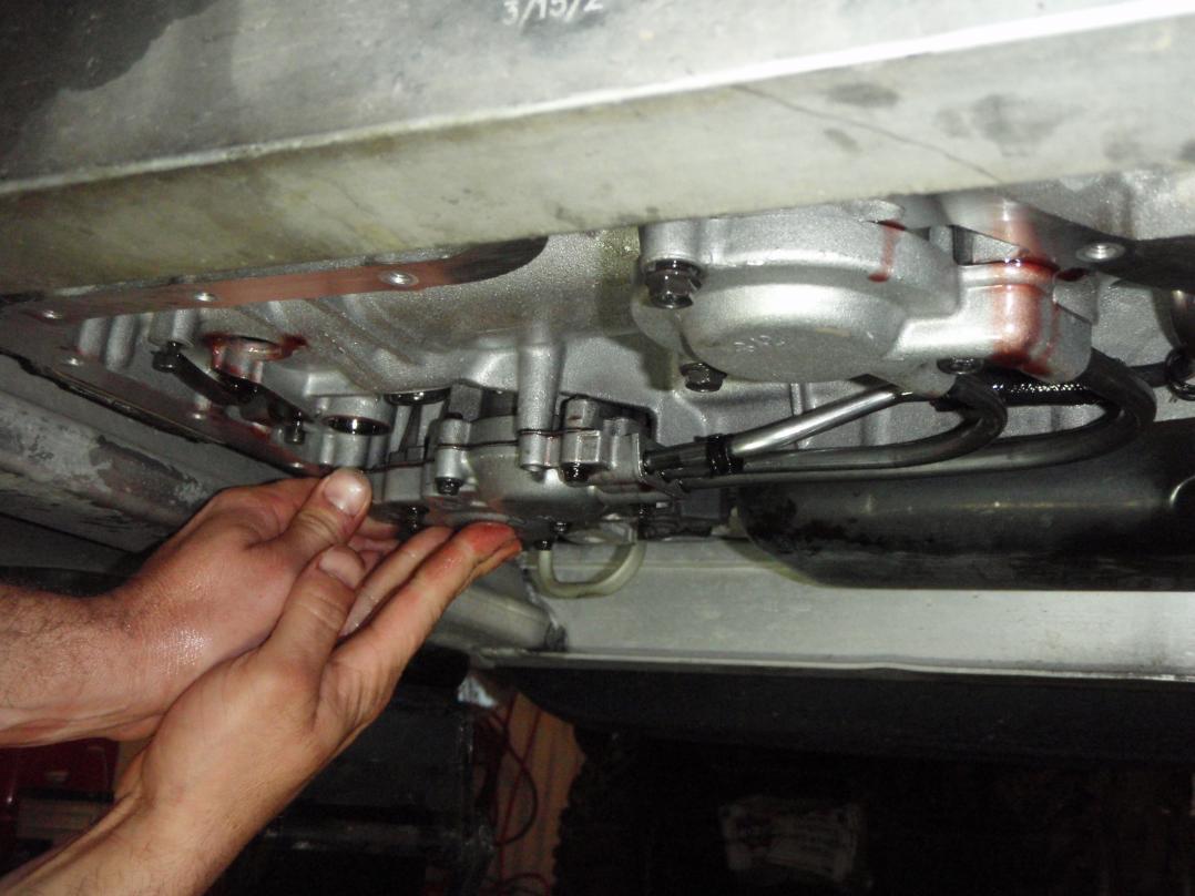

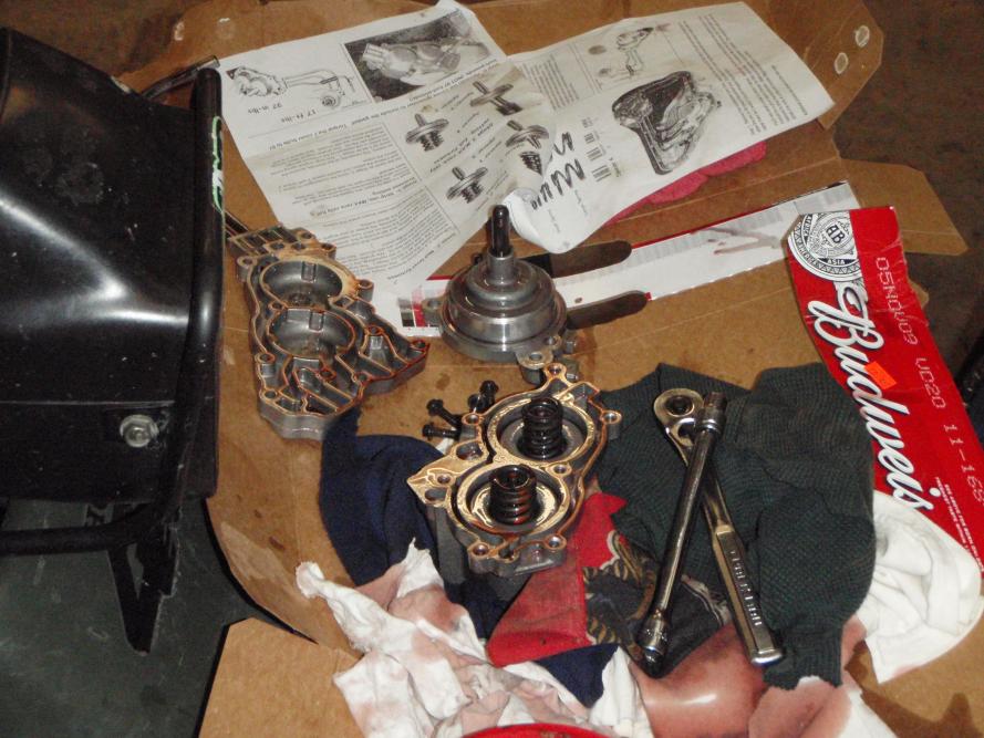

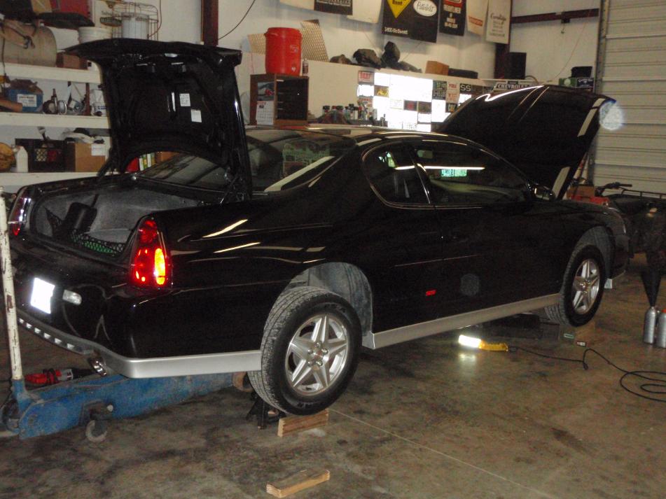

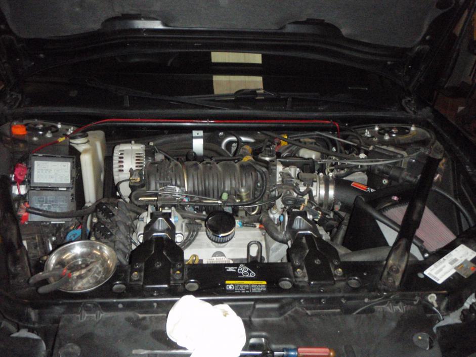

Hey guys,
Here are some pics of this past weekends shift kit install. I also changed out the dexcool antifreeze, the upper motor mounts with all new poly bushings, and put in dextron VI trans fluid. ( that was more expensive than I thought.)
The motor mount bushings make it "feel" stiffer with a little steering wheel vibration in park, and a little shake when you crank it. Nothing bad, just different. The shift kit makes a noticeable difference in (appropriately) how it shifts. It seems to hold gears longer under normal throttle conditions and the feel under throttle is nice, without jerking the dash off either way.
I say this project is a success. I'm happy with it anyway.
IBEWBrother
Attached Thumbnails Shift kit install pics-p1170044.jpg   Shift kit install pics-p1170045.jpg   Shift kit install pics-p1170046.jpg   Shift kit install pics-p1170049.jpg   Shift kit install pics-p1170056.jpg

OK,
It's a Thasher kit, I went medium firmness, and was really easy to do. I can't really give you a time, because we weren't in any hurry anyway. It takes most of an hour to pick mine up at my buddy's shop.
So far the feel is nice. I also changed out all the upper motor mount bushings which makes the whole thing feel stiffer. The shift kit seems to hold the gears a little longer than stock, with a nice pull when it shifts. Hardly noticeable easy, normal driving....a little more pronounced under throttle. But not even close to dashboard jarring in either case.
Thus far I'm happy with the addition.
Cheers,
IBEWBro
